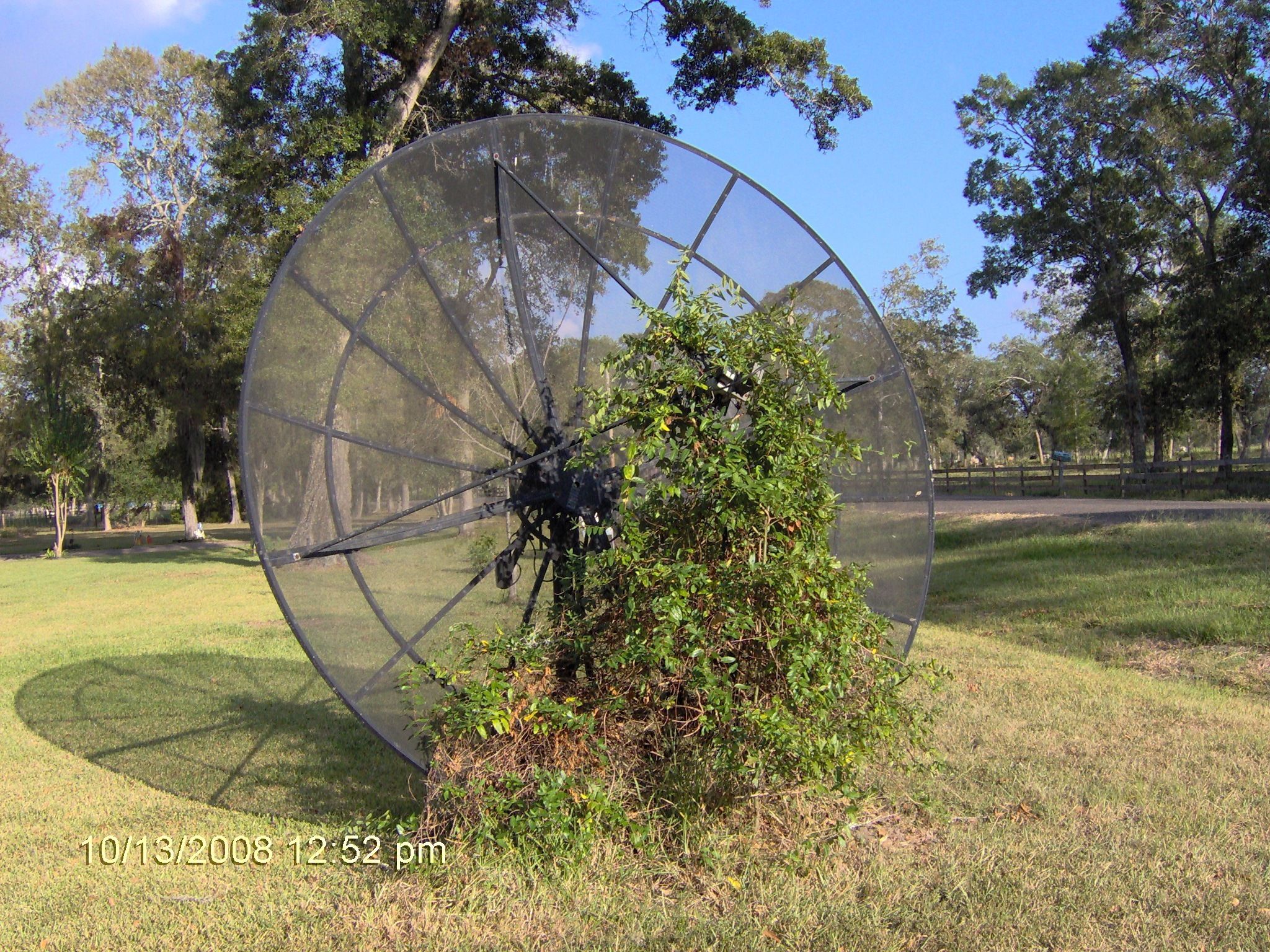

Well, I got it home after dark that night, took the pictures the next morning. I gotta say, that dish has more growing on it than any dish I have seen in the forums so far. I got it torn down last night, it came apart fairly easy, nice design. Broke two of the rods at the threads, drilled and retapped them this morning, so no big deal. Last night during the teardown, I moved the dish so I could reach the rods, the motor turned enough move the dish about 1/4 the way. Tried the motor on the bench this morning, no go. Upon checking the transmission and bushings I found the brushes and commutator pretty worn, probably why they stopped using it. I think I have another motor from a broken 24" mover, will try it later. I think it has the mod for the counter, there is a pot with a gear on the worm shaft and it has the same end as the magnet sensor on the opposite end of the shaft. It has a dual Chapperell feedhorn, the LNBs are some offbrand, 'Super Ice', Googled them, nothing good said about them, so I will use the new ones off the Raydx. I saw a thread about using a 5gal bucket for the feedhorn cover, got plenty of those. That's as far as I got this morning before work.

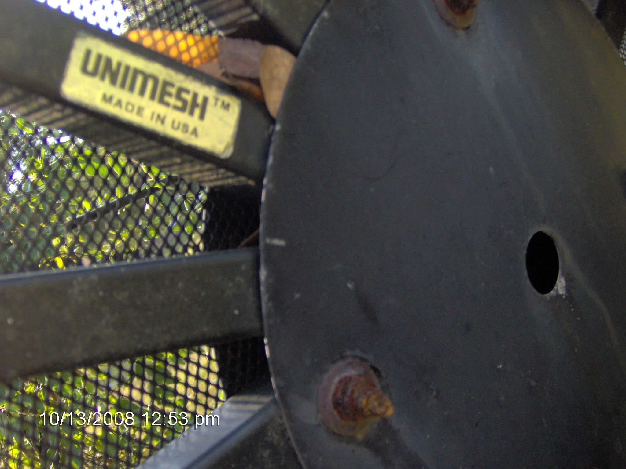

Here is two pictures of the unimesh dish that has that lnb. If I were to replace the c-band lnb with a c/ku combo would I be able to pick up ku-band. Are the holes in the mesh small enough? I would usually try to estimate the size of the dish by using the feedhorn as a reference but I can not since it is cover by foliage. Any idea how large it is?

My guess would be a 10' dish , but Unimesh also made a 12' dish? I have a 10' Unimesh and I get good Ku signals with it. But, that being said, I get better Quality on smaller ku dishes that I have (between 80cm & 1.2m). But, also you might like to know that with a hard downpour, my smaller ku dishes will lose signal, while the 10' Unimesh only lose's a few Quality points and keeps on keeping on....
So, I'm sure it's safe to say, that the Ku should do fine for you...??
Never seen a dish like this on here??

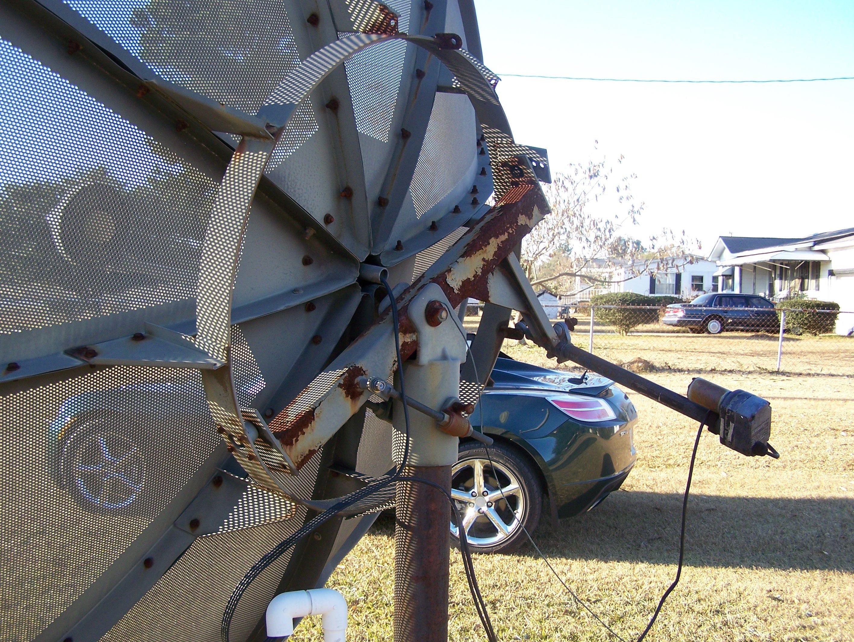

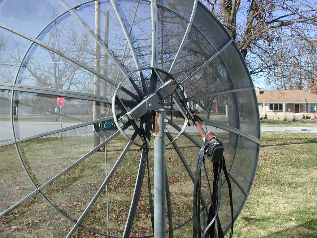

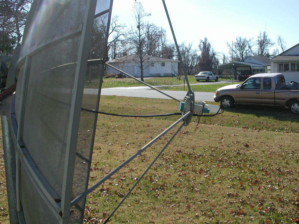

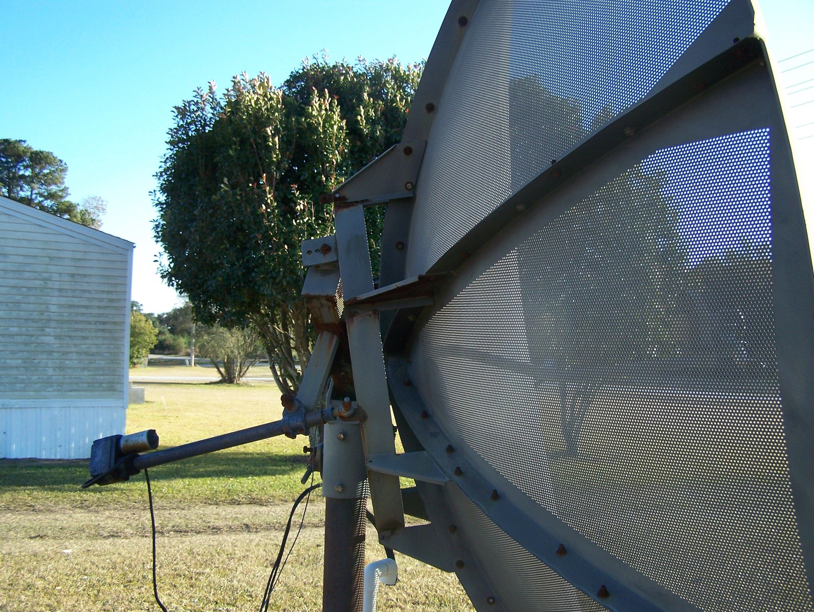

The wife and I went for a long ride yesterday. We do live in the "woods", it's 14 miles to a town with a redlight. I saw between 12 to 15 Bud's just from the main highway, no side roads. I did stop and take some pictures of a dish like I have never seen before. I thought I would share this with you. I have never tried to attach pictures before so here goes. Take note of the manufacture, I was surprised.
That will make you a fine dish!
Now if you can just get it and bring it home! :eek:
Curtis Mathes?
There's a name I haven't heard since the 70's... or maybe 60's...
Who the heck did they OEM that dish from?
It's a real beauty.
Wonder if any of our old-time members or professional installers have ever seen anything like that before?
It's a heck of a nice way to build (and ship) a dish .
But in all the pix posted on the forum, I don't recall ever seeing such a thing before.
Not one built like that AND perforated!
