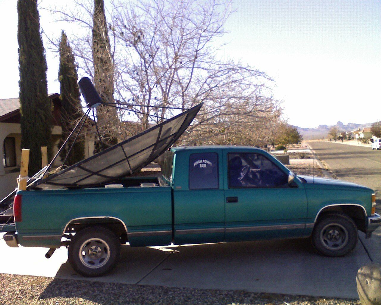

All the literature I have says 12', 14.5', and 16' dishes were made at that time. Later on in the run (late 80's or so) an 8' was made. If you have a 10' Paraclipse it will be a first, but I have to say, it doesn't look as massive as my 12 footer does...either way nice find, especially since you got one with the quad leg LNB arms instead of the bouncy buttonhook...very nice.
EDIT: Looking at your pics again, if that is a long bed pickup truck that will mean 8' bed, and the dish fits pretty well inside the bed. I do believe you have an 8' dish, friend. A 12 footer would be hopeless in a pickup.
Measuring across the open front of the dish from rib tip to rib tip is 10'. See photo. Don't know what else to say... I've been driving by it for years and I always thought it was a 12', tape says different.
Regards, Eric
added- I did find one reference to a Paraclipse Classic 10 on the internet, in a 1994 e-mail from a Canadian. Suppose they made it for the Canadian market? I'm only 30 miles from the border.

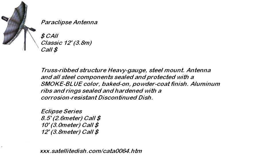

That dish is a great find , looks like it will hold up to anything mother nature could throw at it . I did a little searching on the 10' and there is a little info out there on it . Good luck with your find .
Not trying to undermind our great sponsors , but WOW i'm drooling . LOL

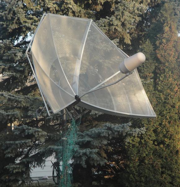

I thought Paraclipse dishes were 12 feet across... or bigger?
What size ya got there?
I came across a 10' Paraclipse about 35 miles from here. Not sure of the model. It was kinda of funny that the actuator is a hand crank!

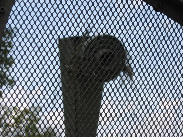

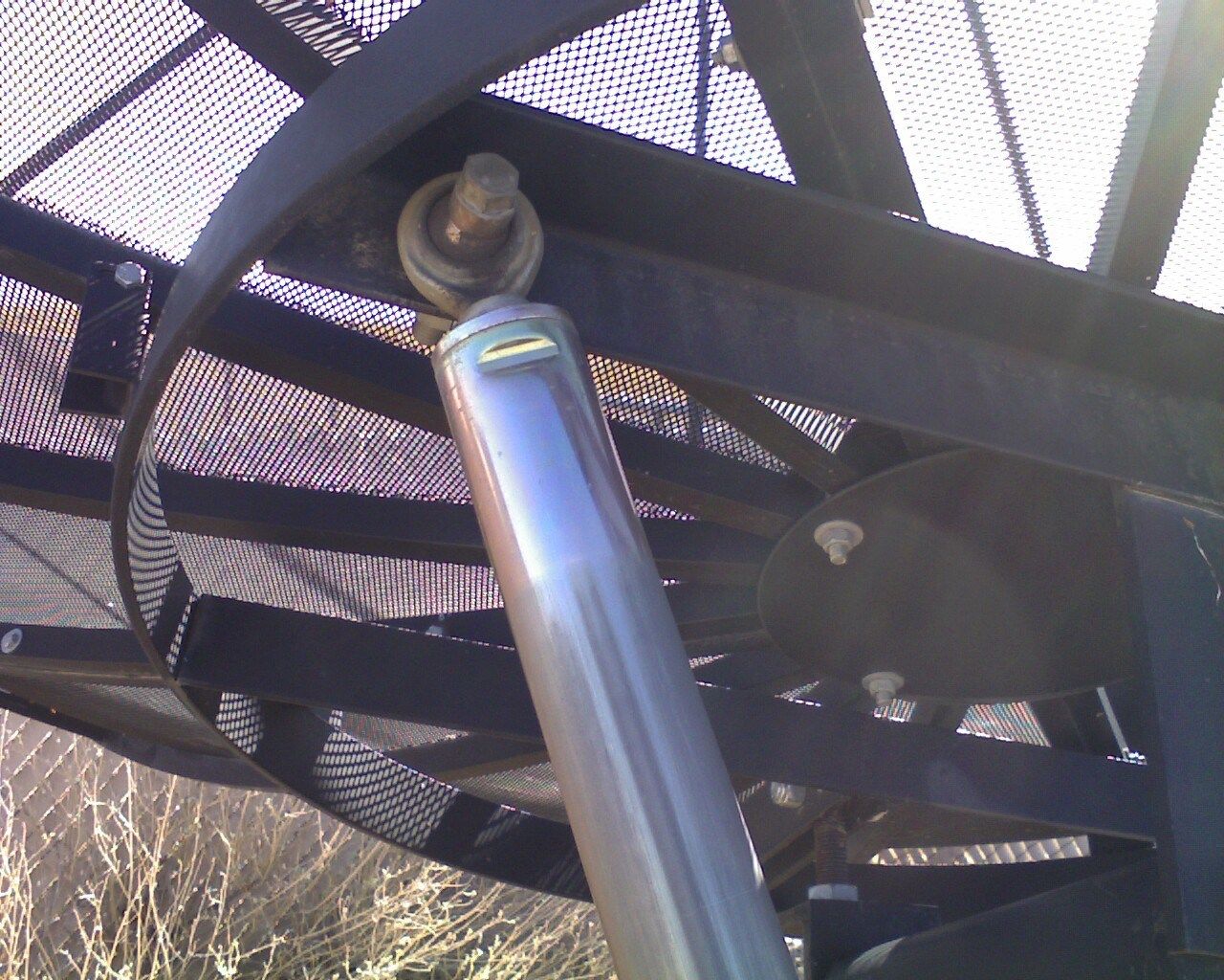

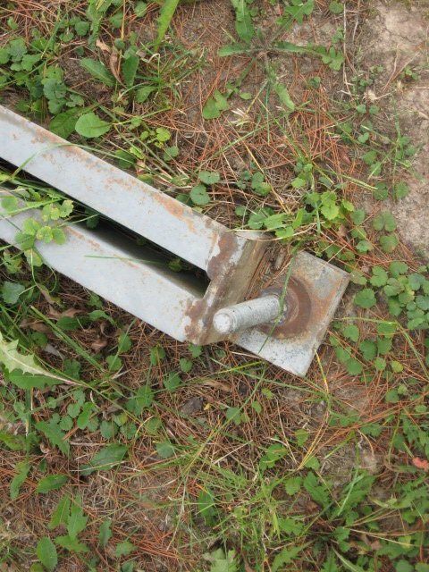

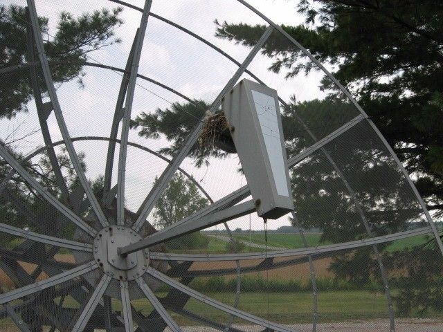

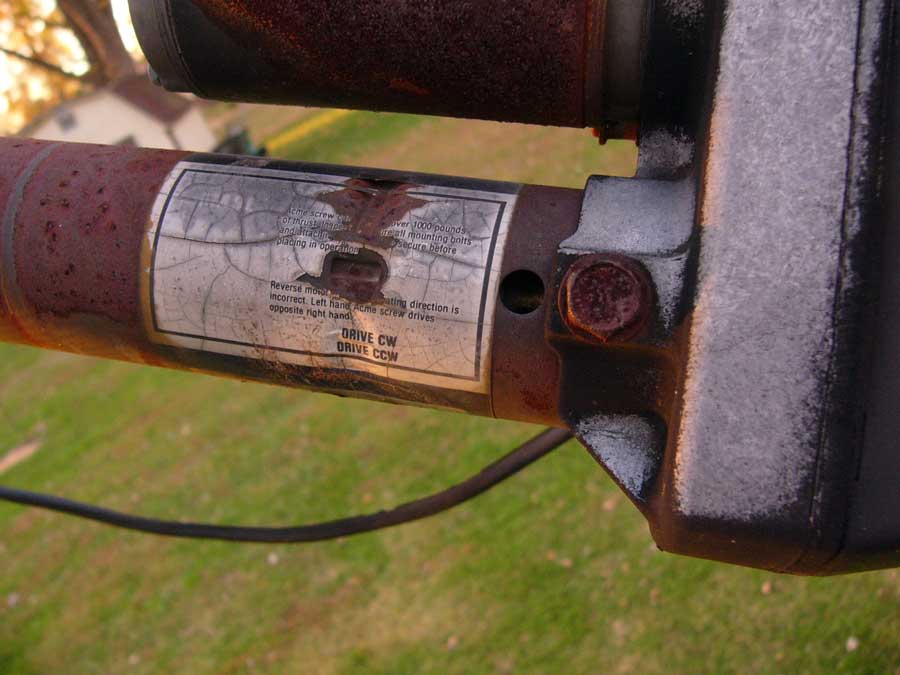

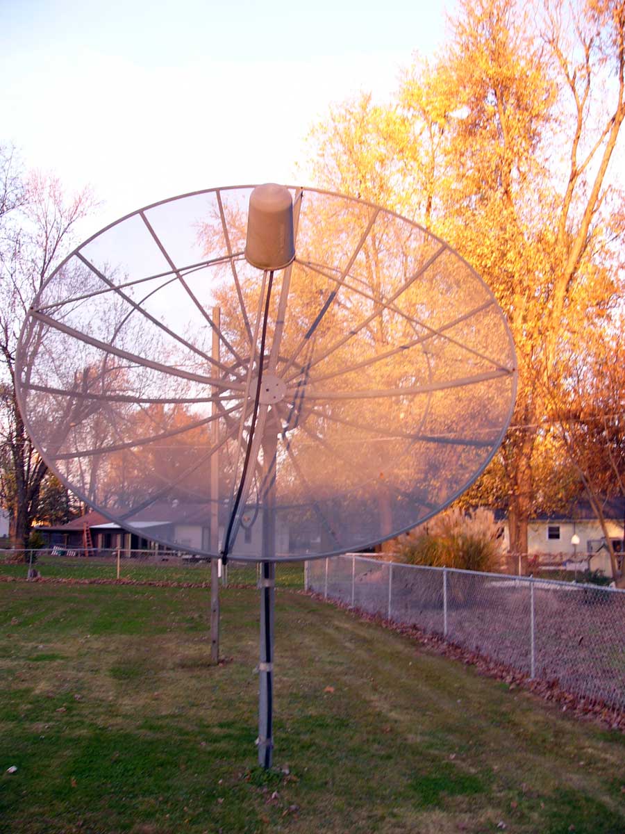

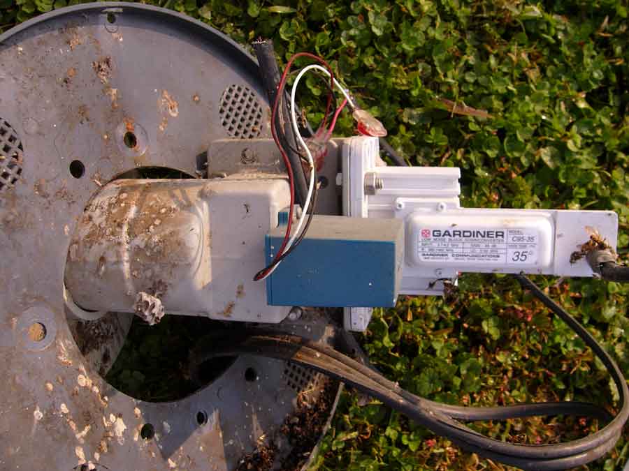

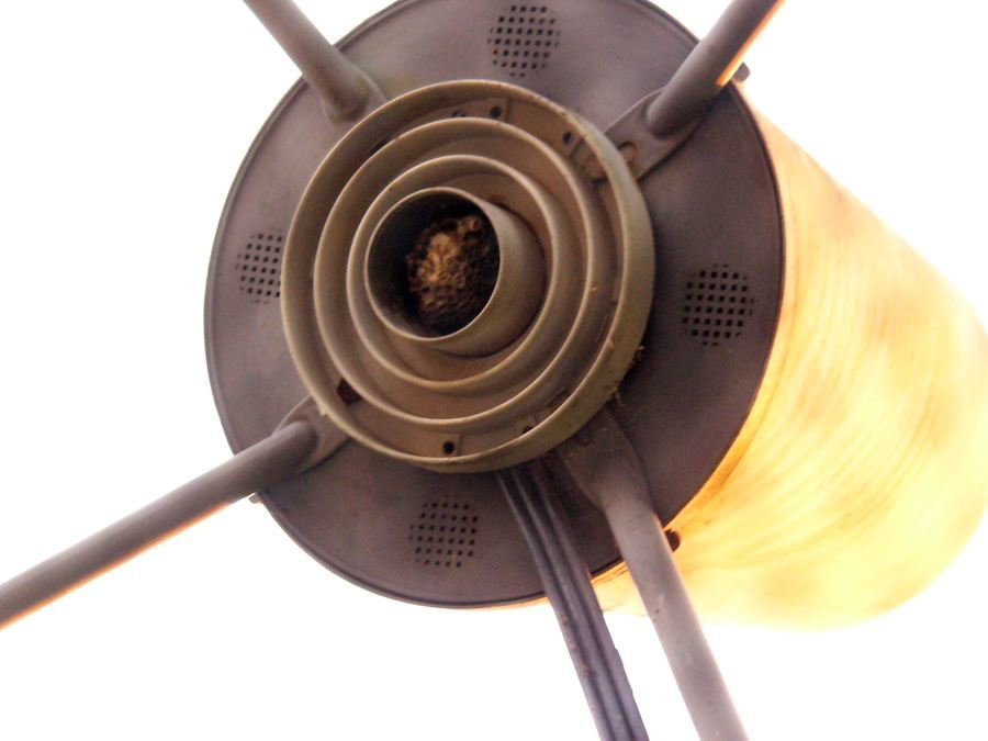

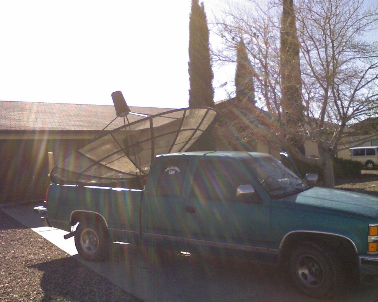

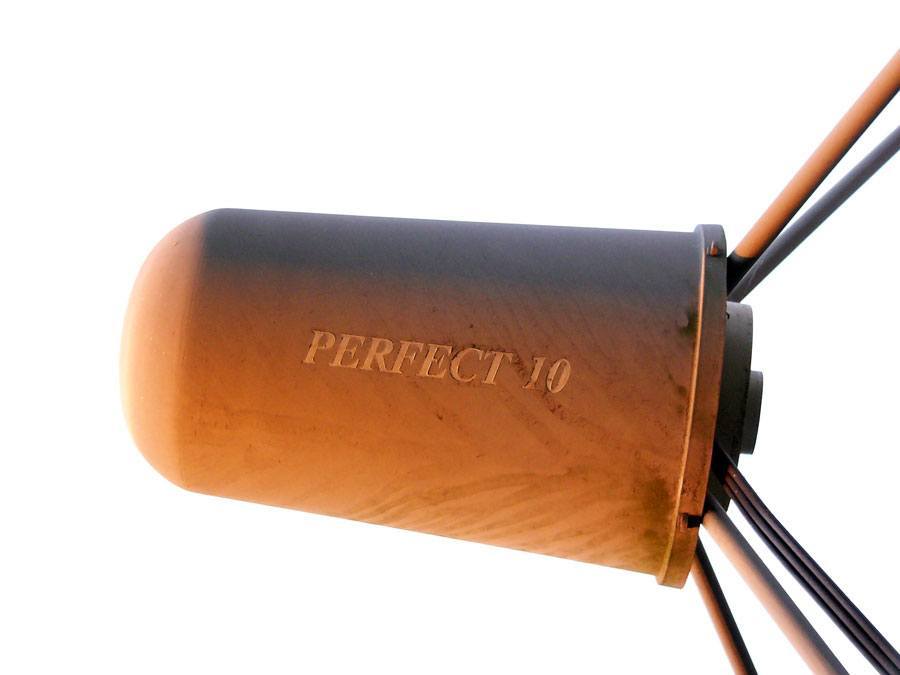

Bo Derek comes home with me today!
Ok, not Bo, but a Perfect 10!
It took a couple of hours to take down by myself, and is resting against my shed at the moment. It's still too big for my place, but hey!, it was FREE!
The LNB and shroud were full of wasp nest. Most of the bolts that held the quarters together snapped with a half a turn. The pole wasn't filled with cement. Very easy take down.

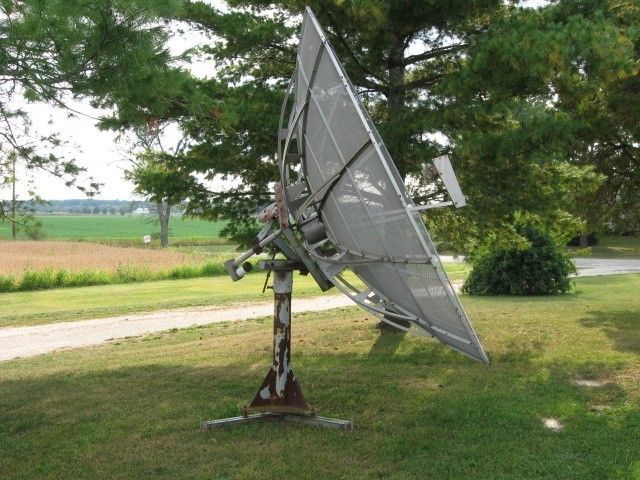

Hi all,

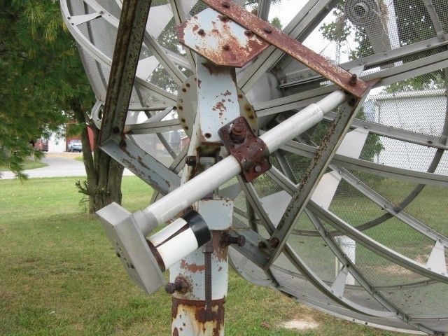

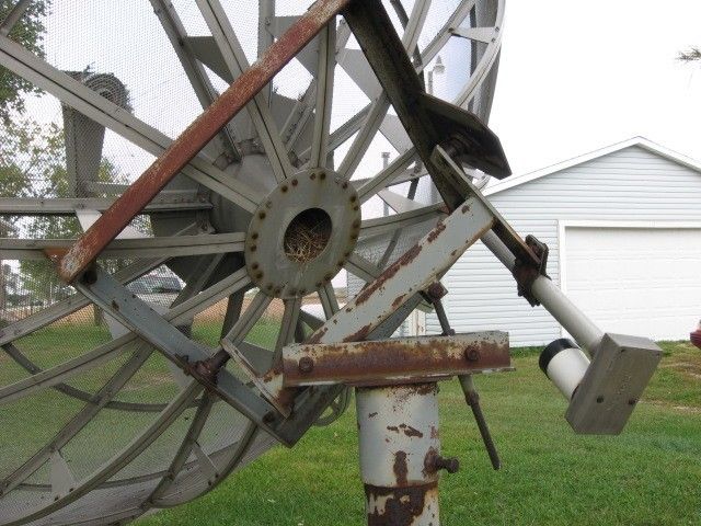

I finally got a chance to finalize the deal on that Viewmor, 11 footer. Found out they were made in Nebraska by a company that made grain bins. The dish is aluminum mesh. It has a Chaparral Polarotor feedhorn. With it came a Luxor 9550 receiver, which I'm assuming is analog, so worthless, and a Luxor 9534 actuator. I'm hoping to get this thing moved next week so I can start to play with it when the snow starts blowing.

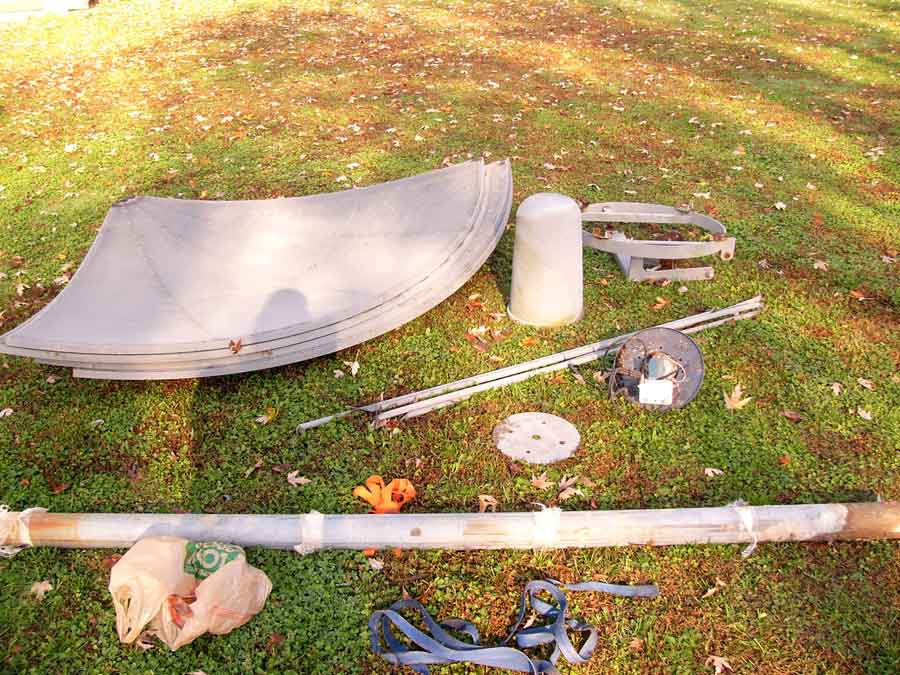

I always thought Bo was just one old man's over-promoted obsession, and otherwise just average.
Your dish on the other hand, is a timeless beauty!
Hell of a BUD kit you got there. Love the way all the pieces are laid out on the lawn!

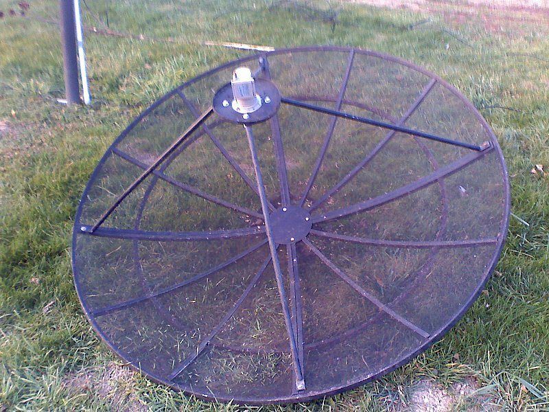

Had a guy stop by last week who use to install dishes and now installs pizza dishes and he ended up giving me a 6 foot mesh dish and some other parts to add to my family of dishes. Got three new 350I's and a new TC750 and TC700 by Town & Country along with a Unimess dish. Suppose to also get some new actuators if he locates them.

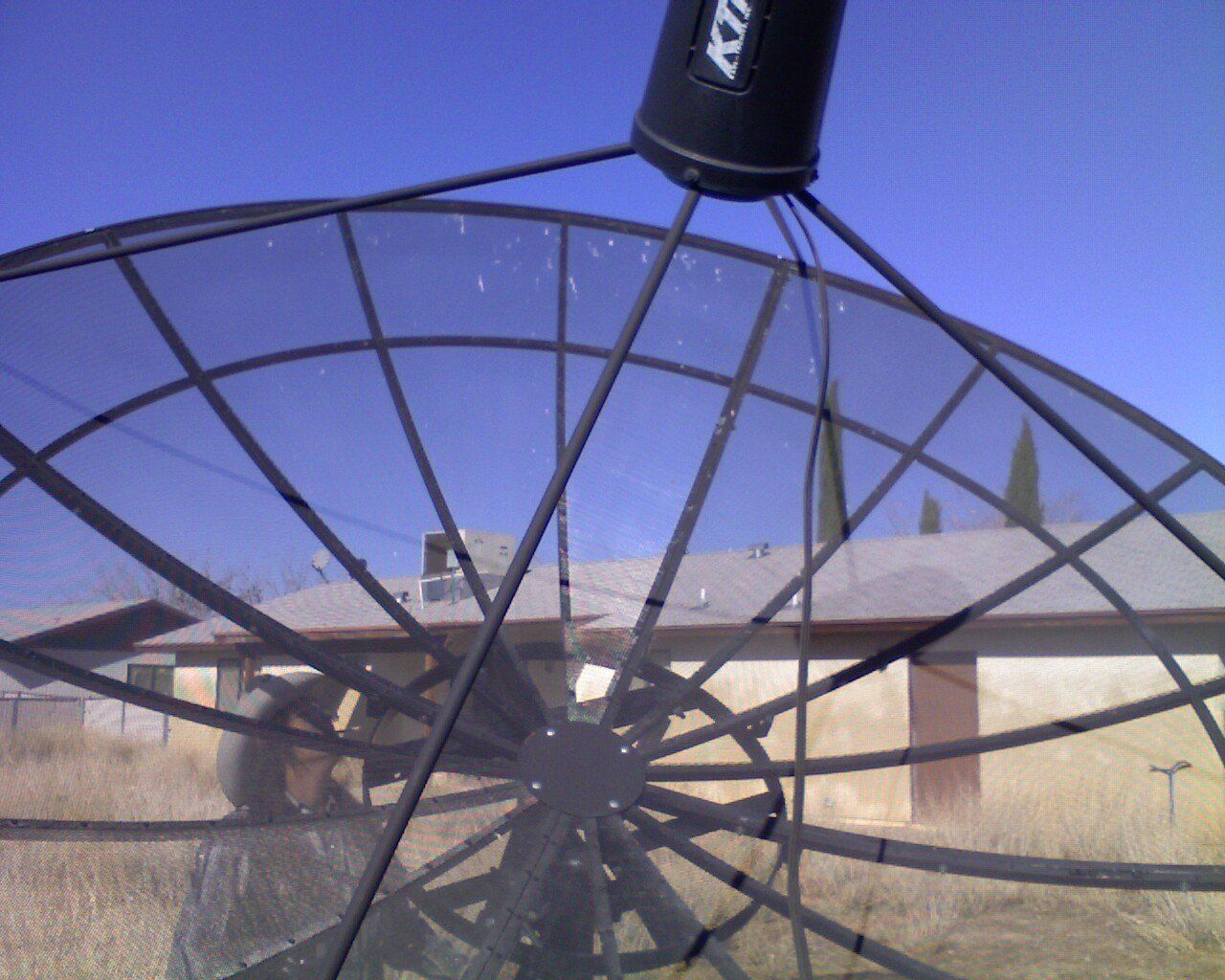

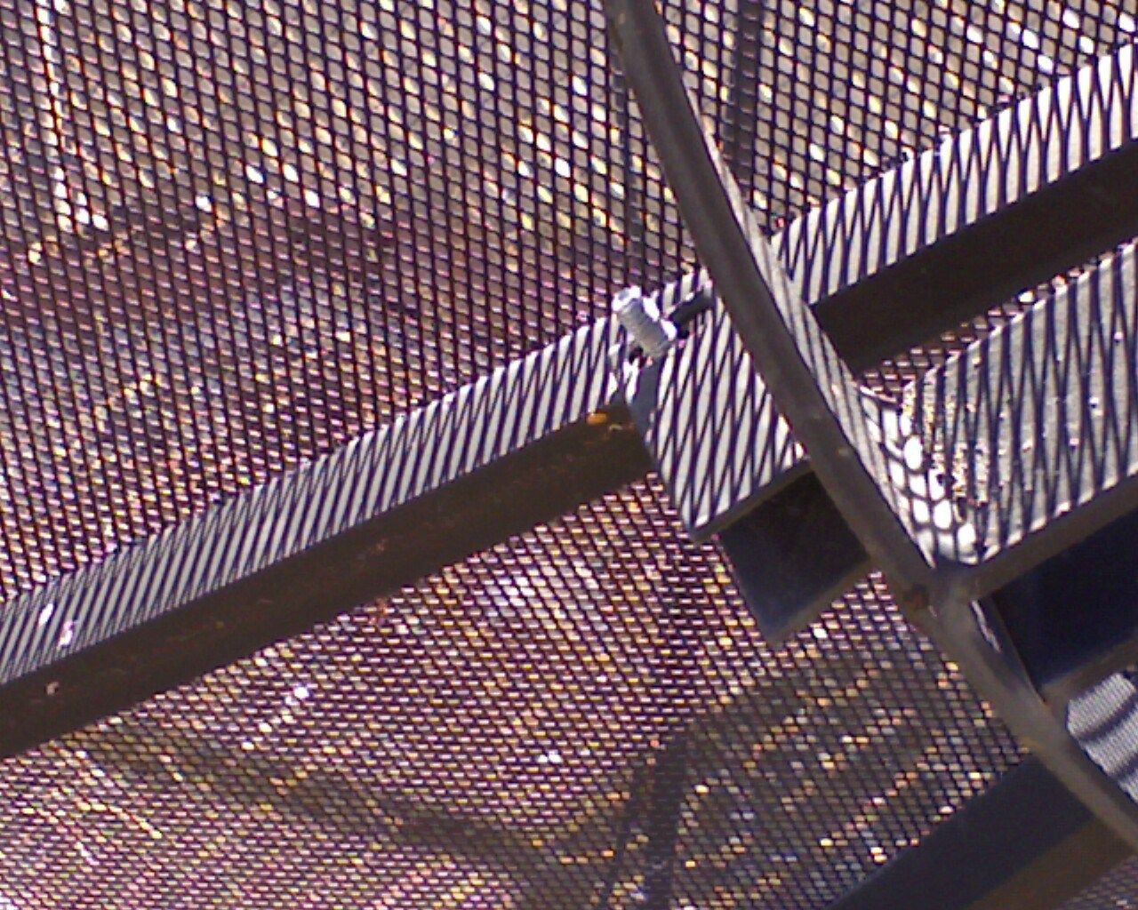

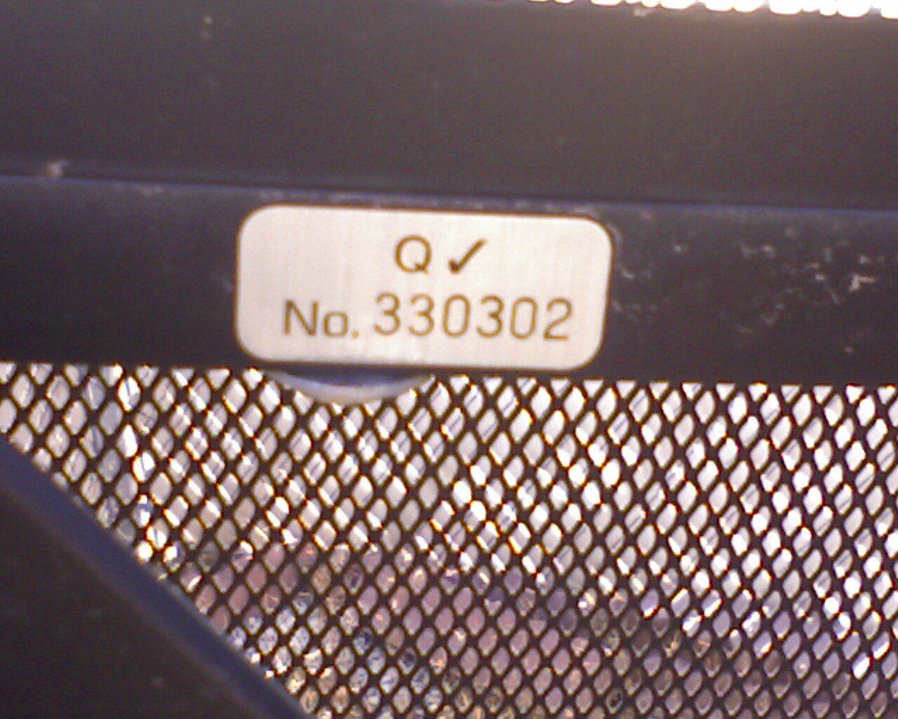

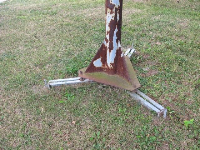

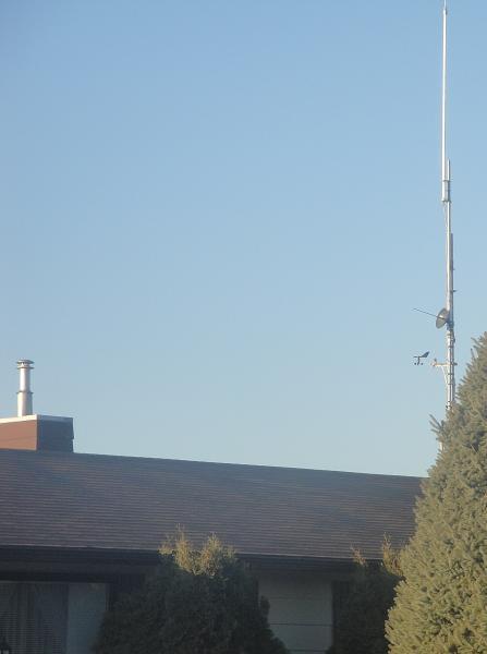

so i forgot to post pics off all my scores this summer. i really am terrible. haha. anyways i guess i got 2 8 ft mesh (sami but not confirmed, badged startrek), 1 8 ft spun aluminum, 1 9 ft spun aluminum, 1 8part 10 ft solid aluminum, 3 10 ft mesh (sami but not confirmed, badged startrek). i missed out on 1 12 foot. it was yummy.
i still have a few dishes i could take down but its late in the season. haha. kinda getting nipply here, although unseasonably warm.
i also scored a 1m channel master, and added a 1.2m fortec to the 39 inch and 2 36 inch ku pans. i almost need to put the emp 17x4 back into use. haha
anyways a few new pics. the first is what i think is an xplorenet ka dish ??? on a sketchy pole with a cb whip maybe? the second is a wierd one. i was told and told again that the dish was installed like this but i think it couldnt have been. haha. is it an 8ft paraclipse maybe ? missing a few bits ? and if the paraclipse are so rock solid i know where i might have just scored a 12 footer. ill take pics tomorrow when i go to see if its bent. i know the feed supports are wrecked but im gonna string it.
crackt out,.

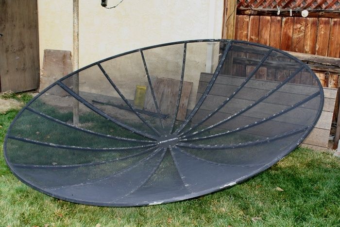

Joining the 10 foot club
[FONT=&quot]

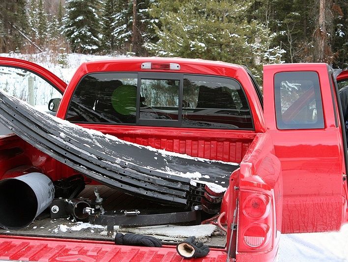

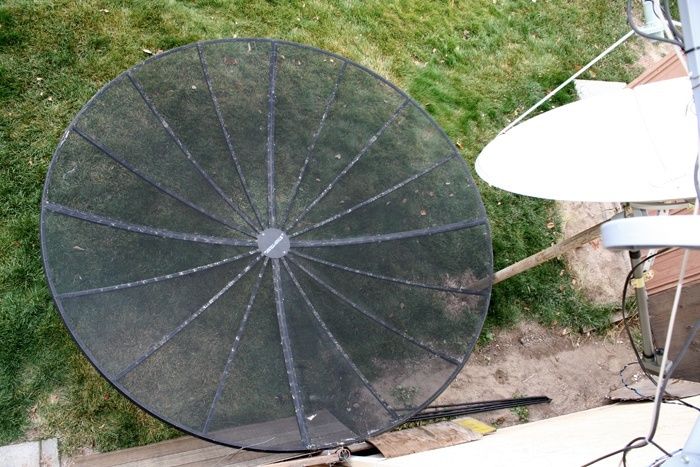

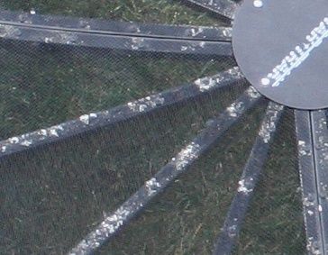

[/FONT]Found a 10' (10' 4" rim to rim) Startrak mesh in the mountains near a ski resort. Took it apart up there and dragged it home.
Put the dish together this morning, just have to put the mount and LNB/arms back on and find someone to help me pop the beast up on the pole.
It's in great shape but has some mildew on the front on the dish frame. Going to mix up a [FONT=&quot]solution of 25 percent [FONT=&quot]bleach[/FONT][/FONT][FONT=&quot] in water with a bit of detergent to take it off.
Hope to get it up and completed this week. 10' is going to be pretty tight for where I'm putting it, but should just fit nice and cosy.
Man the mount is heavy (50lbs) compared to my 6' fortec.

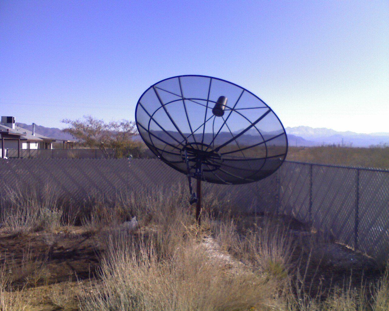

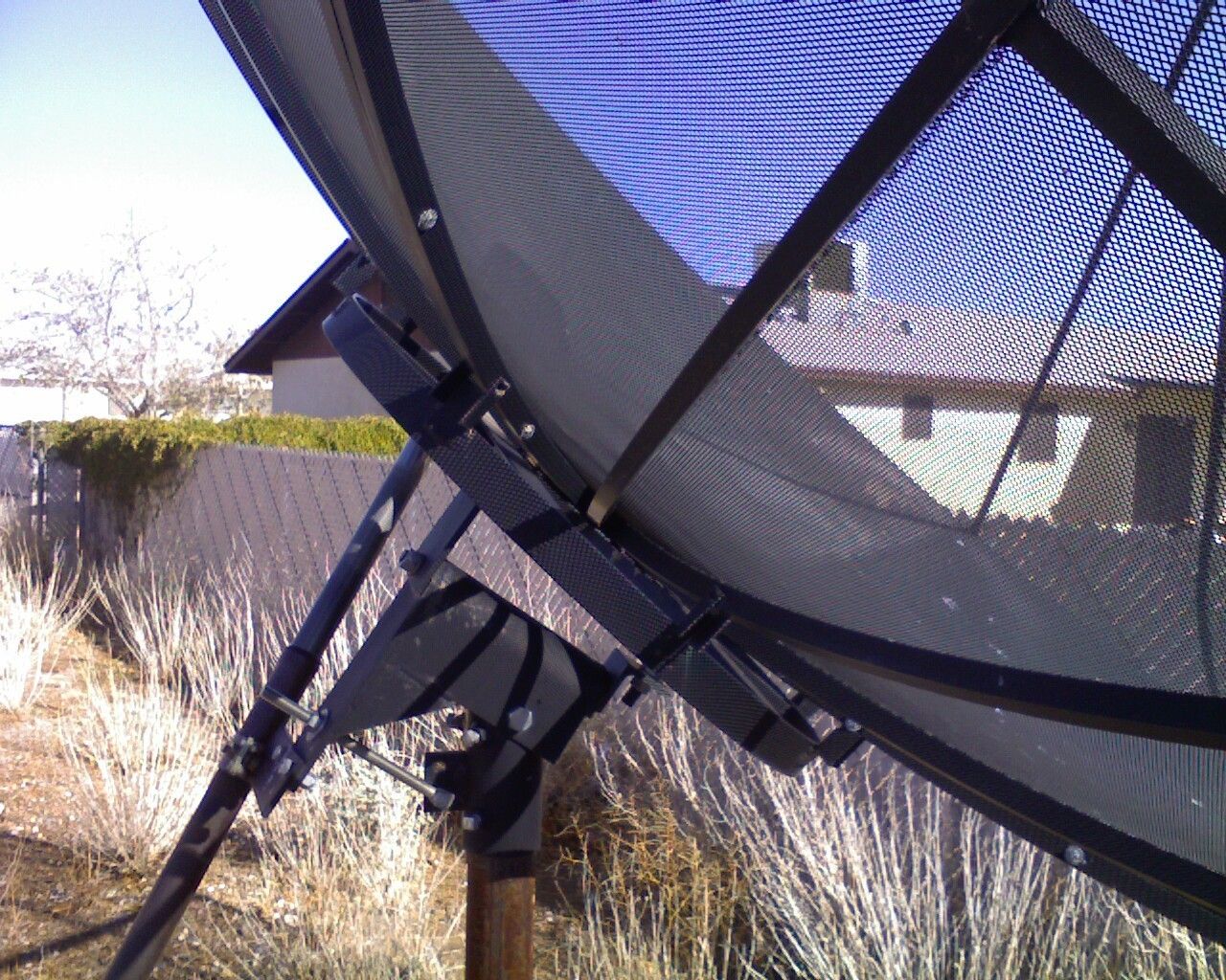

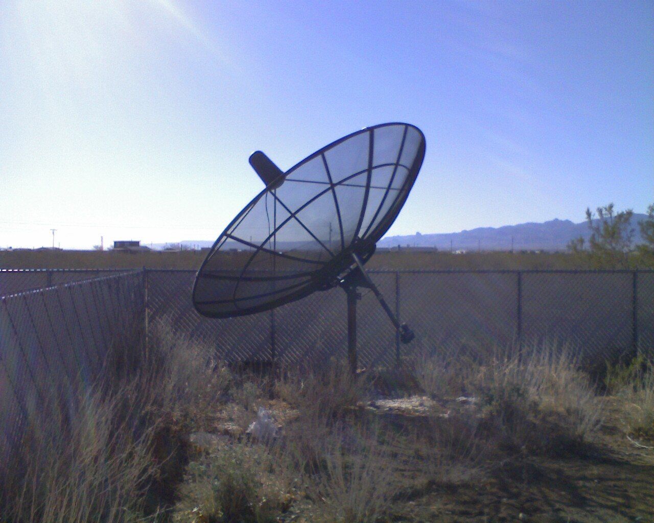

A new dish moves in!
Coming home from work last Sunday, I finally decided to stop off at a house in a tract and ask if they were still using their dish. I've been looking at this dish now for about six months and it always seemed to be sitting there, facing the same direction, and never moving.
The homeowner opened the door as I was walking up the sidewalk, and before I could say anything, this very friendly man asked if there was something he could do for me.
I asked if he was still using the dish in the back, and he said no he wasn't. Hadn't been used in several years.
I asked if he'd like it gone and he asked what I was asking to haul it away. I couldn't help laughing; just a tiny snort, and I told him I would just take it and the pole if I could get it out, but not that day. I told him I would be back.
He walked me through the house to the back yard and we stood there talking and chatting.
I asked if Tuesday or Wednesday this week would be OK with him, Phottoette and I would come over if it wasn't raining, and he said "Sure, come on over. If anyone asks what you're doing, just have then call me " and he gave me his work number, home number and email address.
NICE guy.

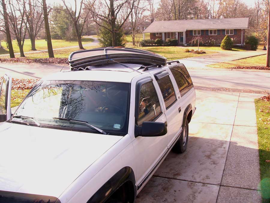

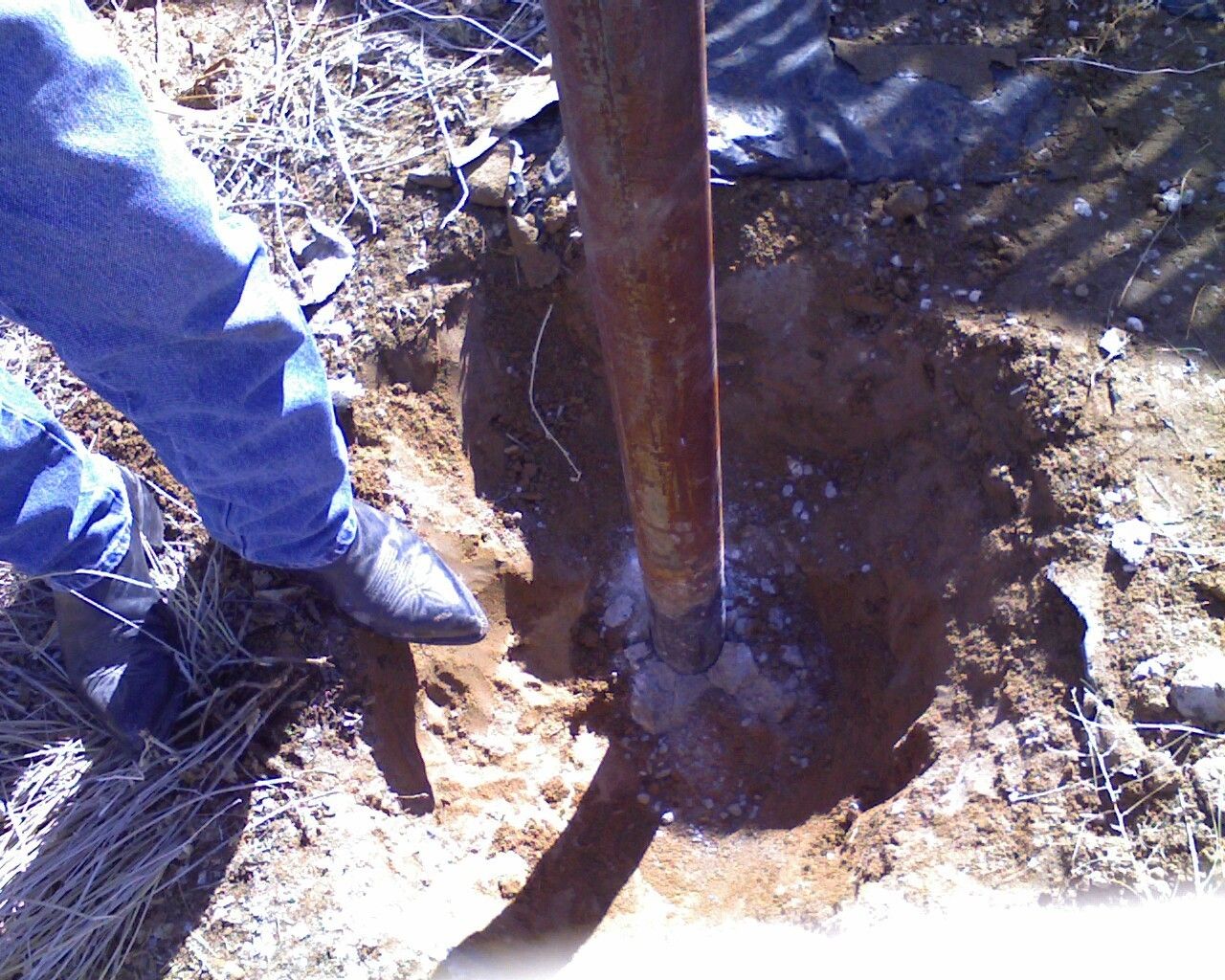

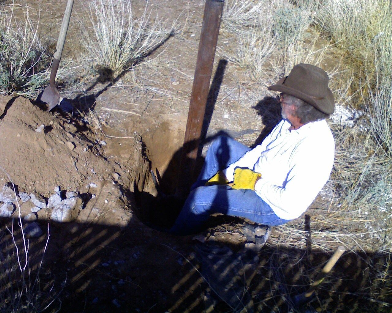

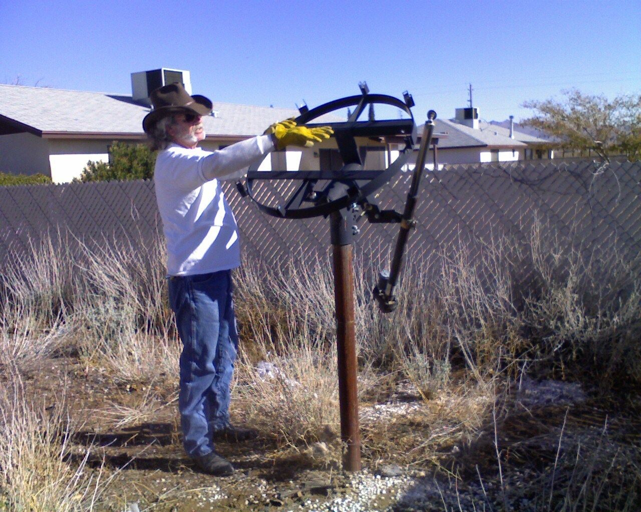

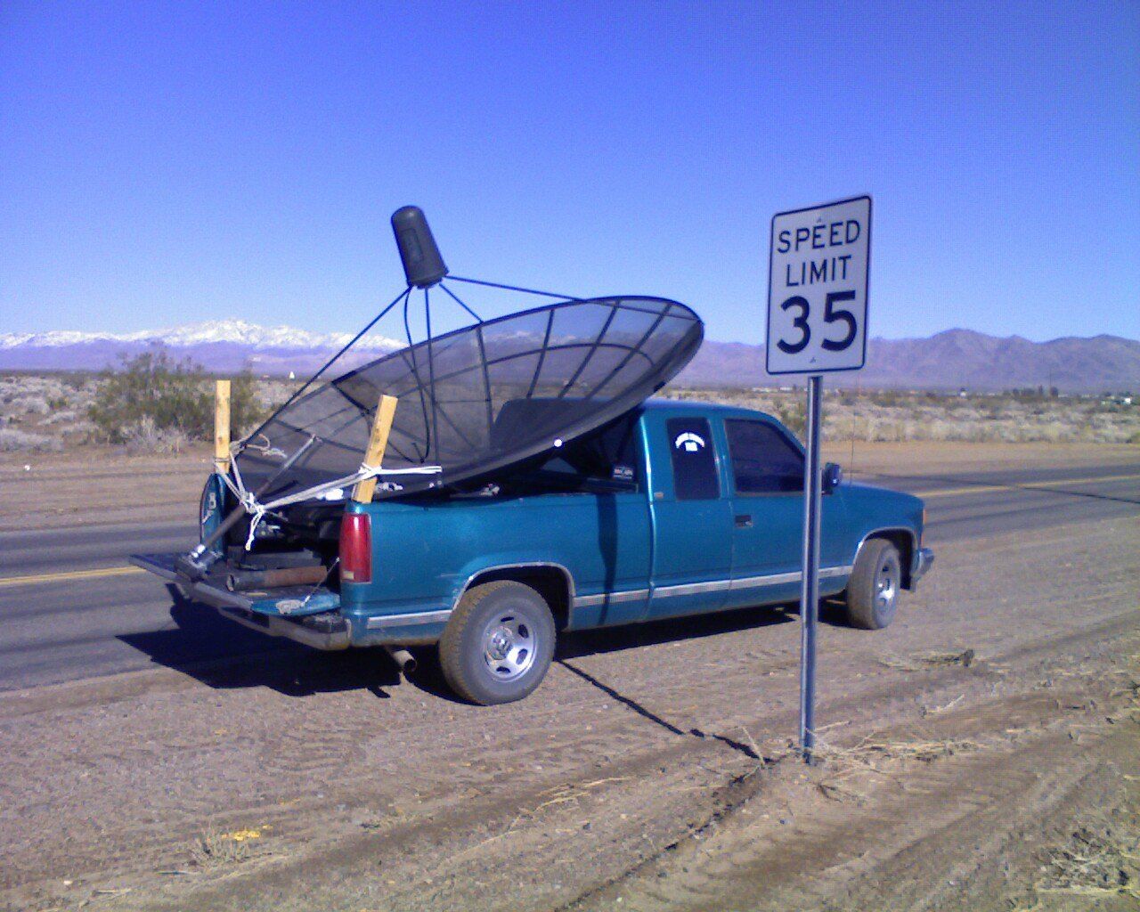

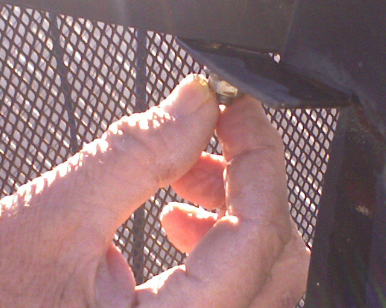

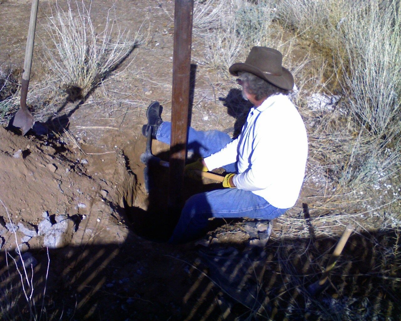

Phottoette and I went over there today. It only took about half and hour to take the eight screws/bolts out of the dish frame holding it to the back ring. We carried it across the yard and put it in the back of the pickup, then went and took the ring, support and actuator off, and laid that on the ground behind the truck.
Then we started digging. THAT took nearly three hours, break a little QuikCreat, pull out the rocks, break a little QuikCreet, pull out the rocks. And it went down about four feet this way.
BUT I saved the pole.
In order, here are the pictures we took with my Centro Camera.
Next week I'll have the hole dug in back of the house, cement the pole in, let it cure for about a week (it's been getting down into the 30's here) then in a week and a half or so, I'll have that new baby up and running.
Everything looks beautiful on this dish, passed the string test, the actuator looks clear, no rust I have seen so far but I still have to open it.
The dangling wires in the pictures were just like that when I first saw this beauty.
I DID remember to ask if he still had the receiver, and he said no, and I offered to help him put it back on line, but he just wasn't interested, so … today, this dish moved about 2.8 miles from it's old home to it's new one.

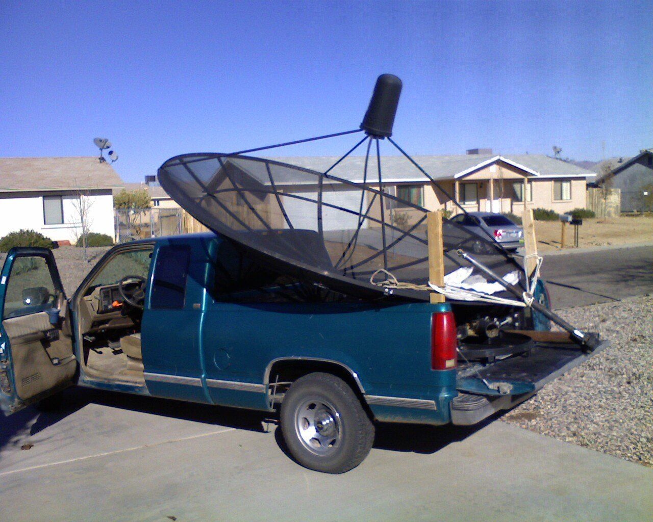

The last picture is possibly the only funny one. I drove home as less than 20 miles per hour, and still managed to slide the dish around a little, but all is good now, we made it home ... finally
