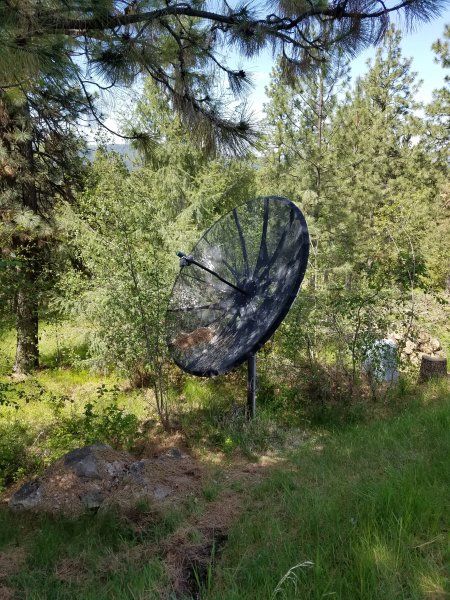

Found this 9' mesh .... no idea who made it.
It's on a some-what steep hill and looks like i might build a sled to winch up the hill. Im going to get it for free and i plan on getting it soon, but how exactly. Any one know how much it weighs ?
Any instructions on disassembling it or a manual would be great.View attachment 126181

If the dish is a 9' it's probably a Radio Shack dish. Good dish, some have a horizon to horizon mount, I have one here that I use daily.
One bad issue they had is the HH mount ones have a half moon shaped plastic gear that gets wiped out quick if it isn't assembled right. Other than that, real nice dish. I'll try looking again at your picture tomorrow and see if it'll load for me.
I have the manuals for the RS 9 posted up here somewhere, If it is that, I'll dig them up for you.
Yep .... found a thread for a 9 foot rat shack that was never used .... looks like what iv found ...

Does look like a radioshack 9'
I don't know how heavy it is all together, mine was new in boxes when I got it and I put it up piece by piece. At a guess I would say maybe 150? I could be way off though, I'm not good at judging weight.

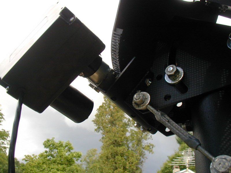

Here's a picture of the HH mount motor on mine. I don't have a picture of a standard actuator handy, but I'll take one tomorrow if I get the time. Got a lot going on this weekend.

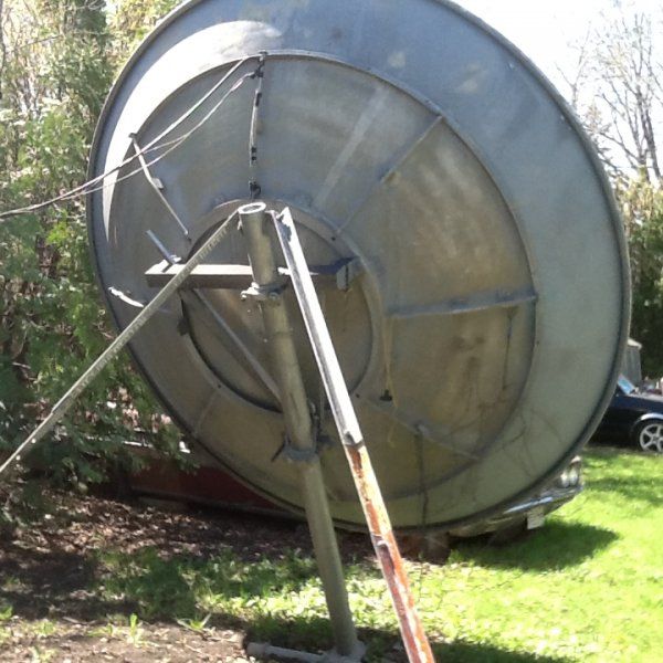

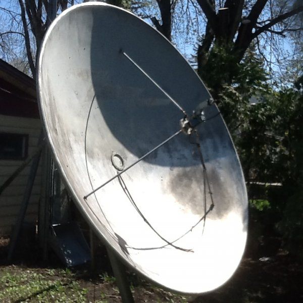

Found this not too far away, looks like an Andrews. Will have to take a trip with the truck I guess.

That's where the difference is. The motor off my RS dish doesn't fit any of my other actuators. It could be I have oddball actuators, but it doesn't fit the three I have.

Its not uncommon for the motor portion of an H-H to be bigger than its Polar equivalent. The motor on my Paraclypse H-H is a Von-Wiese and its twice as big on the one on a standard Von-Wiese 24 inch actuator. Its also twice as powerful. Its 1/10 Hp versus 1/19 hp.

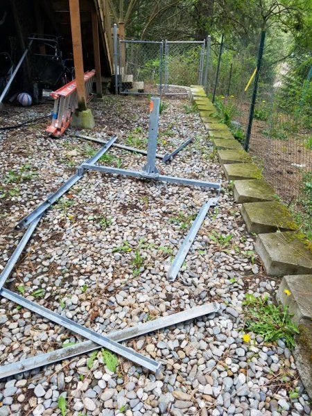

Picked this up while i was looking for a C-BAND .... id like to know if theres a manual for it ... its kinda bent and missing something i think ...
Say WHAT?!?!!?
