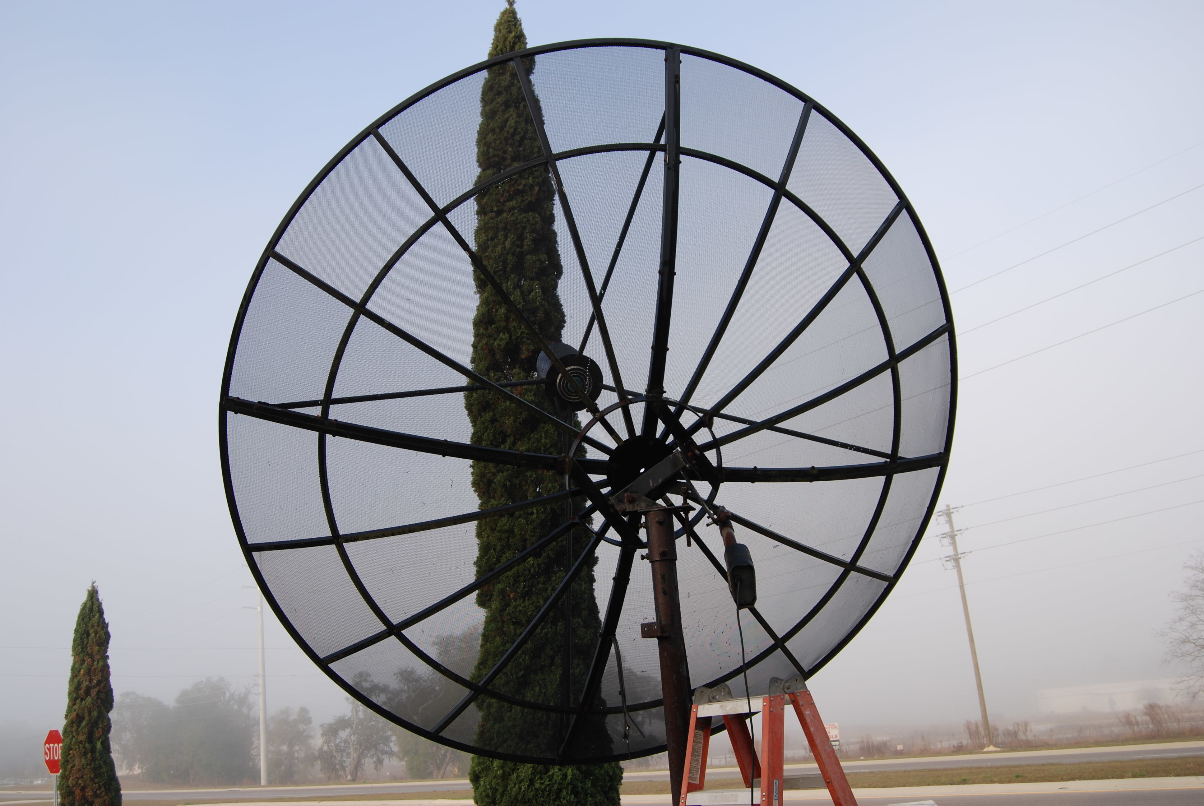

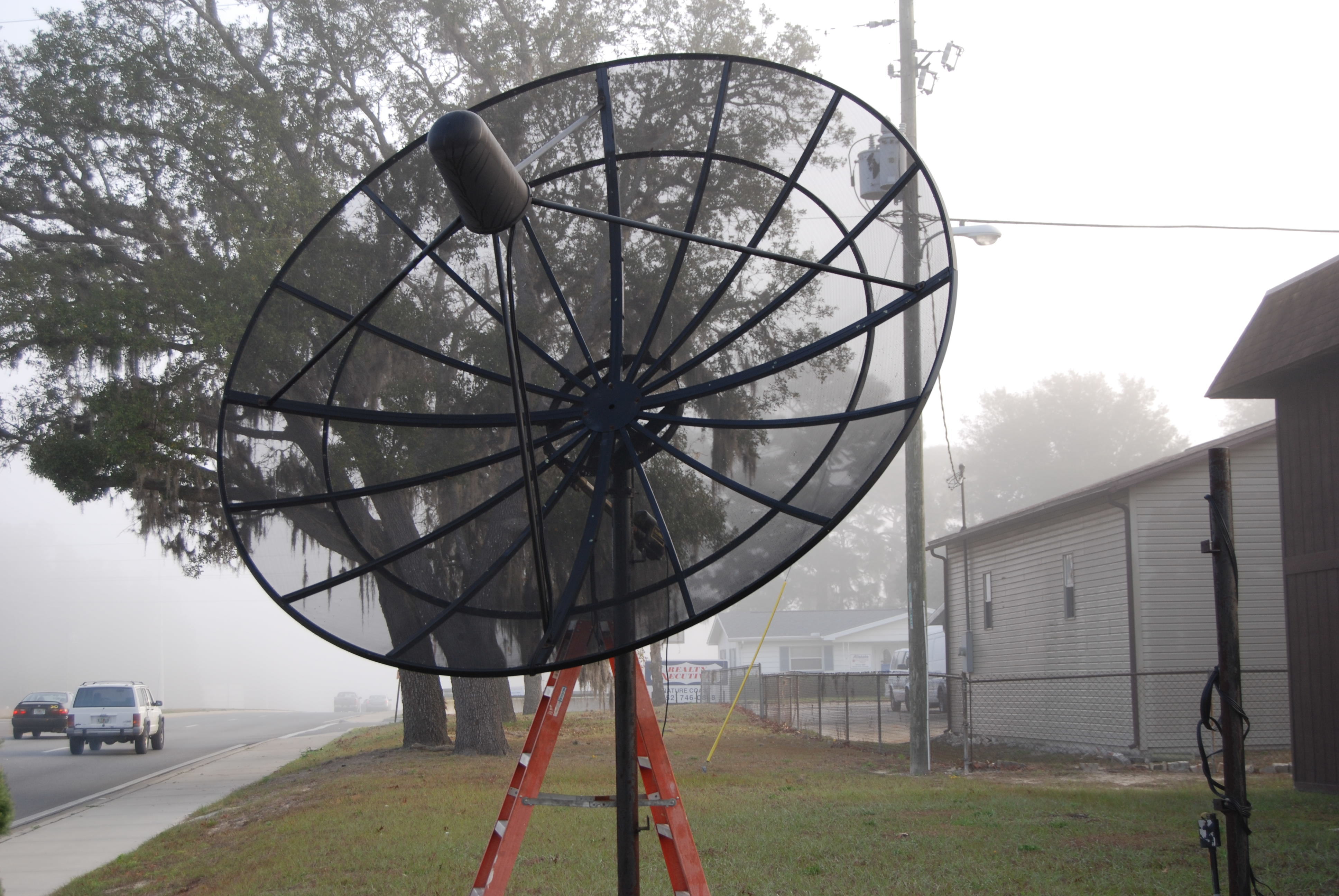

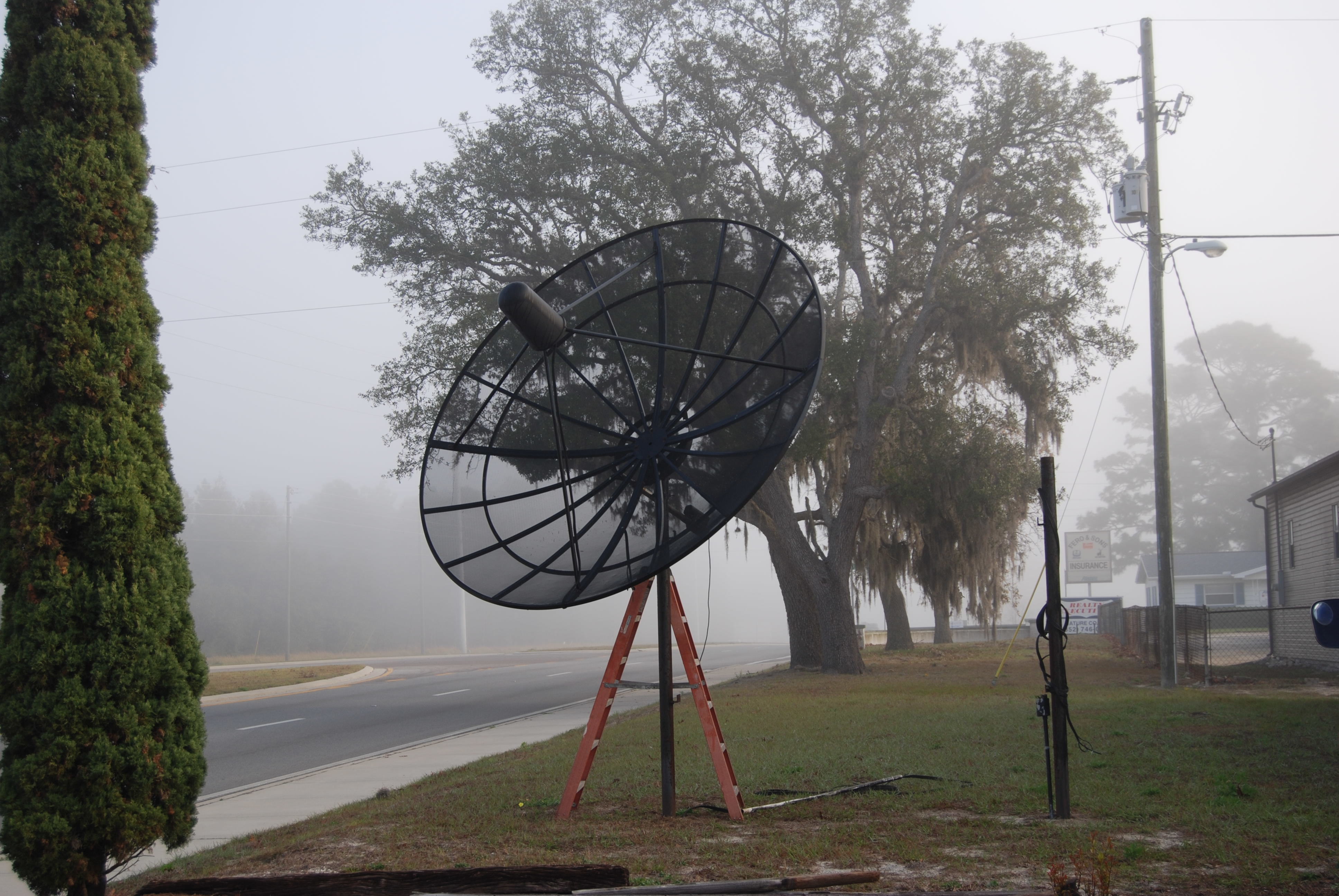

Hello linuxman Fred,
Remember my letter to you about finding all of thesr Satellite Dishes and finding that out of business Satelite store?
"I found a Satellite Shop that was out of business. He had about 6 dishes' there. I got a hold of him and he told me that he would have to think of it for a few days if he was willing to let go of them."
He called me last night and said if I could be there today (Saturday 2/16/2008) at 8:30am he would give me one.

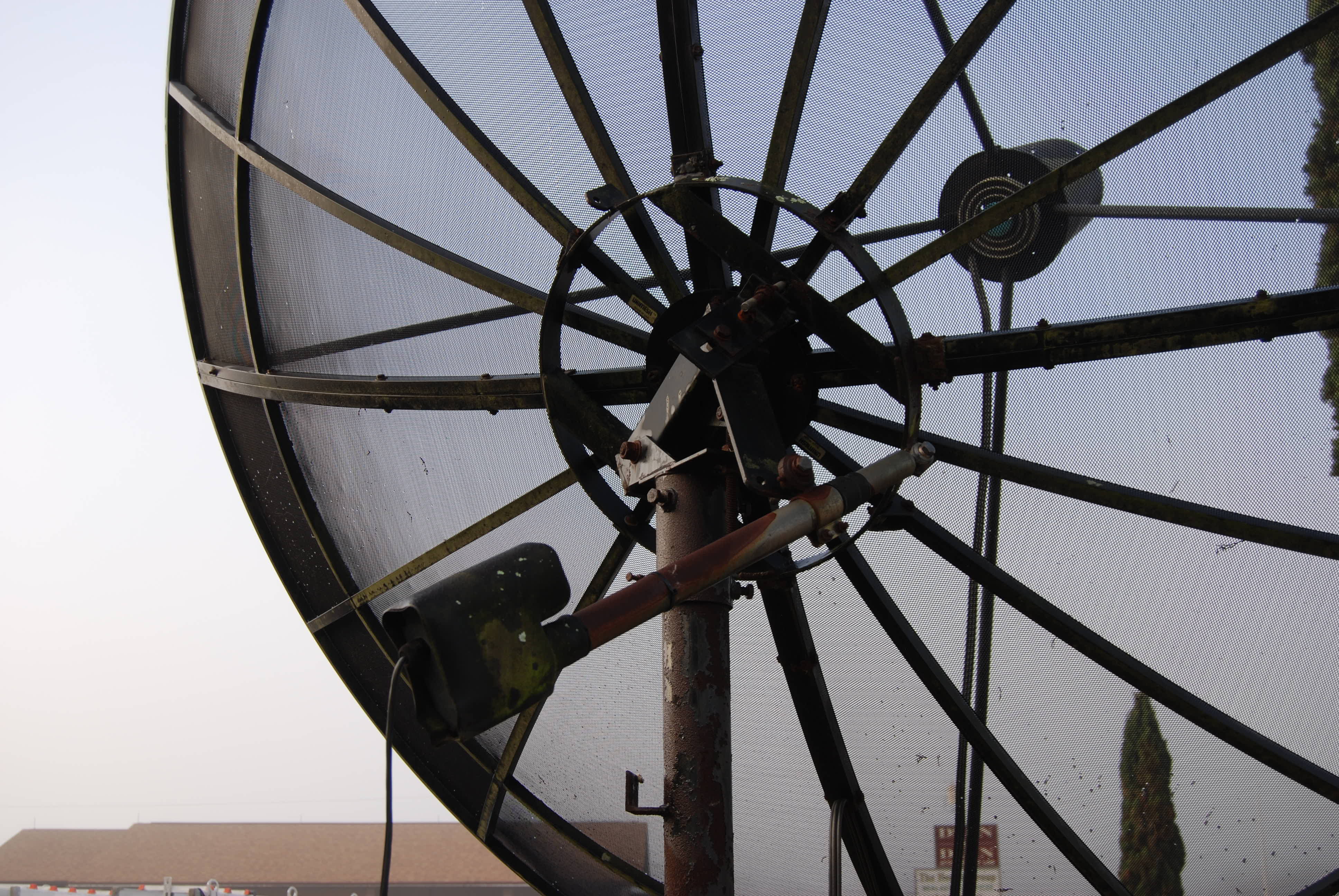

I have it now!!! Looks pretty good too. Needs a little Rust-Oleum on the rusted parts and a new coat of paint to make it look new again. Has a few (not much) dings in it most likely from hail.
It says on the feedhorn (very faded) Unidish and on the arm it says "Von Weise" Linear Actuators. Are you or anybody else familar with Unidish and Von Weise? I have enclosed some photos of "MY" Big Dish!! :clap
How does this one "Unidish" compare to the "Uniden UST-705" with the name of "RADAR" on the arm?
I still can get the Uniden UST-705 too. So going from wanting one to having two in a very short time is fantastic! I was talking to somebody else and they have two dish for the purpose if someone is watching TV in another room they can see what they want even if it is on a differnt satellite. :rolleyes:

10' Unimesh with Von Weise actuator

You're right they didn't make it! Will send in this post.
The Unidish is more than likely Unimesh,
You're right again!!! It wasn't till late afternoon that I could see the feedhorn without any clare. It reads Unimesh.
and the Von Weise actuator is a good dish mover.
Congrats on the good find.
The Von Weise actuator is not has rusted as the Uniden actuator. It does look a lot smaller then the Uniden actuator. I have read several pro and cons when it came to talking about the Von Weise actuator brand. Do you think I may have to replace that one too? If its a 10' Unimesh Dish... What size should I get for a actuator? Any Name Brands I should look for?
On the feedhorn, how do I tell if it's setup for KU-Band? The main dish looks great a few minor dent in the mesh but not too bad. A little surface rust on the brackets that could be repainted. Should I repaint the dish or would that cause some problems with reception? Speaking of brackets... In the post where I sent photo's of the Uniden the back brace (if I'm calling that right?) seems to be bigger then the Unimesh. Should I beef up that too?
The deal with me getting the Uniden fell through :(
It's going to her Father instead. Oh well it's not all bad, at least I got a Big Dish now! :D
And you are right again, I think it was a good find!
I live on a acre of land, how far should I put the Support Pole and Dish from the home? About 200' more or less? :confused:
Thanks for all of your advice. I'm just trying to make sure I do it right the first time around.
Tom
The Von Weise that you have is a great dish mover. It doesn't matter if it is 18" or 24", the shaft will only come out about 12.5" travelling from 139W to 143W, so 18" is plenty. That is the length of travel on my 10' Unimesh.
Painting is usually a good idea if anything needs it. As long as you avoid metallic containing paints, you won't hurt the receptiom.
It is called a mounting ring and polar mount.
Whatever was manufactured for the dish should be sufficient to handle the job.
If your Unimesh is properly tuned it will provide you with great signal strength for C and Ku.
The only way to tell if it is C and Ku is to take the feed-horn cover off and see if it has a C and a Ku LNB on it. :)
The closer the better. If you can avoid it, I wouldn't go further than 100 - 125 feet. Remember whatever coax is inside the house counts as distance for the signal and voltage to travel.

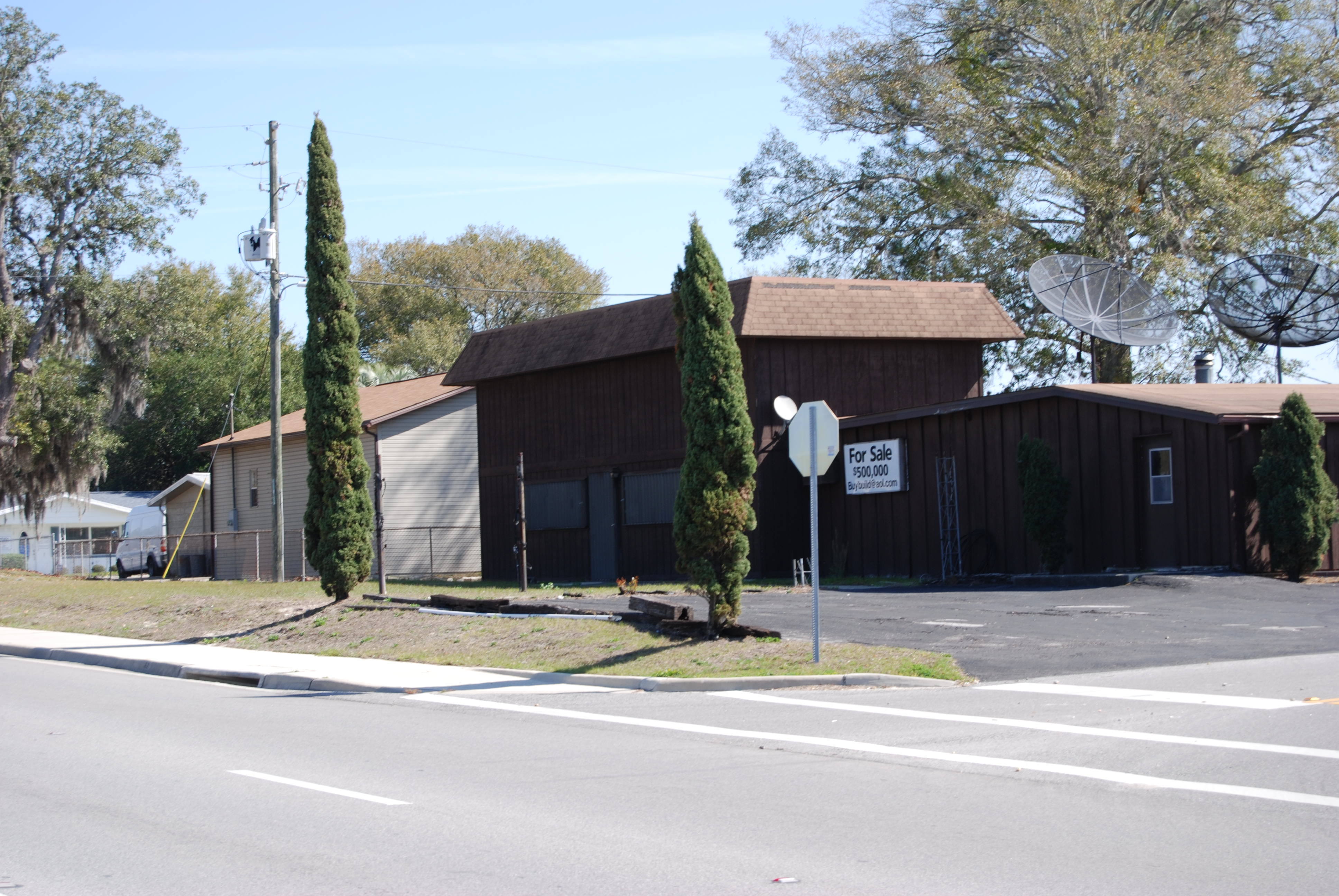

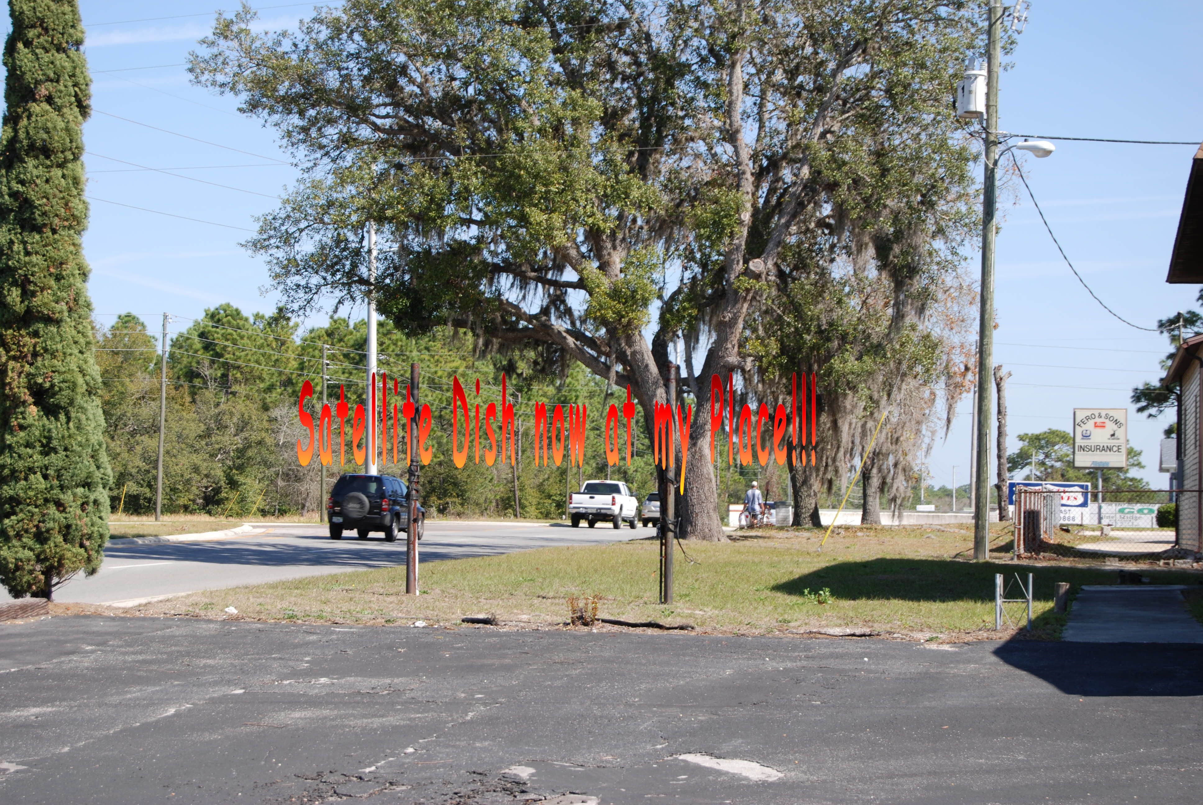

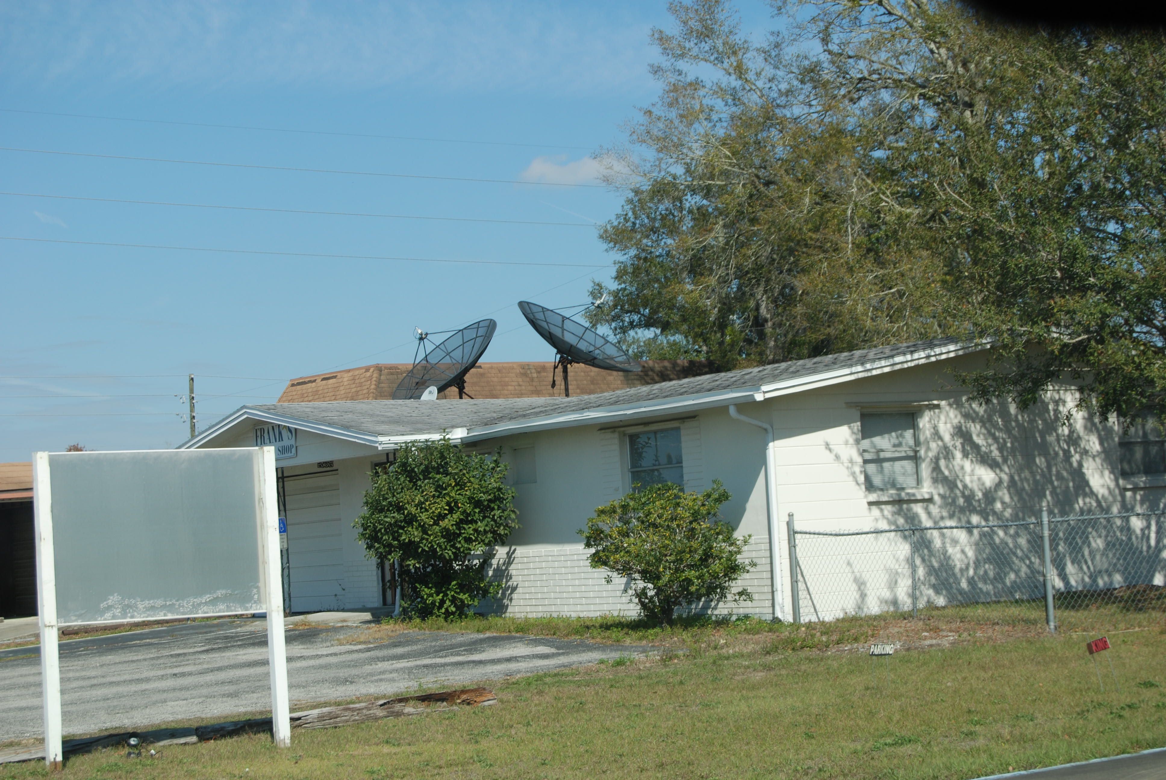

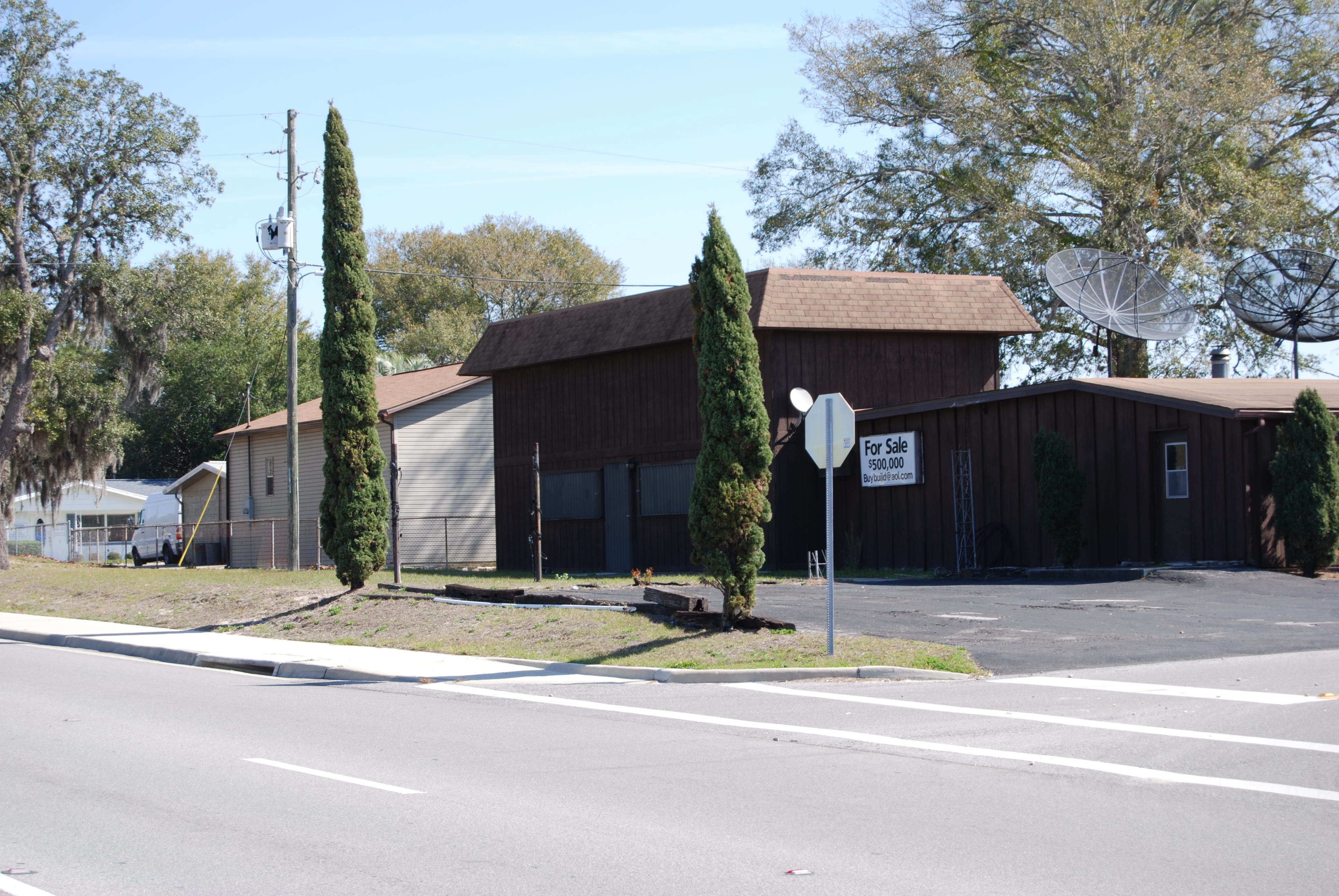

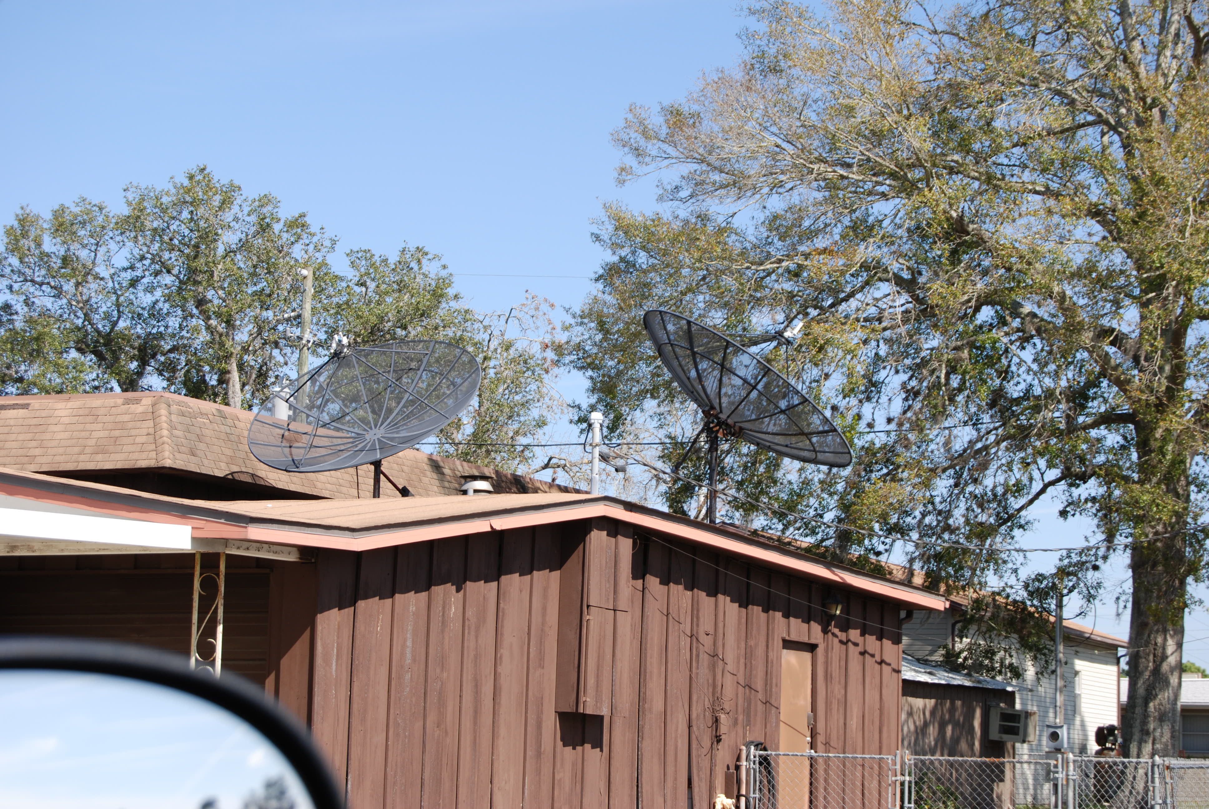

Here are some shots of the former Doug's Satellite Shop.

Looks like there are multiple LNBs on both of the dishes at the shop. You might luck out and get C/Ku. :)

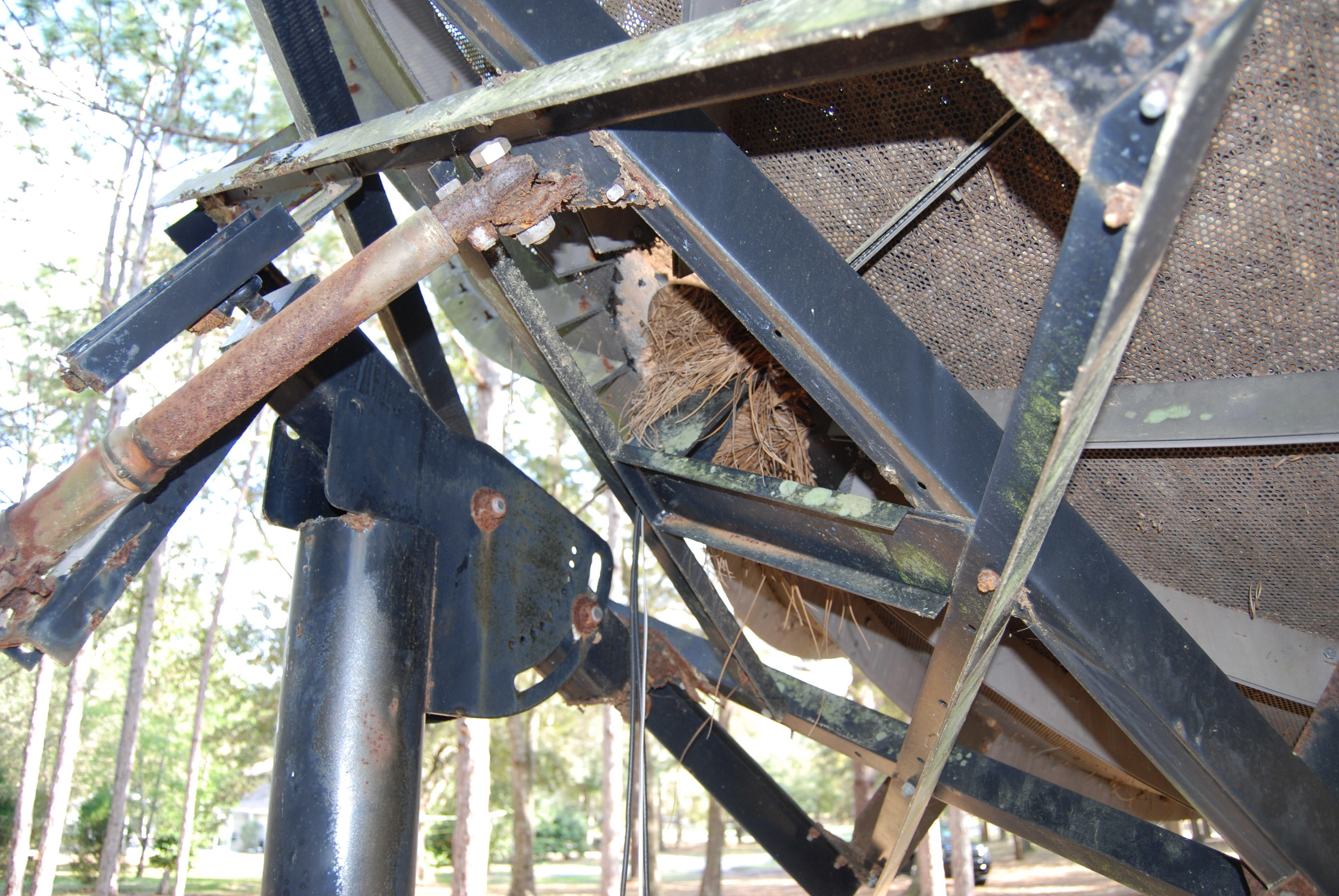

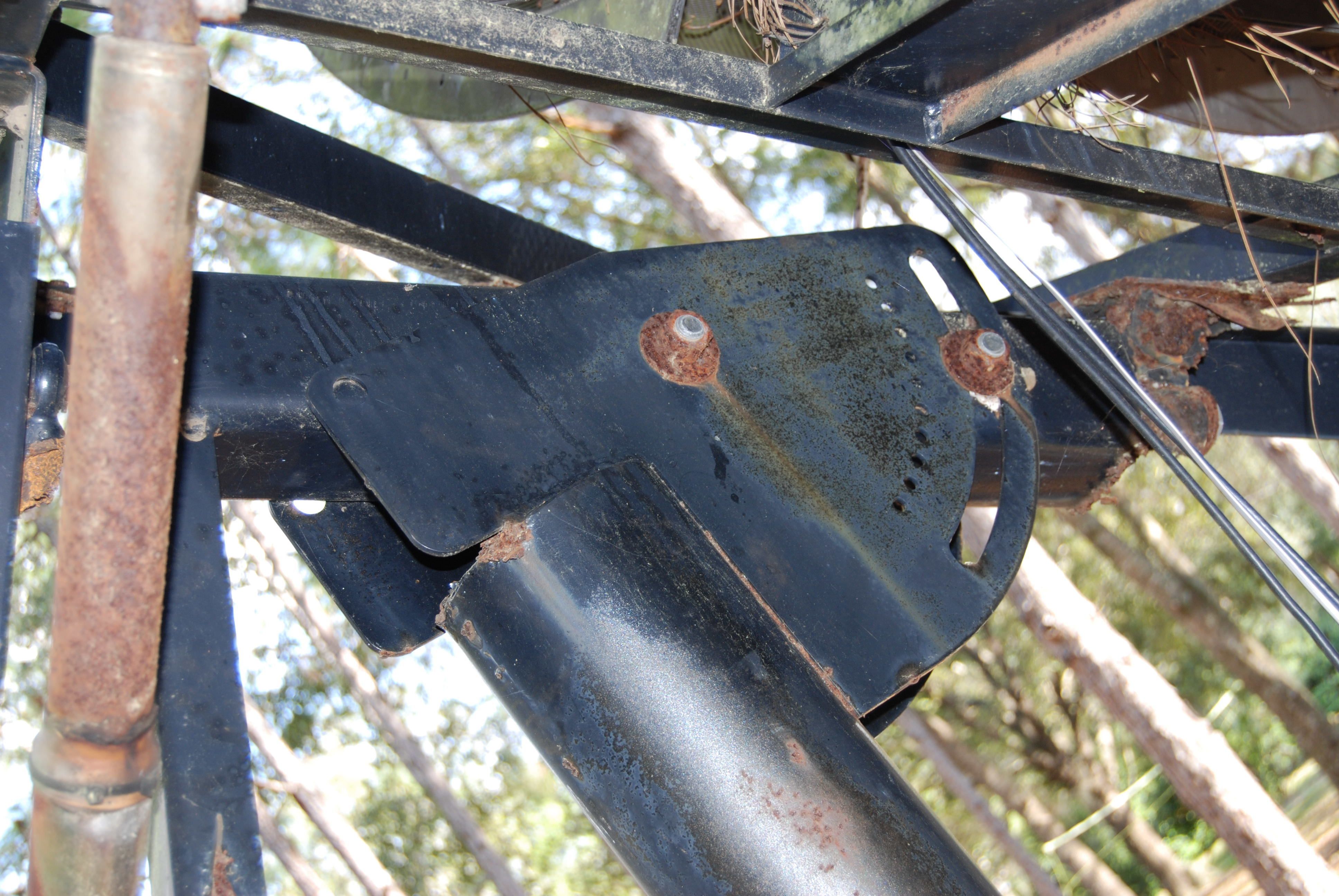

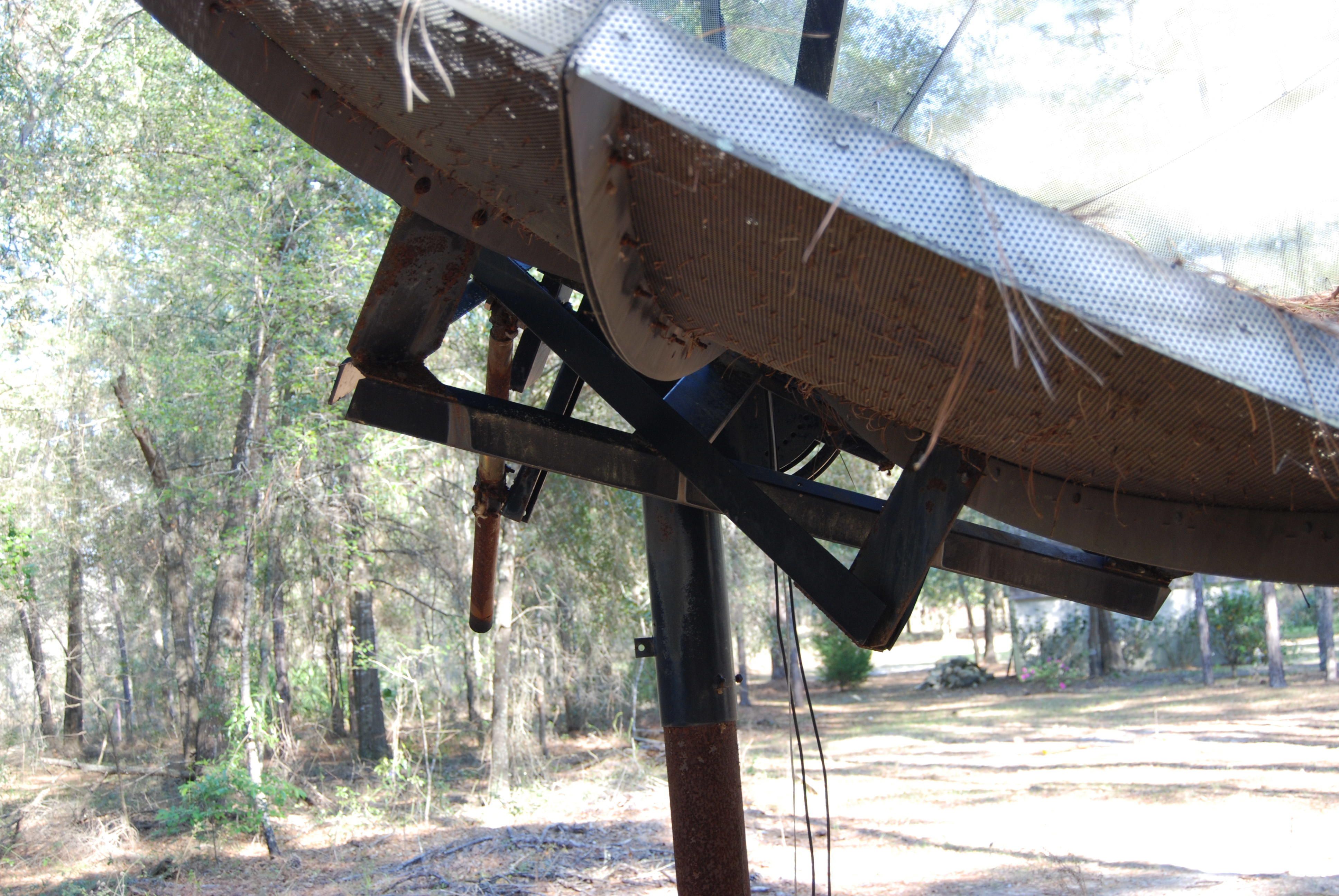

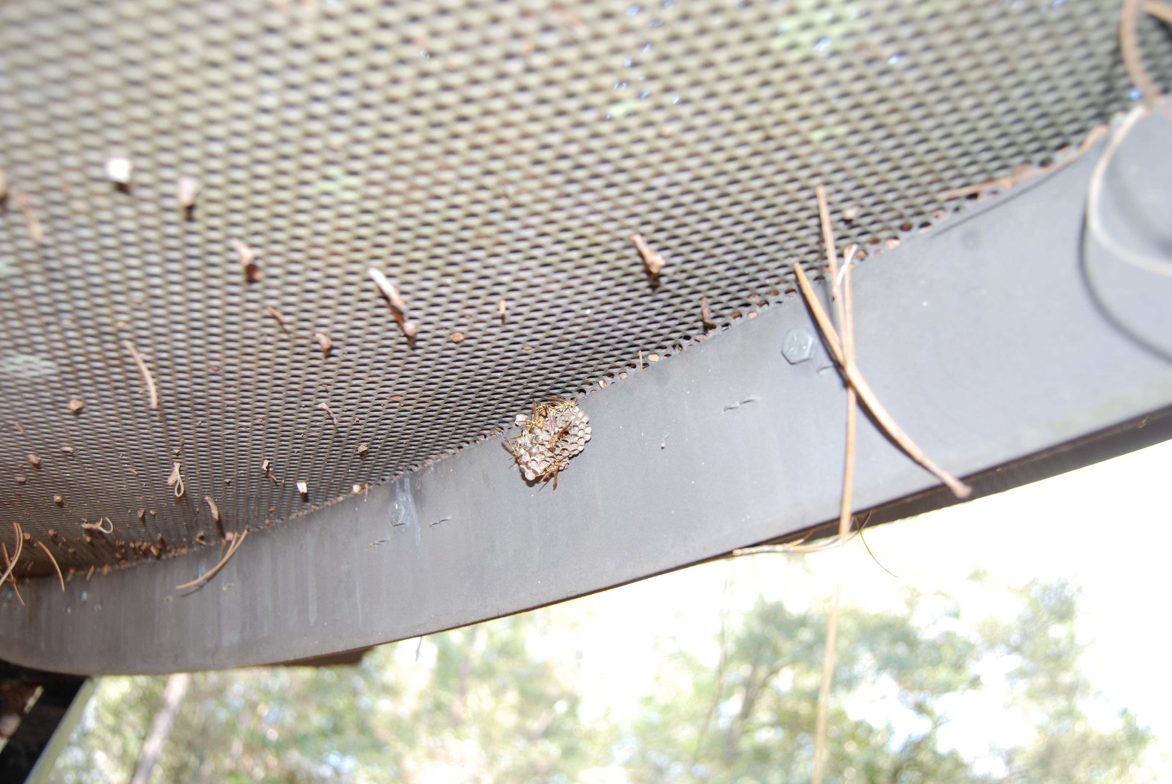

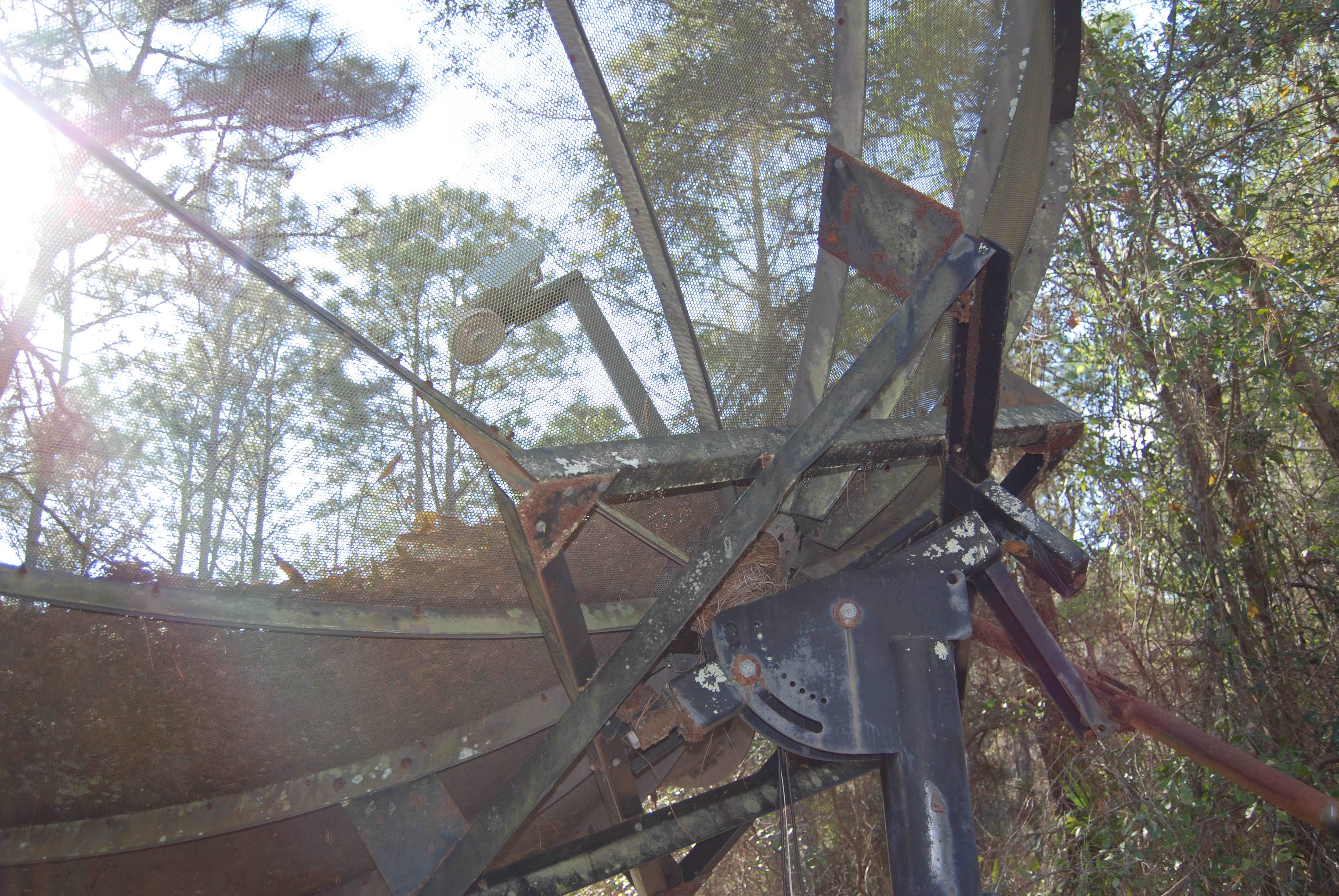

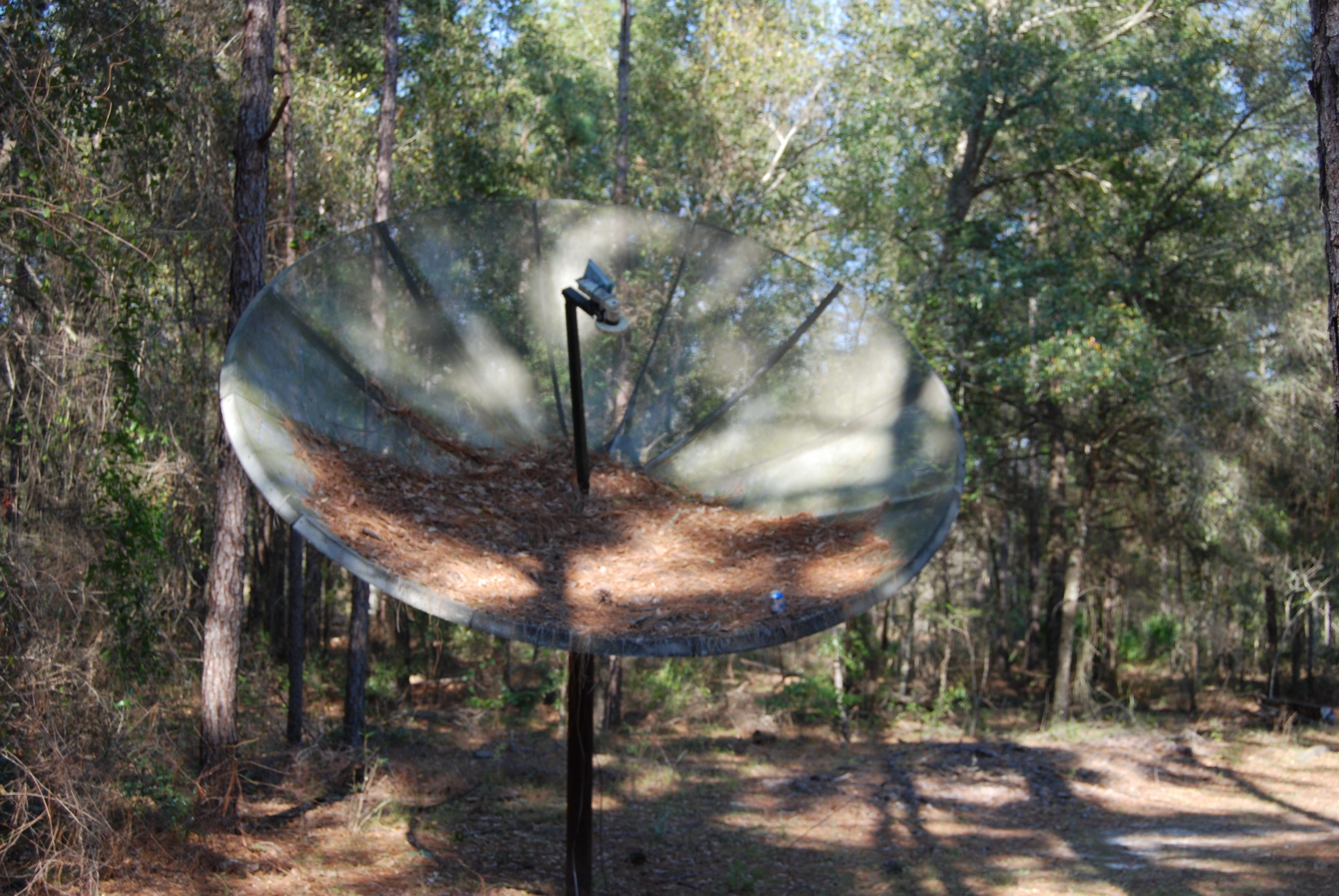

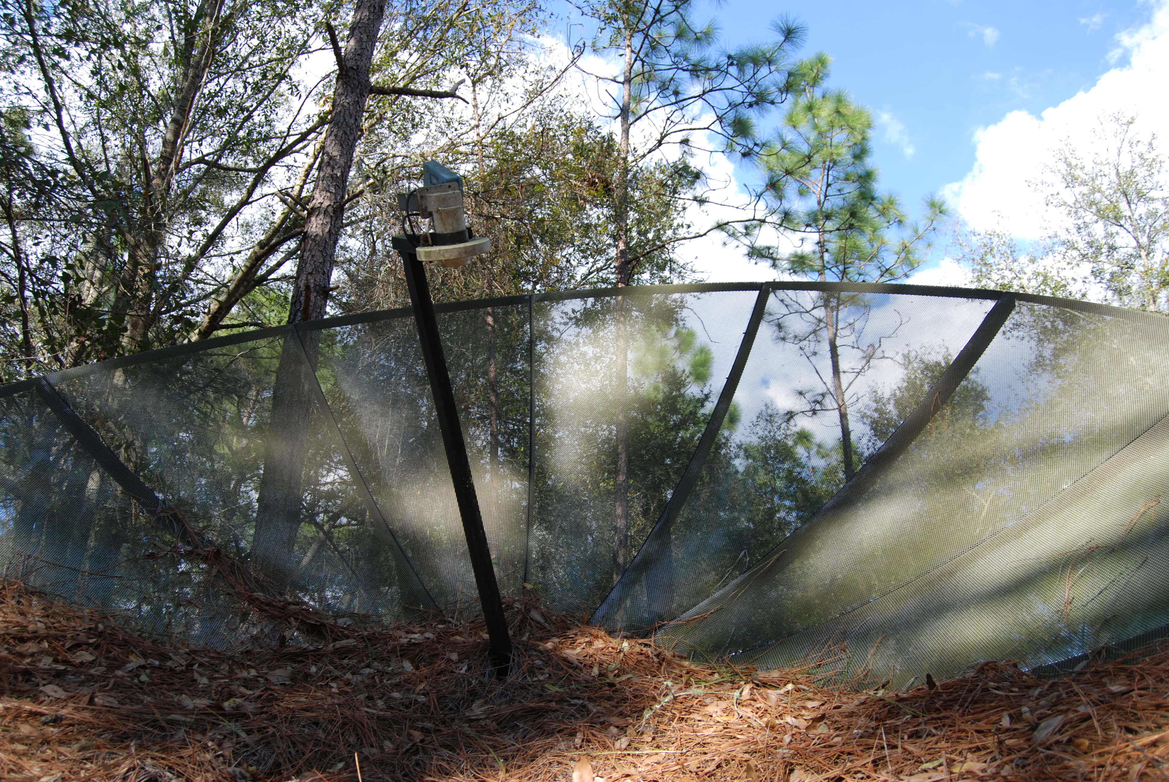

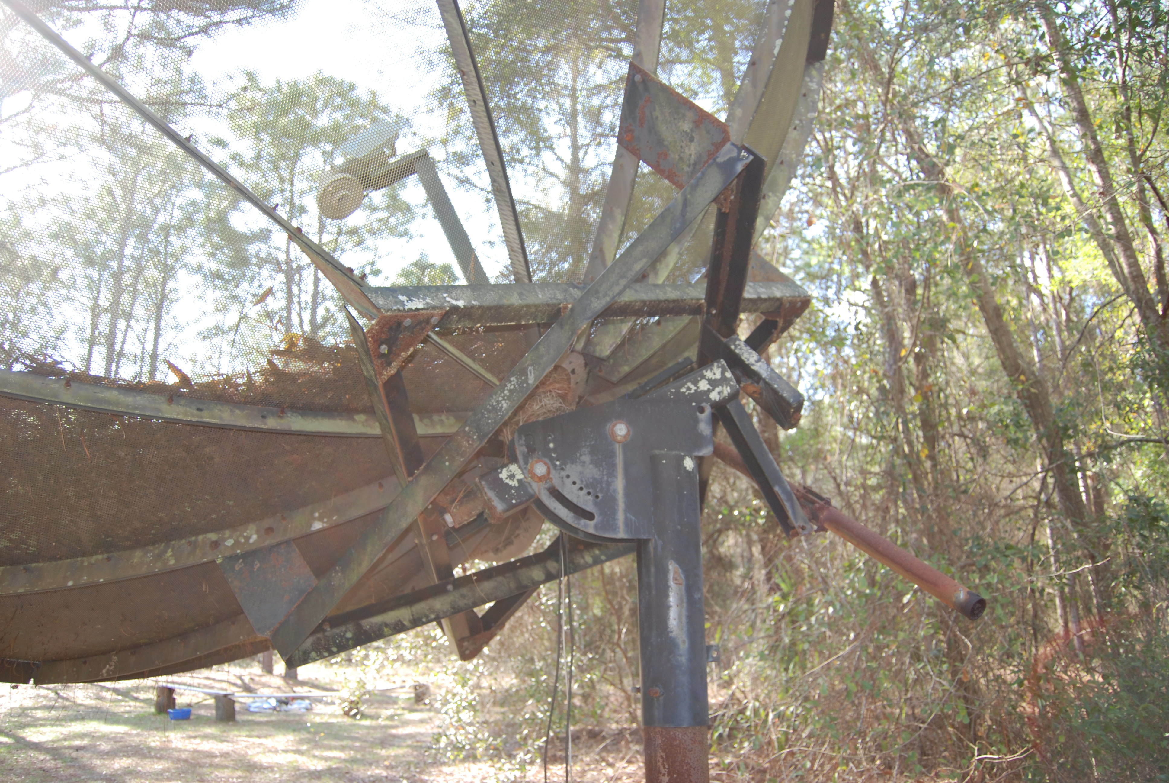

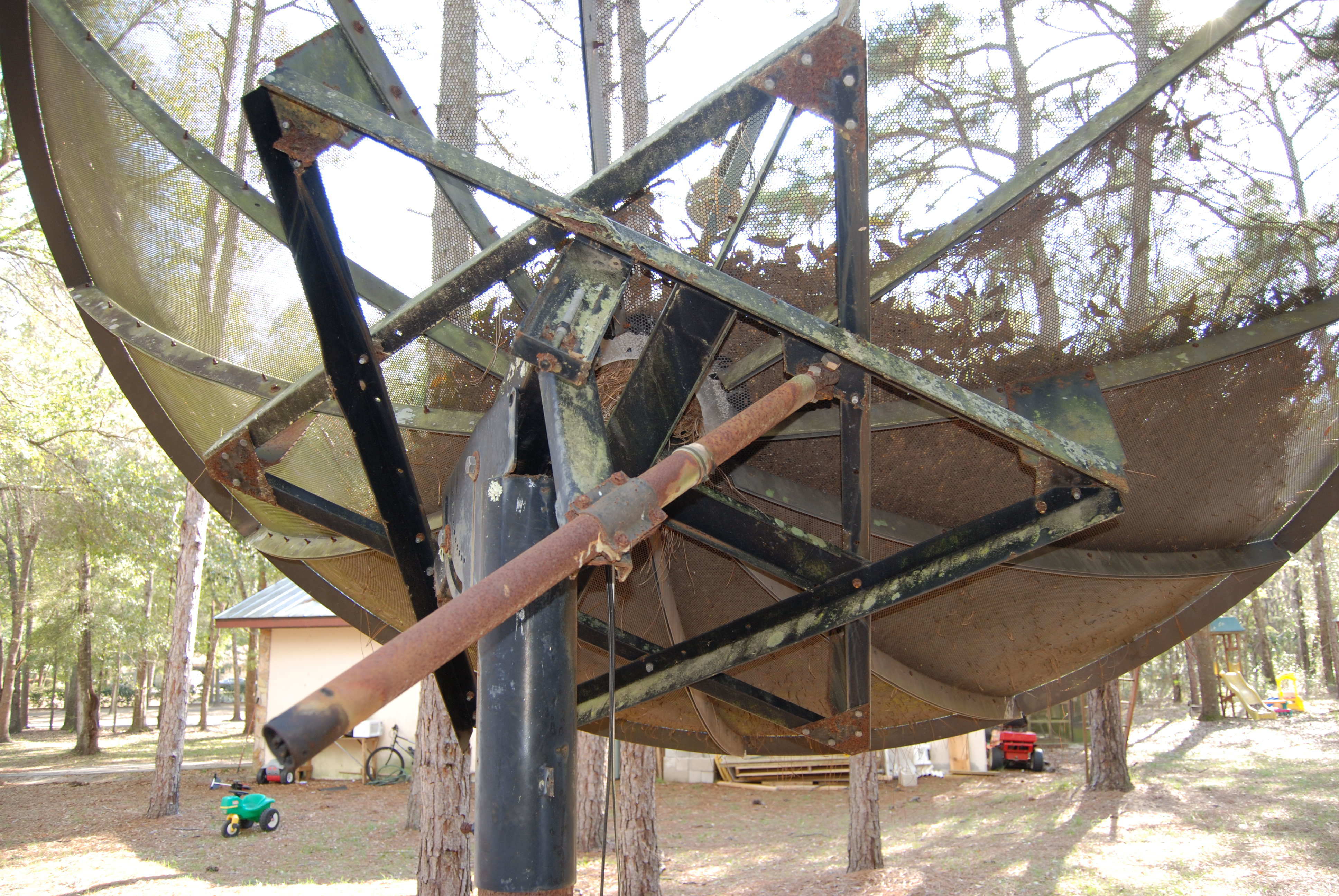

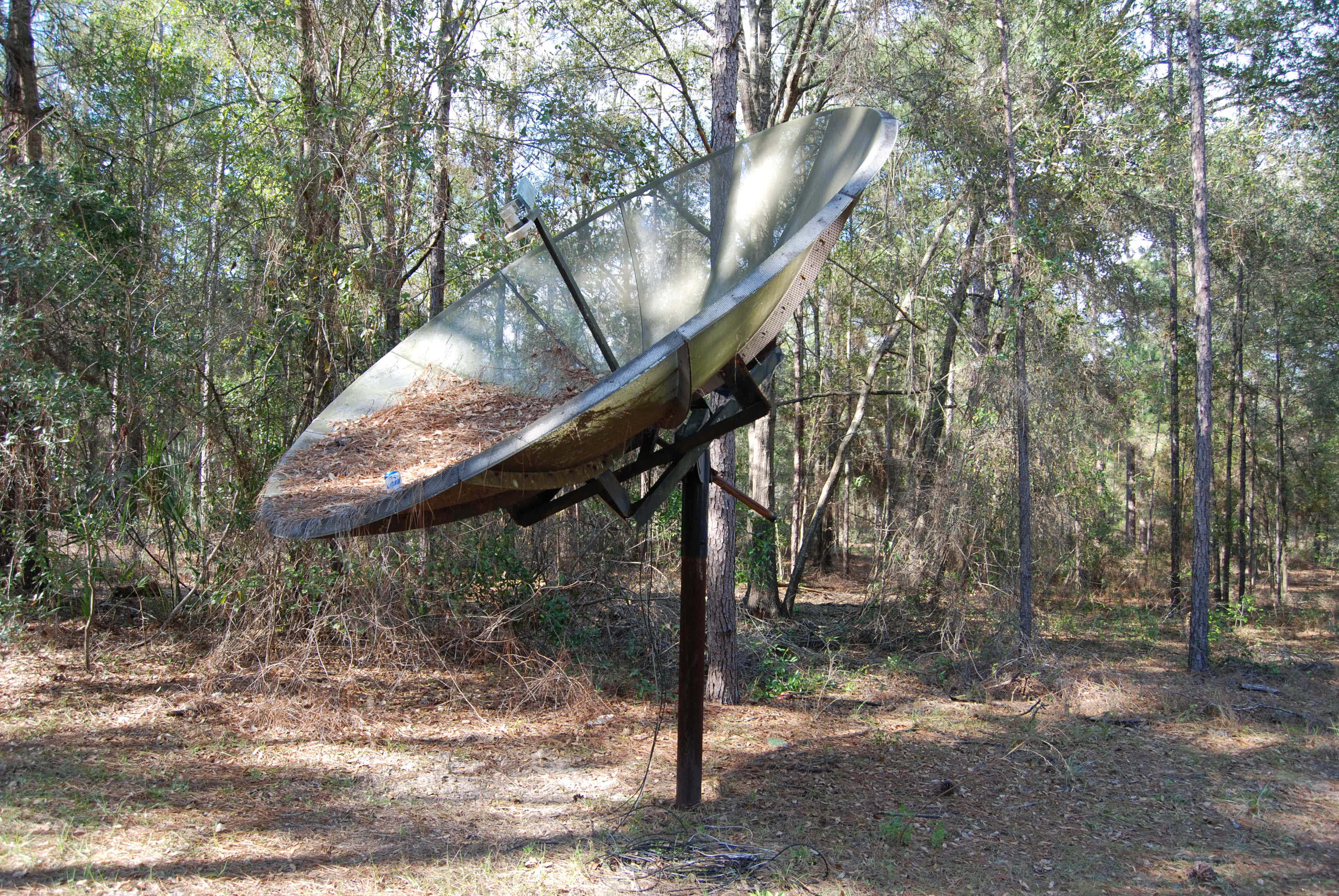

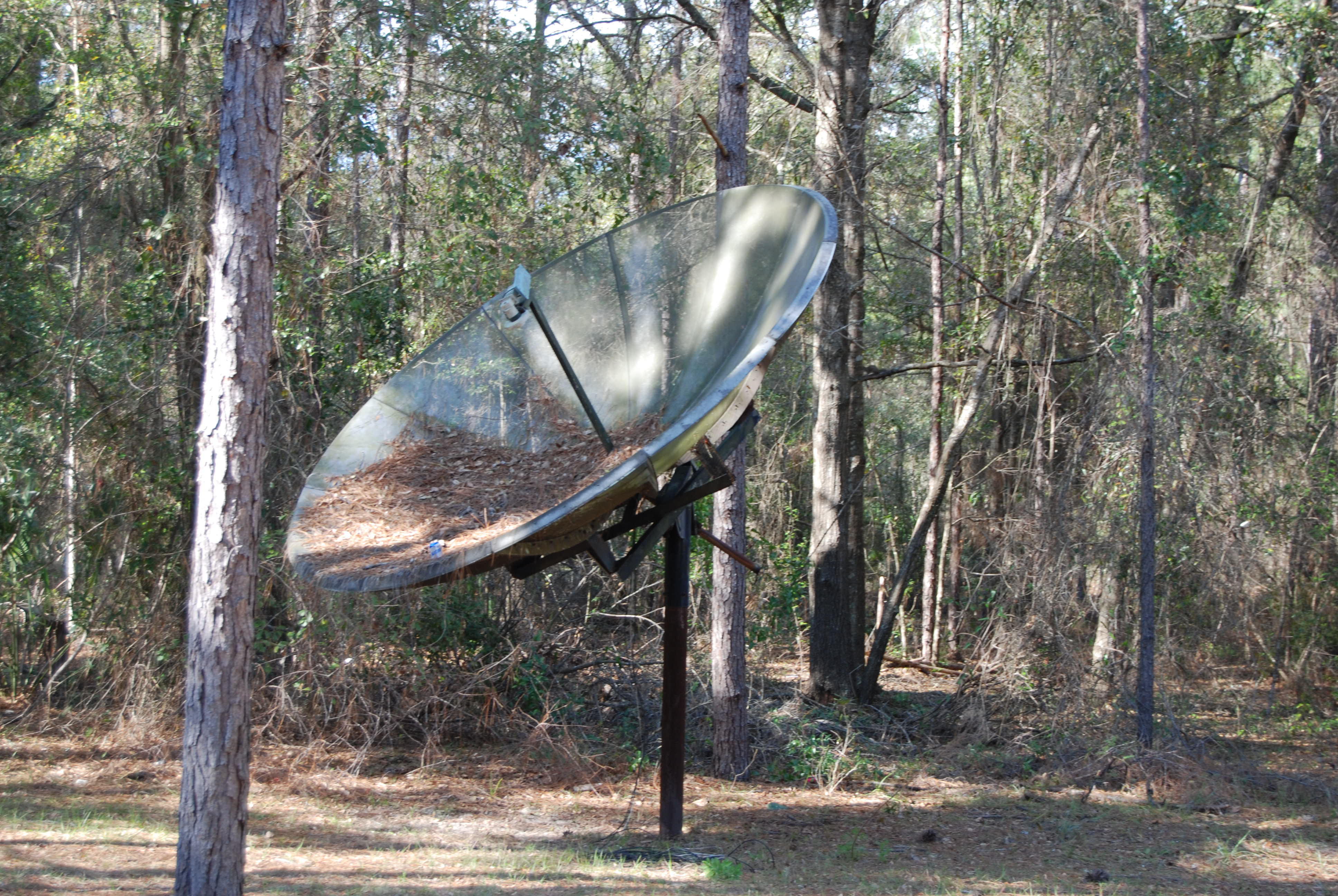

It turns out that it is a 12' dish. He's asking $200.00 for it and the equipment. I have enclosed some pictures of it. He tells me it still works?!? Looks like the feedhorn is broken and the actuator is rusted. I think I can make it look and perform new again. From looking at the photo's please advise me if I should get it and how much. I do not know who the maker of it is. Any answers would be appreciated.
I suspect there are a lot more dishes here in arkansas but i don't think i would pay for one unless it was in good shape or a birdview. So unless they are real hard to find i would keep searching. the dish listed above in post 253 is in poor shape EDIT : poor = all bolts are rusted and actuator in poor shape ... and although the owner said it still works i doubt it ( although not good to tell the owner). the feed horn does look bad ( but its just angled differently) and the lnb/lna looks older so i would suspect older equipment ( receiver) the buttonhook design sometimes sags and a few have a unique way the feedhorn is attached to the dish limiting your options on upgrading the scaler / feedhorn.
great photos..... hopefully i will be able to get out and look at a few dishes this week :)
I do not know who the maker of it is. Any answers would be appreciated. :D
Tom I don't know the maker, but it looks like a Perforated dish, kind of like some Birdview's and I think Perfect 10 made some, others also made some? Perforated dishes are some of the best reflectors out there...! Not sure if I would give $200 for the dish, cause there is obviously a lot it's lacking (no actuator in perticular), but the reflector looks great to me, and if it is Perforated, it is probably worth it, especially if you can afford it. The receivers he has, if any, could also be a determining factor on the price?
"Perfect 10" dish??? :clap
Hello Voomvoom, I didn't know who the maker of it was. I guess I'm still a novice at this, but learning. I did know that it wasn't a birdview because of seeing them here at this site. They have what appears as another circle in the middle of the dish and of course the Bird on top. I also knew from looking at it that it was well built and very sturdy looking. I tried to capture that in the photo's I took.
Also what I found interesting and may be a clue as to who made it. Underneath the dish as part of the framework are angle iron welded together. Two triangles and put together like the Star of David. Does this at all seem to be familiar to anybody here? Maybe I reaching for straws or Pine Needles, there sure is enough of them in the dish. :rolleyes: But I thought it may be some sort of a silent signature from the maker??
I'm not familiar with the "Perfect 10" dish. Are they still being made or did they go by the wayside like Birdview? Are there any images of a Perfect 10? Also is Perfect 10 as in Perfect 10 feet" Because this dish is a 12 footer. Maybe that was a silly question. Like I said I'm still learning.
I was concerned in seeing this dish and wondering if I had found a real find! Or a nightmare! The dish looks like its been holding gobbledygook for years, garbage, pop cans and a hornet nest under one of the sections. That's why I wanted to get your opinion before I gave this guy the money. It did look like it had a actuator in the back but it was so badly rusted I figured I would have to get a new one. I really didn't know what to make of the feedhorn. It looked busted to me and it looked like it was missing the cover?
He wants to hold off for two weeks before I get it. Something about that it was tax season and that he needed to find the other parts like the receivers. He also told me that when I come back that the dish needs to be completely dismantled. I was thinking of just lowering it and setting it in the back of a trailer and bring it home, about 2 blocks from me. Wouldn't dismantling it cause it to warp? He told me no as long as we gave it the string test. Then I remembered that being said before about that test. Still I'm concerned about breaking it into several sections. Your thoughts please, anybody?
I looked up for a brand new 12' dish and they go for around $1100.00+ and the thought of $200.00 wasn't bad for all that he says he has. At the same time I don't want to be giving him $200. for rubbish.
