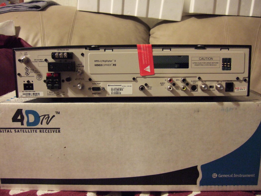

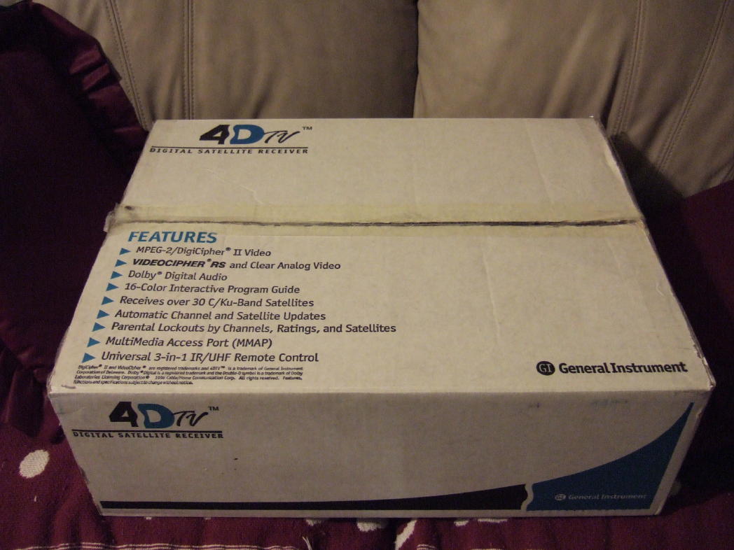

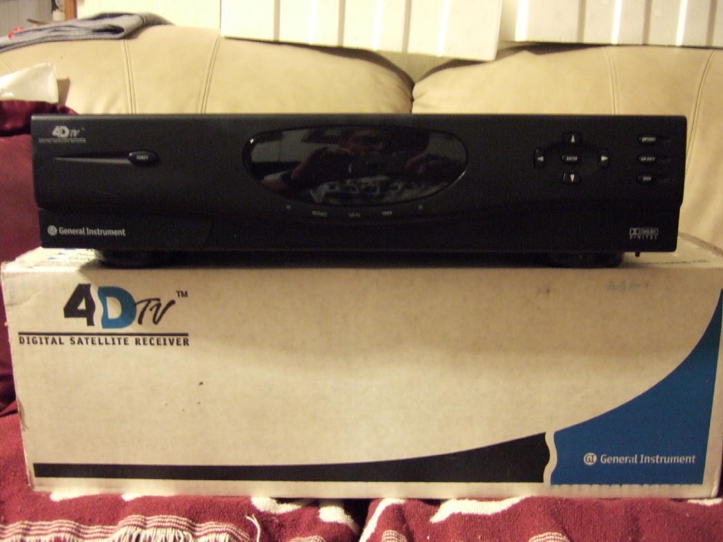

ok just an update the guy told me he had another receiver when i picked up the system but it was up at work and i could pick it up anytime , at the time he was telling me this he said it was an older receiver and he was holding an old Houston Tracker manual something like 4..... i told him ok well yesterday i called him and today i stopped by and picked it up ......... want to guess what it was?????
Bingo would you beleive an older one
a DSR-920 its also in mint condition with two remotes and manuals
hiere's some photos
now just got to get a birdview

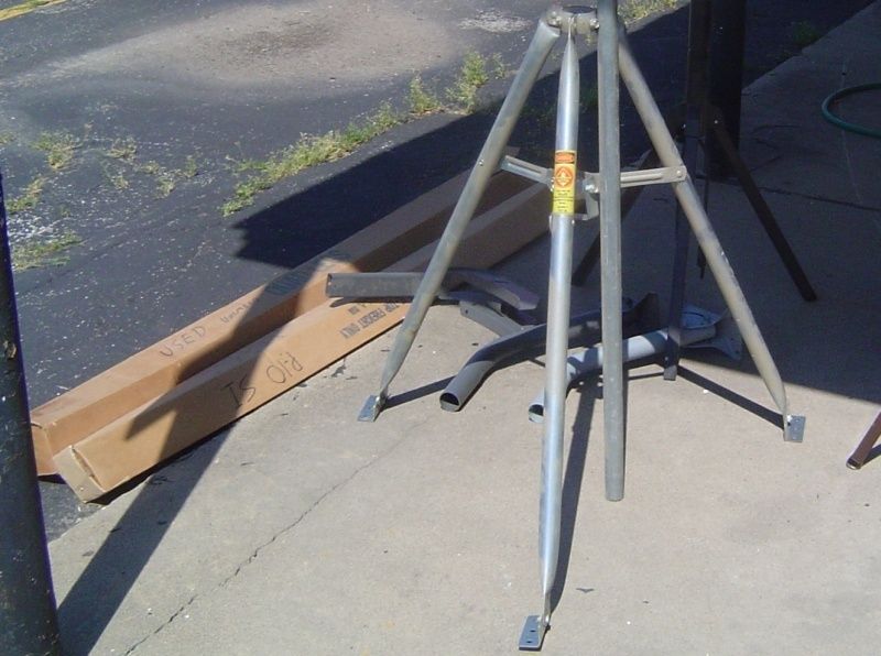

First a complete hardware and mount for a Perfect 10 7.5 foot dish including a complete actuator with an extra inside bar, and another motor/head for a Burr actuator. Everything but the reflector. :D

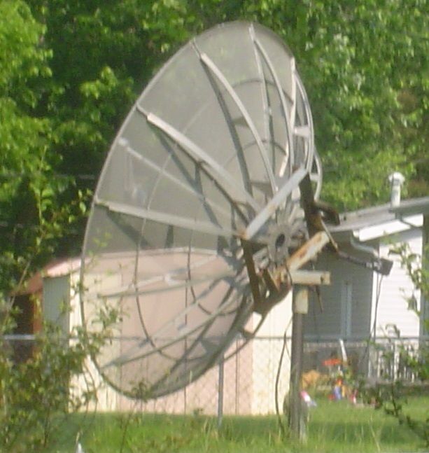

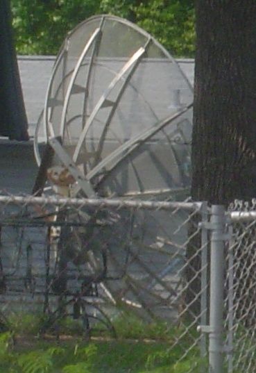

I picked up a Primestar 84e this morning and I decided I would drive around a few blocks and saw this guy.
I think this is a Paraclipse. Here are the pics:
I didn't go into the back yard and get a closer look. I left my card in the door saying I was interested and asked them to call me.
Are these supposed to be pretty good dishes?
It looks like it has a button-hook feed-horn.
