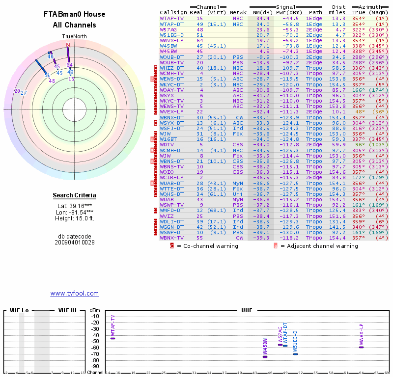

Radio signals can be pretty frustrating; a few feet can make the difference between a nice steady signal and none at all. Since UHF is all you want, I'd suggest a bowtie like the Antennas Direct db4. At 7 Miles from the towers, I get EXCELLENT results from a 2 bay Eagle Aspen DTV2BUHF which can be bought for $13 online. The db4 can be had for under $30. By the math, the 2 bay should work, but I'd invest in the 4 bay just to be sure.

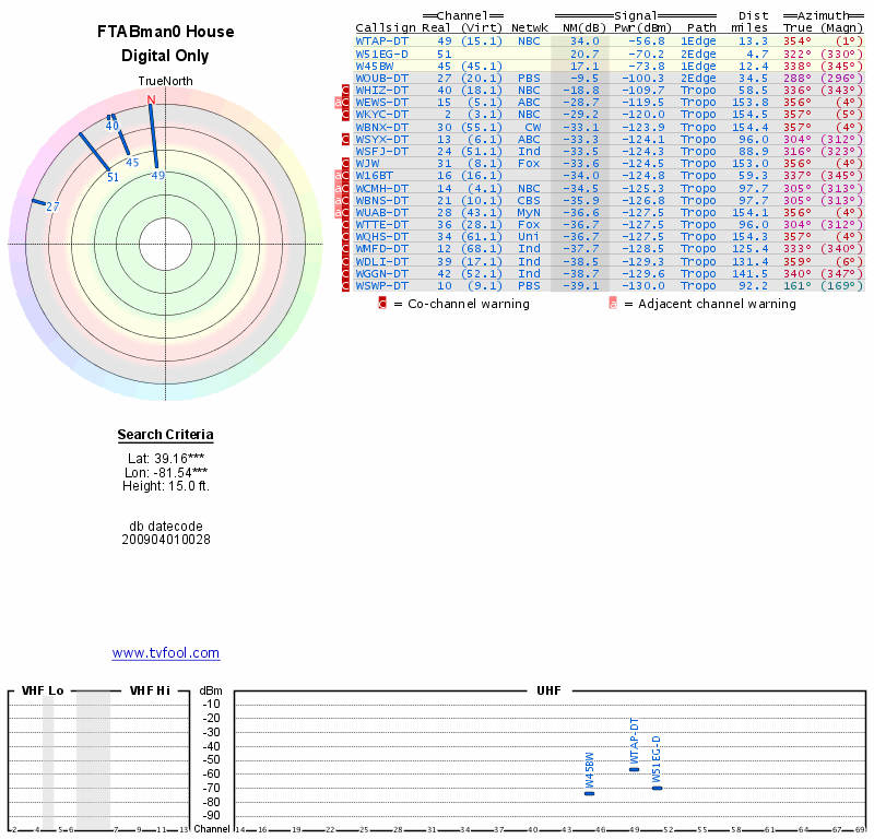

In looking at the TV Fool output you attached, only WTAP is going to come in reliably with an indoor antenna, and the Antennas Direct DB4 is an excellent choice for indoor use.
But the only way you will pick-up PBS (WOUB) is to spend a lot of money on an outdoor antenna and pre-amp. If you are willing to go that route, go with Antennas Direct 91XG ( Antennas Direct 91XG UHF Antenna (91XG) | 91XG [Antennas Direct] ) and the ( Channel Master CM 7777 Titan2 VHF/UHF Preamplifier with Power Supply (CM7777) | CM7777 [Channel Master] ). The higher you can mount it, the better.
Adding a rotator ( Channel Master CM 9521A Complete Antenna Rotator Kit with Infra-Red Remote Control and 100 FT Rotator Wire (CM9521A) | CM9521A-100 [Channel Master] ) allows you to peak reception for a specific station. You could aim it at Charleston to see what you get.
After you add coax ( Wire & Cables | RG-6 Cut-to-Length | Solid Signal ) and mounting hardware ( OFF-AIR TV Supplies | Mounting Supplies | Solid Signal ), you are up to $300 or more.

It appears you are down in a valley. That is really your problem.
From up on the hill to the south of you you begin to get NM(dB) values above zero for stations south of you.
Look into trying a passive (maybe even an active) repeater as described here: Passive TV Repeater
Place it on the hill south of you and see what it gets you. Start with one channel and expand as needed.

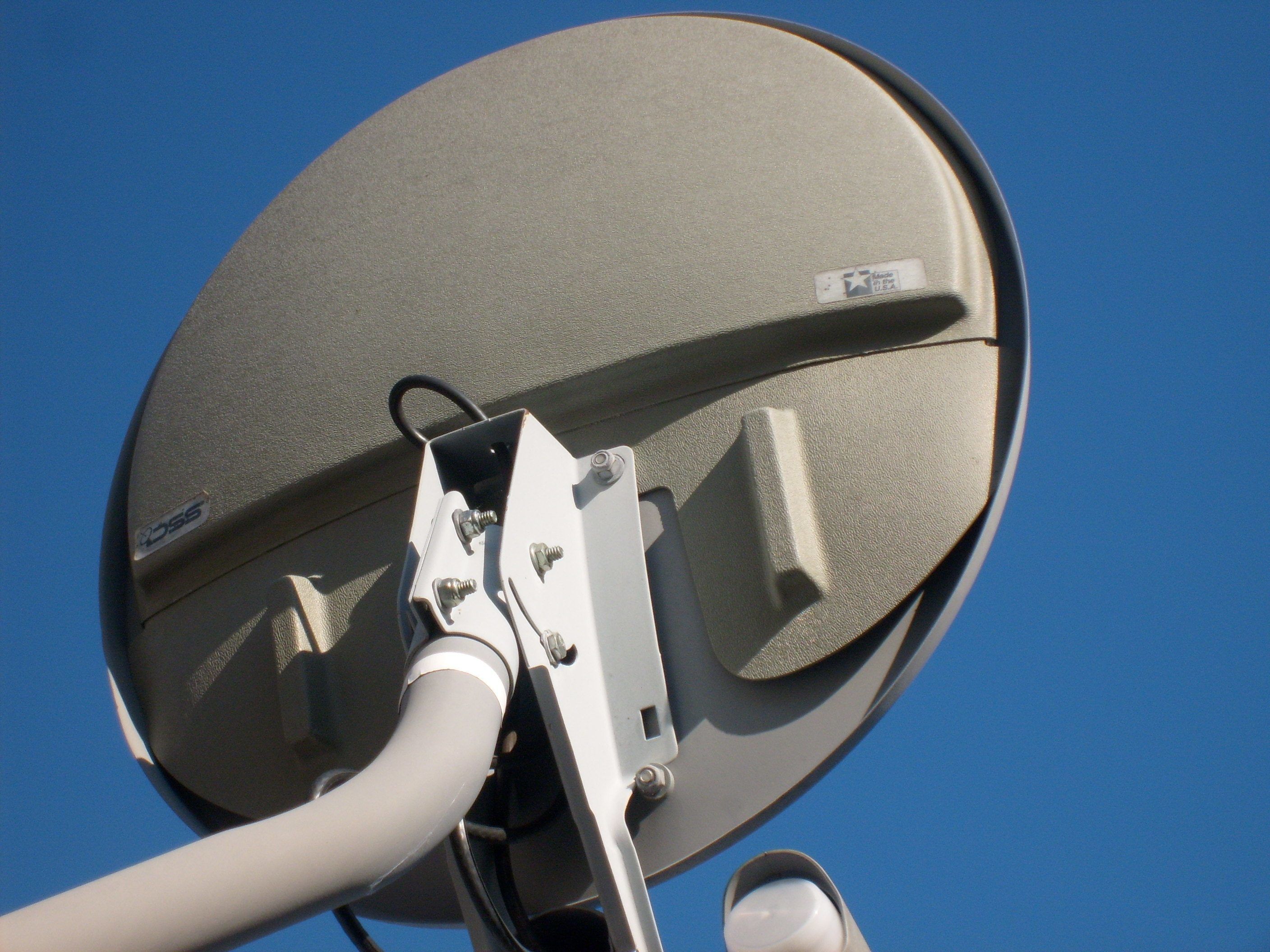

Starman, I did try to make one with little to no success! One of those ones you see on the TUBE using copper wire and a two by four. I must admit it was fast and not really close on measurements but very close and it seemed still not to work. One would think that being no further away from the transmitter from my local station that it would have done better than it did. I got about the same as the two aerials that came with the old CRT TV sets.
Do you have an assembly schematic of the one you built for your neighbor’s house? Would like to see what you used and how you assembled it and what I done wrong on my first attempt. I am just in a valley here and that is my first strike! I have one of those old back of dish OTA antennas on the back of my E* dish and just remembered that, I wonder if that could be a try and see. I remember I bought that for analog reception and it did bubkus! I will have to try that and see. Thanks for your input dude, glad to bump Ideas off you again! :up

UPDATE SINCE LAST POST:
I tried the DSS back of antenna and I am getting all Parkersburg Channels from WTAP but pixilation and all Channels of WOUB PBS that is 30 miles away on that antenna! Now, the channels are very choppy and not viewable for they break up, but I was really surprised that they came in at all.
See Picture in post 12
Note too that the Satellite dish is pointed to 61.5 West and the back where the OTH antenna is not quite faced in the right direction but this says volumes! Maybe if I get or build a decent antenna that it may be possible to get some of the HD stuff in my area! I am really excited that this old 98 antenna picked up anything at all. This looks promising indeed!
I bet I get a medium range or long range UHF antenna it would be great! Adding an amp: Priceless! :up Keep you guys posted!!
