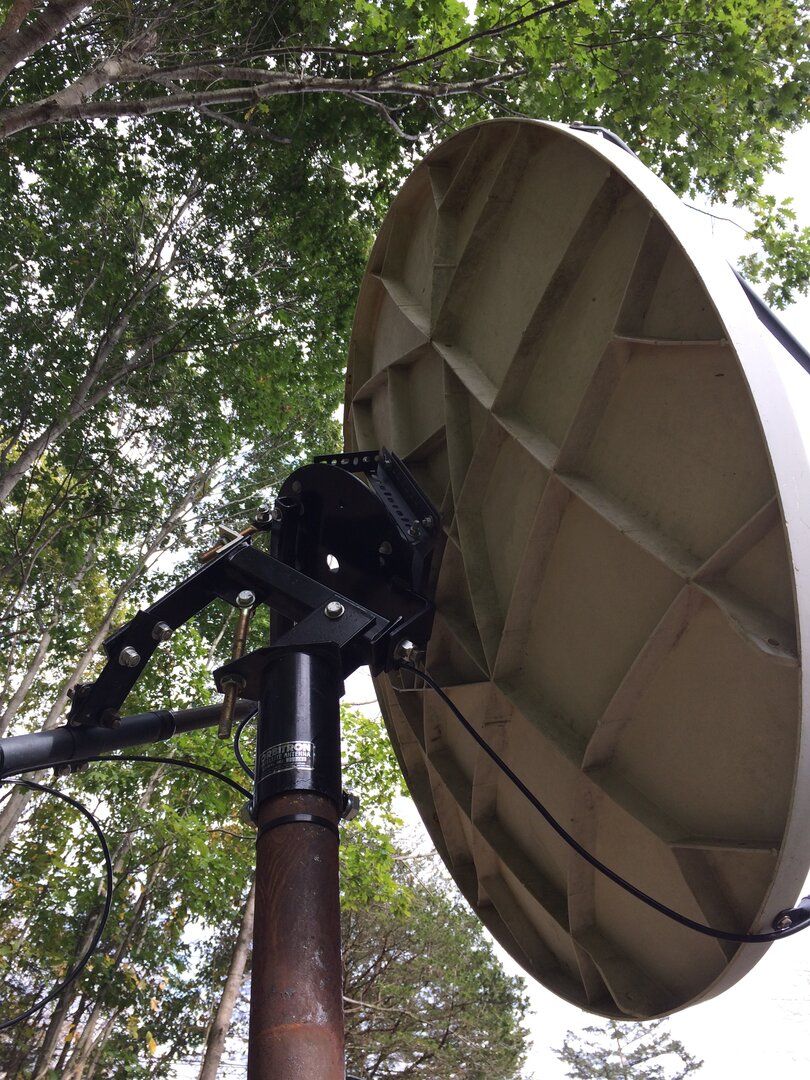

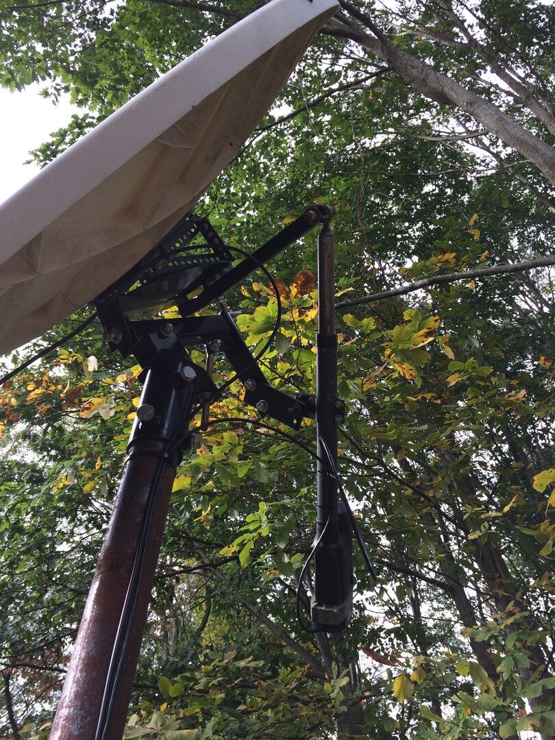

That's what I did... Old, heavy 1.2 meter fiberglass dish, new old-stock Orbitron polar mount, VonWeise 24" actuator, some angle iron, and a bit of creativity! I can cover the arc from 11W to 123W (I could probably squeeze a couple more degrees but tree obstacles make it not worth the trouble... I think I could actually see a Ku beacon on 8W, but barely)
(on the pictures the actuator is an older 18" VonWeise)
