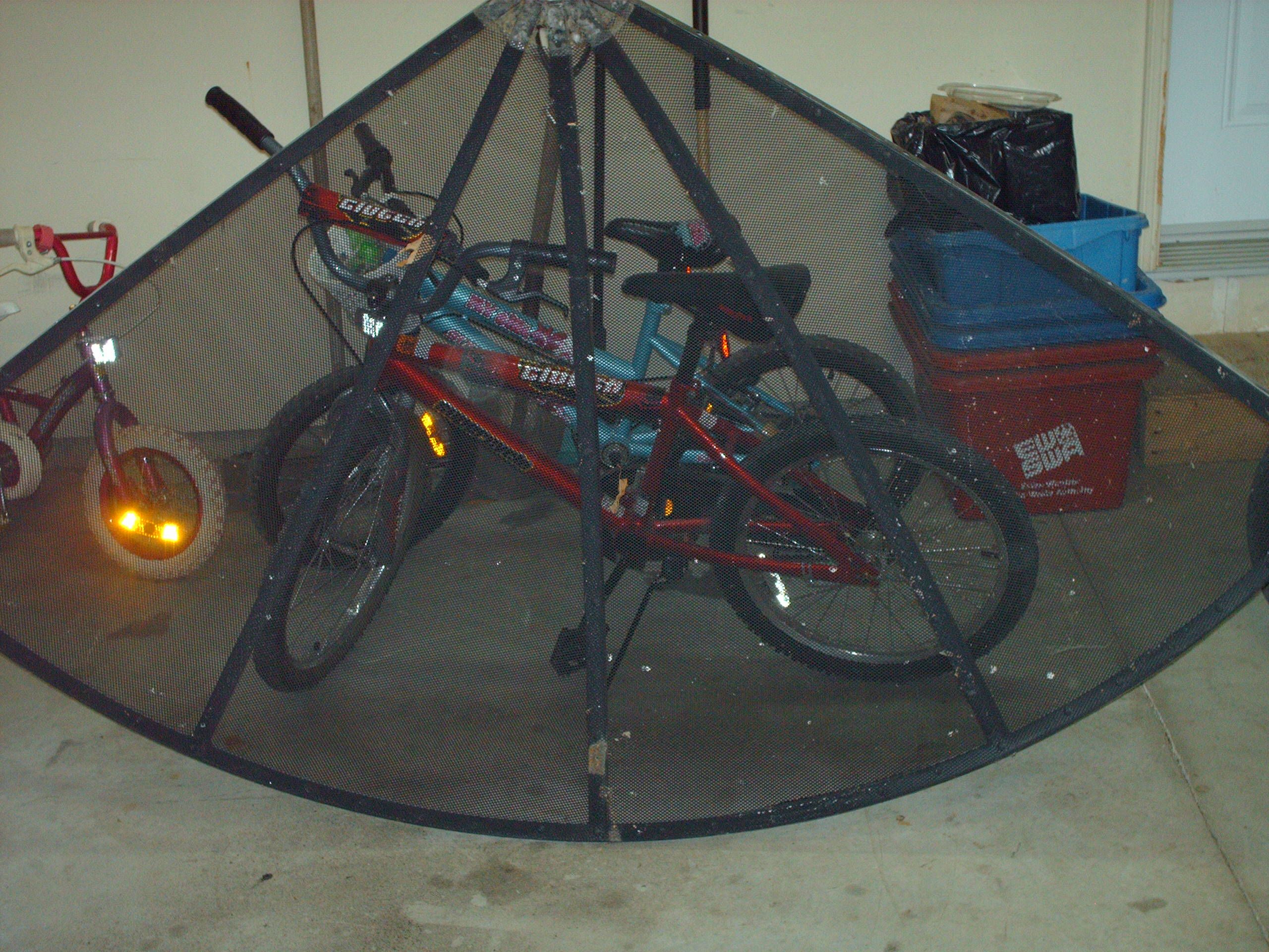

I'm in the Milton, Ontario area (just outside of Toronto) and due to space and aesthetic considerations I'm thinking an 8' mesh would be best. I did some searching and found one for sale that's a little further away than I would have liked, but on the plus side the dish is already apart and has been in storage for a number of years so I don't have to go through the trouble of taking it down. The dish was supposedly still functional when he took it down - he took it down because he moved but never got around to putting it back up at his new house.

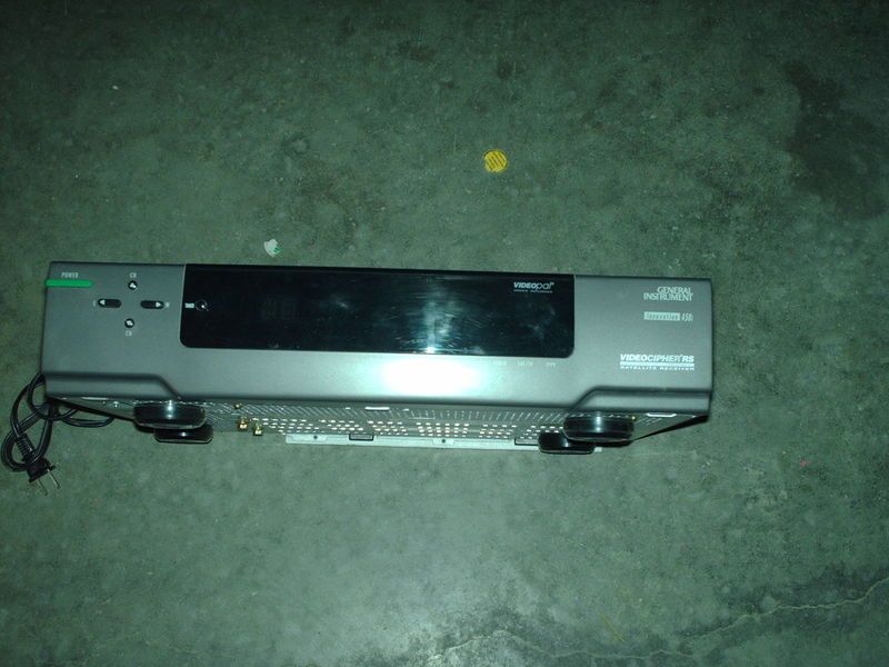

He says he has all of the parts except it's missing most of the bolts, but that shouldn't be a big deal to replace if that's all that's missing. He also has the receiver (minus the remote) but I have no idea if it's still useful for anything. I know I'll need a new receiver to get the DVB-S2 broadcasts so I was planning to pickup a microHD anyway.

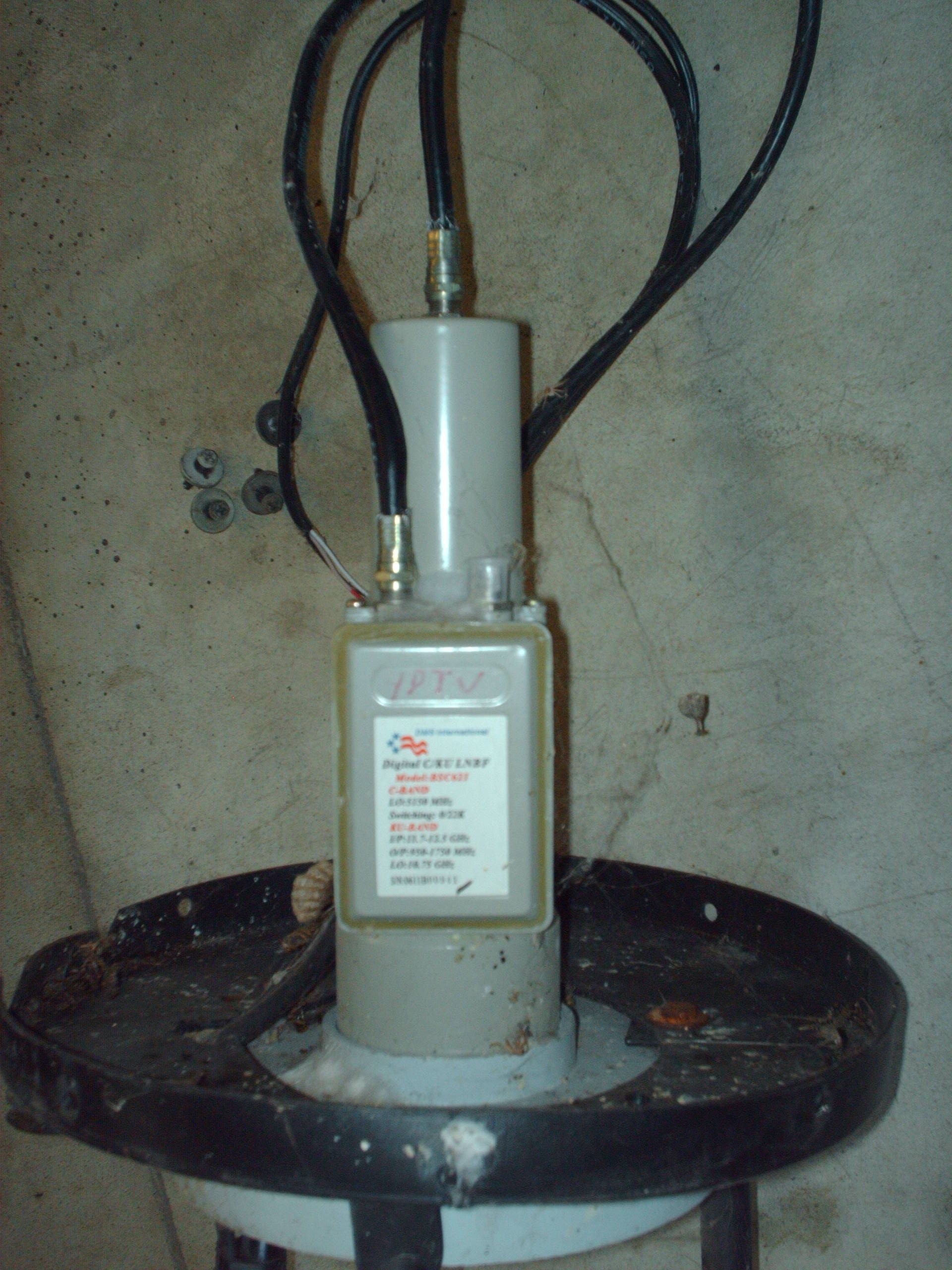

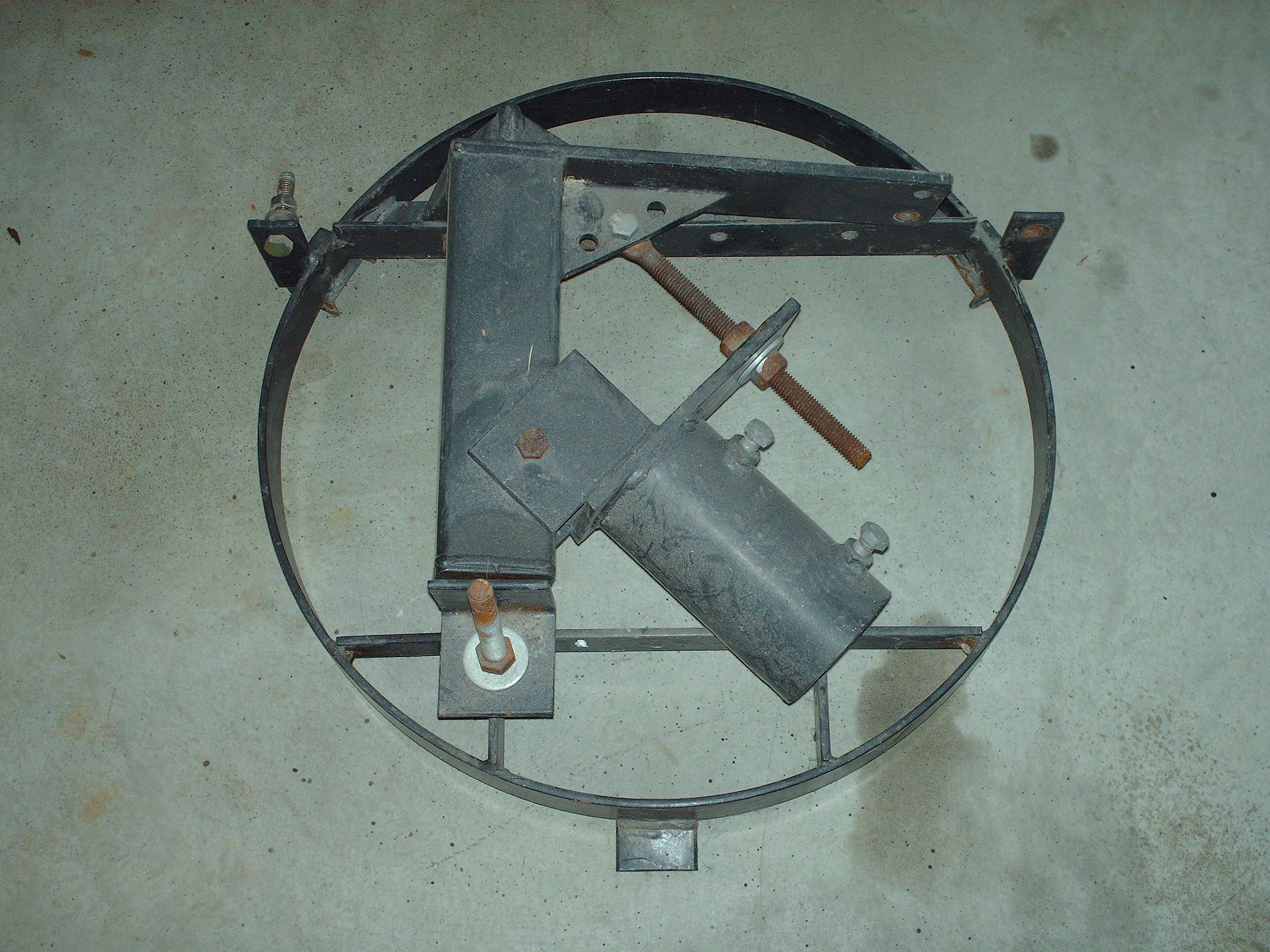

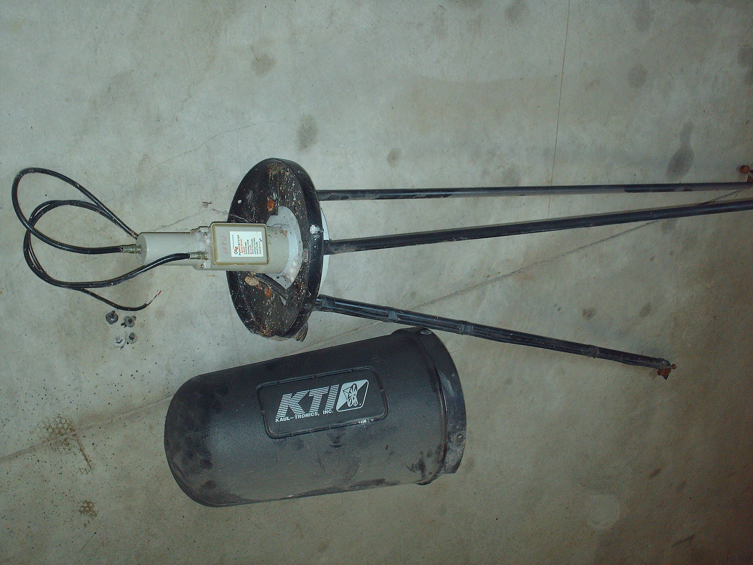

I got him to send me some pictures which are attached. He said the panels measure 4' x 79". Can anyone tell me if it looks like all of the parts are there and if things like the LNB and actuator should still be usable?

Yes as far a I can tell from the photos everything is there. Also that LNBF would be usable as well. The old GI receiver would not do much for you. I think there is 5 analog channels left that you could get with it. IF the price isn't to bad I would go snatch it up. Then ask all the questions you need and we will help you get it up and running.

That receiver might work for a dish mover, but without a remote it may not even do that, unless it has east/west buttons on the front panel, I think most do.

Best I can tell from your pictures, it looks fine.

That polar mount is exactly like the one on my SAMI dish. The LNB mount looks the same too. That dish mover looks like the Super Jack my SAMI has on it also. That dish I have is 7.5ft but it does do a fairly good job here in Virginia. I am going to replace it with a 10 footer soon though.

The dish looks to be complete, but I'm inclined to agree with phlatwound. I have never used an 8 foot dish myself but from what I have heard around here and on other forums, It may not perform well for the S2 signals (or ku). If you will only have one dish it should be a 10 footer. The receiver will move the dish just fine, but so will a vbox since you don't need a polarity controller with that feedhorn (looks like a bsc 621 for both C and ku band).
