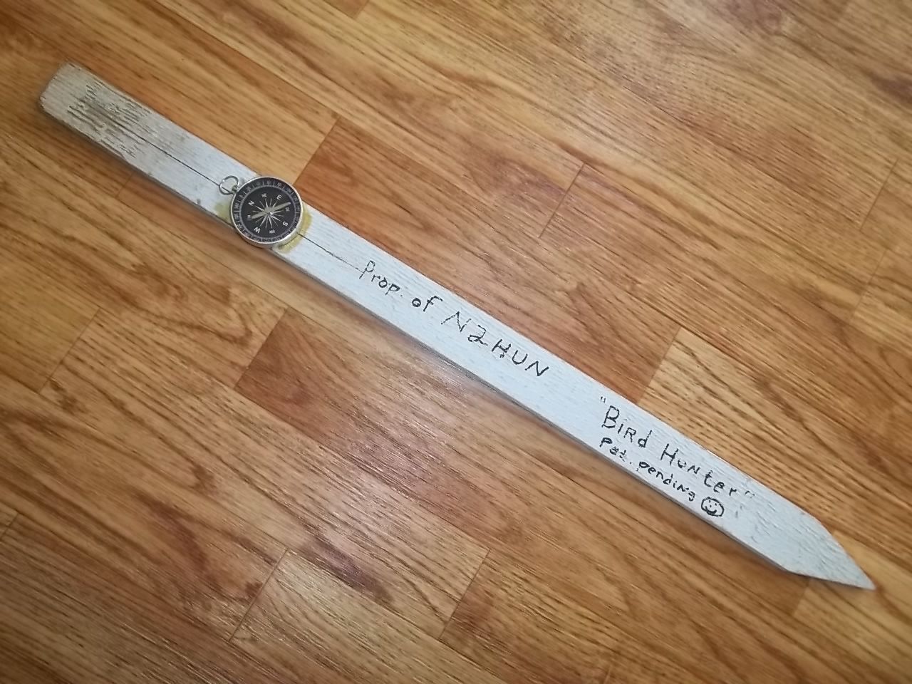

Make one of these for yourself out of a fence picket. First draw a line exactly in the middle of the piece of wood lengthwise. Then get a compass and glue it so that magnetic South is aligned with the pointy end. It's better than working with a tiny round compass.
I call it "The Bird Hunter."
Works equally well with other color paints :)
Not geographically accurate for finding Santa Claus though.
