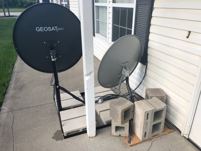

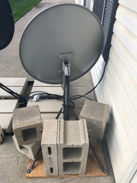

I have a dedicated dish fixed on 87. I've had it mounted on a J-pole with "wings" attached to a board. It was only meant to be a temporary fix; I need to either mount the mast and pole on something that won't warp and rot, or put it on the roof. I'd prefer to keep it close to the ground, but I don't have room for another non-penetrating mount. Any ideas/suggestions?

Here was my old setup when it was stacked.

plan A- Drill and bolt pole direct to the concrete (sidewalk?)
Plan B -Find the biggest (heaviest) concrete patio block(s) and bolt the dish (J-pole) directly to that. That way you are not drilling into the sidewalk and you can move it if you have to. Think I have seen 36X36X1.5", should be more than enough to hold a 36" dish as long as the pole isn't too high.
I don't think the cement panel in the link above would hold much.
Would probably need special concrete-boring drill bits for cinder block drilling, correct?
Hardware stores often have kits with a cement drill bit and bolts. 1/4" should be fine for a small dish. Might require a hammer drill though.
