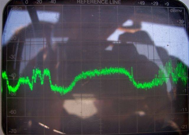

the loop thru is good because that is where we hook out spectrum analizer while the Upcomm receiver is on. 100_5760RTV.JPG

the loop thru is good because that is where we hook out spectrum analizer while the Upcomm receiver is on. View attachment 69457
The loop throughs on my receivers were good also, but as I said above the master receiver had to be off or on standby for the slave to work. :) I think that may be your problem.
If you would list your setup parameters maybe we could see an issue there. Sounds like you should be getting plenty of signal from your dish.
