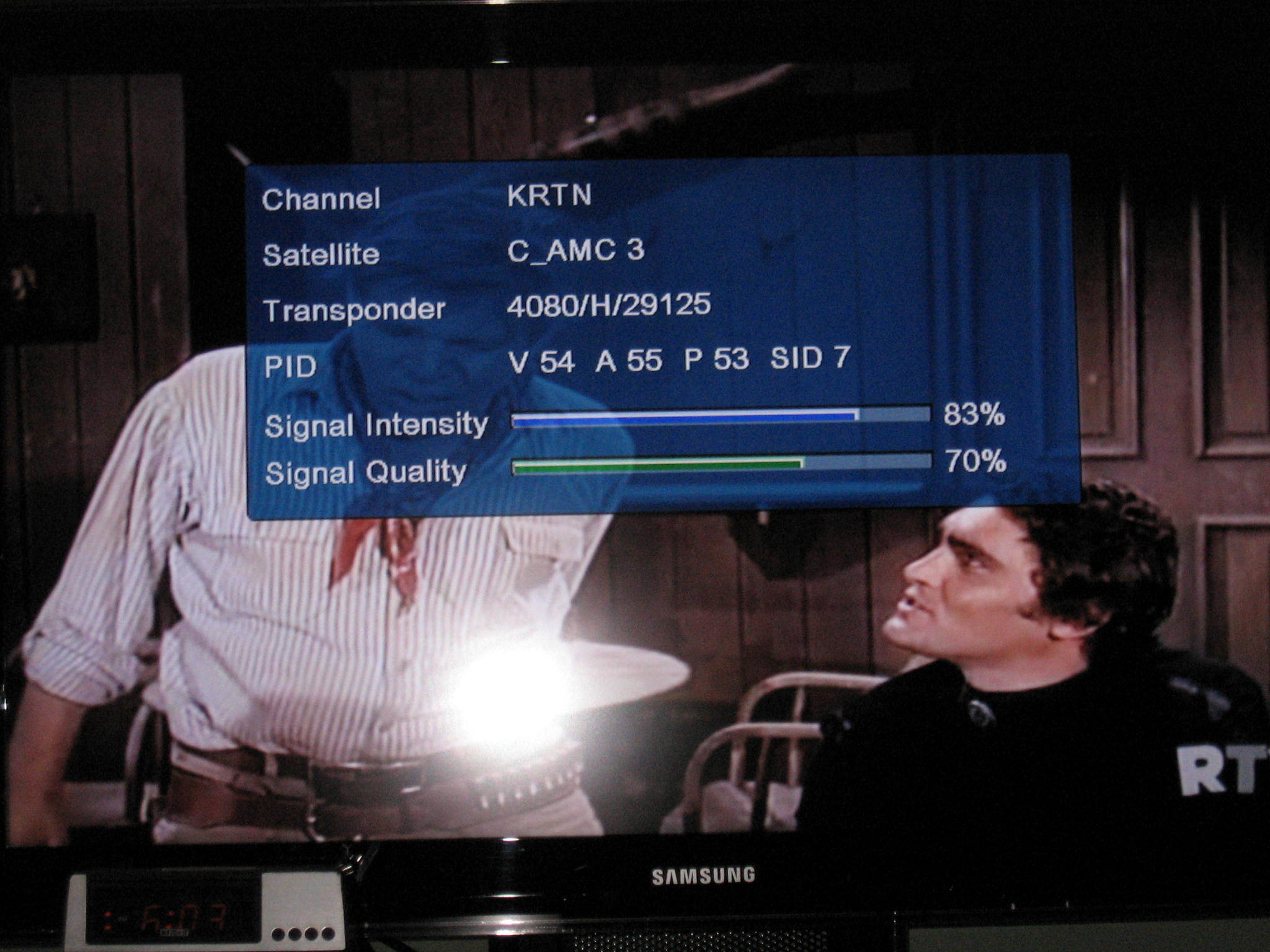

I bought my c dish late last spring from sadoun.The lnb i have is a dmx 741 which has been serving me well since i got it with the dish.It did take me awhile (weeks infact) to get to aligned just right to work well with both c and ku.Since the RTV signal on AMC3 is in dvb-s2 it can be alittle bit of a pain to get it in with a 6 footer but it can be done.For me it was my dish elevation that was slightly off that caused me not to get RTV when i first started out.What i would do is aim the dish to AMC3 then set your tp 4080h29125 then while at your dish monitor the tv screen an slightly lift the bottom of your dish or push back the bottom and see is you notice any difference in the Q Sig.Its only a slight change in elevation or a slight move e or w to get a good s2 signal.If you haven't been getting any s2 signals then i would think your dish is slightly off alignment.I dont get all the s2 signals that are on the c and ku bands but i do get a large percentage of them.Take your time!like i said before it took me weeks to get it right.Heres a pic of my RTV signal on my solomend.

So my elevation is off not my declination. Ok I learn more everyday from you guys. I don't know if I've got any s2 or not. Whats a good s2 signal you have gotten besides rtv mux
