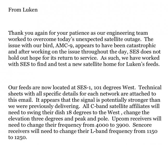

From what I am hearing it appears the bird is lost.
Luken is working on moving its channels to another bird now, when I know more I will pass it along.
