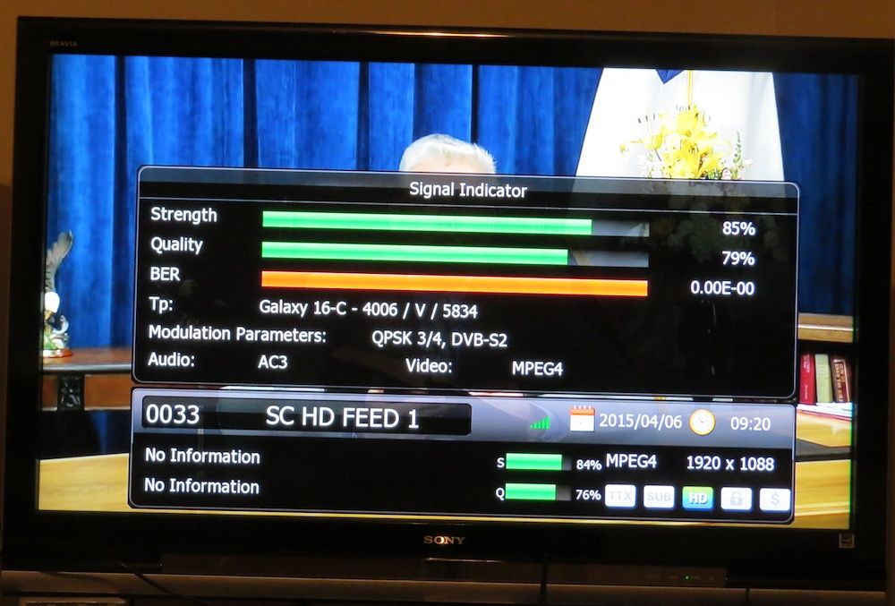

I tried receiving Shepard's Channel on my 3 receivers. It scanned in without any trouble on my new X2 Premium Mini and my TBS6983. I have attached a photo of my TV showing it on the X2 Premium. Note that my X2 is displaying GMT, not local time.
The Amiko Mini HD SE did not get it in the blind scan. I don't have an Amiko A3 or I would have tried it too.
I hope that my observations will help in troubleshooting this.

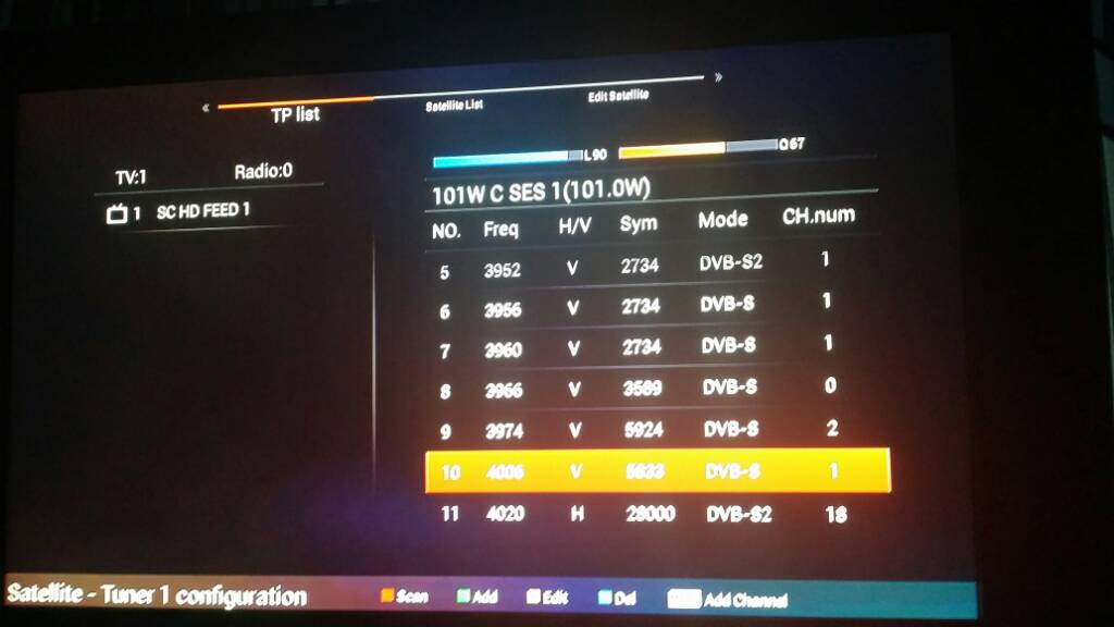

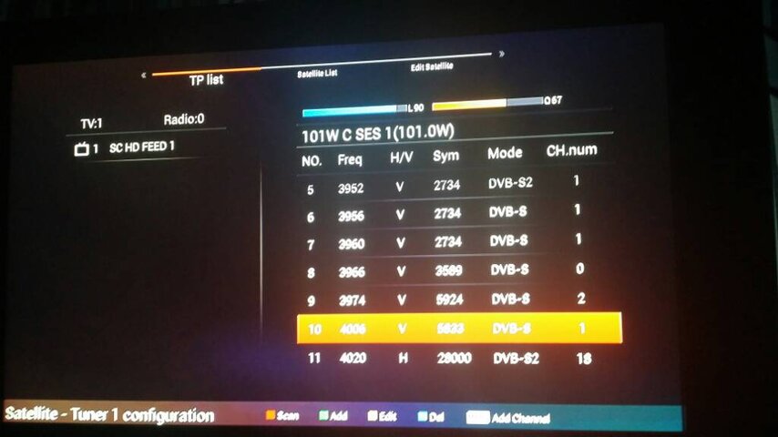

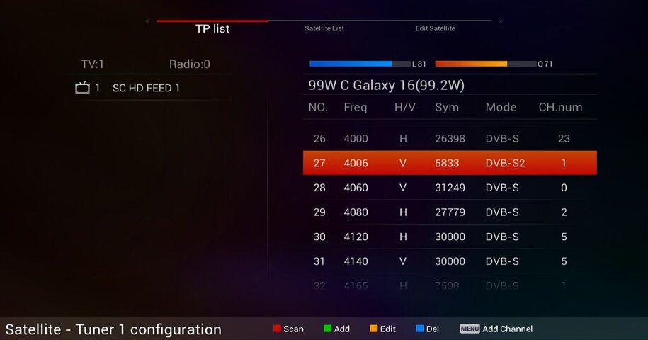

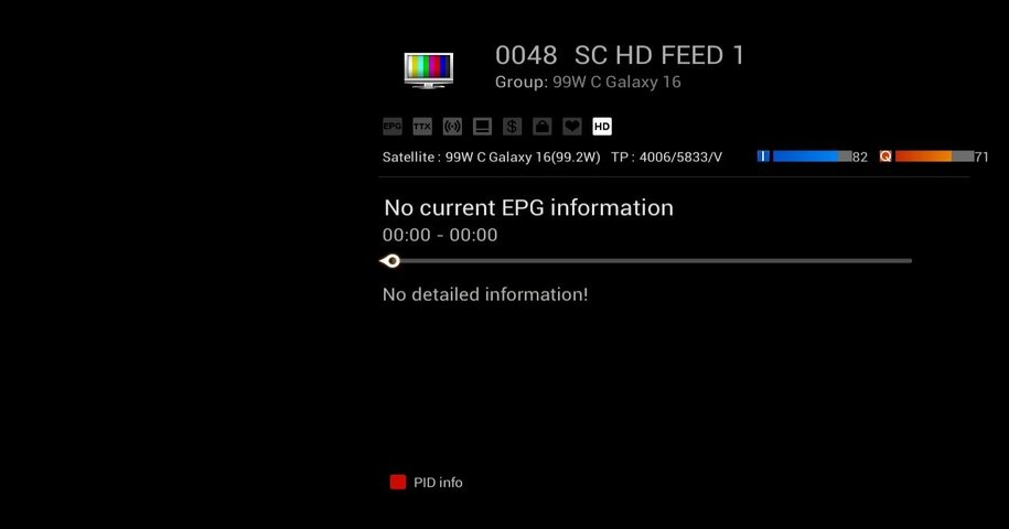

I just tried it again and both receivers locked the channel. Attached are screen captures from the A3.
