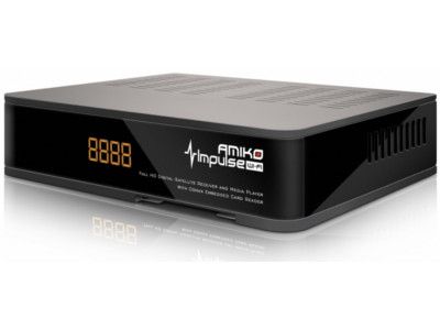

Is there someone brave enough to order one of these from Europe and review?
What would one have to do, just program in US sats?
$45 not including shipping for the non-wifi model:
http://www.satmultimedia.tv/amiko-impulse-sat?lang=en
http://www.satmultimedia.tv/amiko-impulse-sat-wifi?lang=en
Reactions: madmadworld
Judging from the spec., it is an ALI chipset. Likely the new model replacing the mini HD SE with SCART connector for AV.
Install NA satellite list, change the resolution to 60hz (save as default) and use Edison AC/DC adapter or pin to blade plug adapter. For AV connection, use a SCART to RCA adapter.

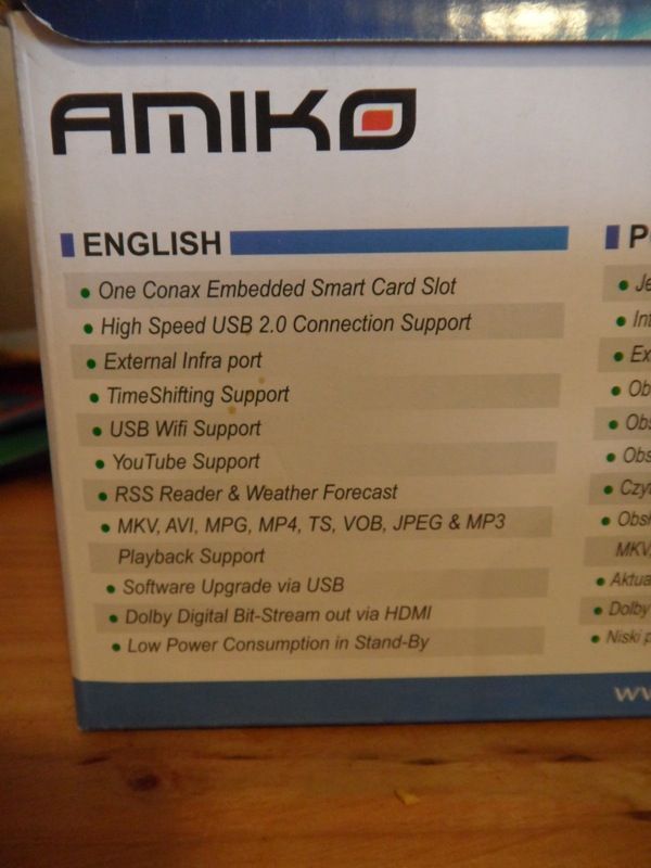

Wi-fi through USB. Function and screens are just like Mini HD SE. No issues observed with 125W-Ku reception, but haven't devoted enough time to fully check out everything.
Specs from box

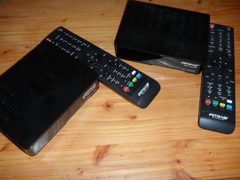

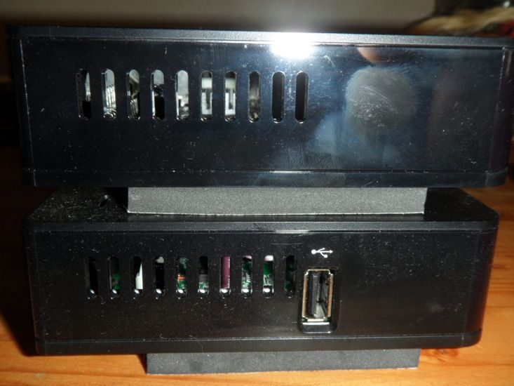

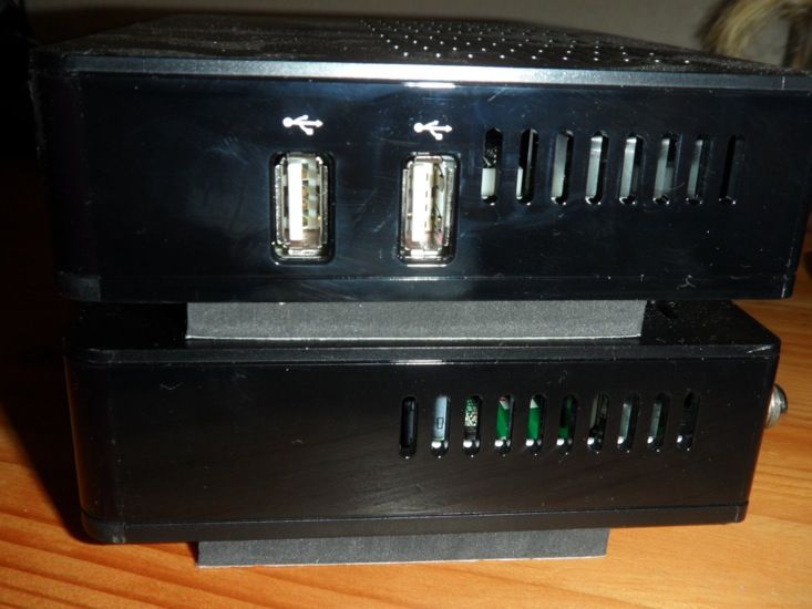

Impulse on left, Mini HD SE on right

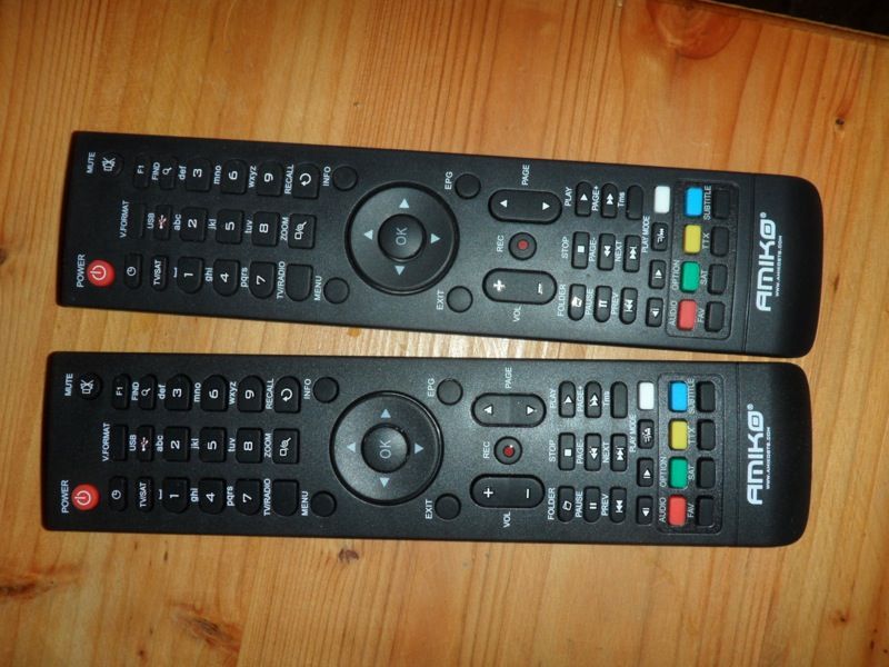

Impulse remote on bottom, Mini HD SE on top

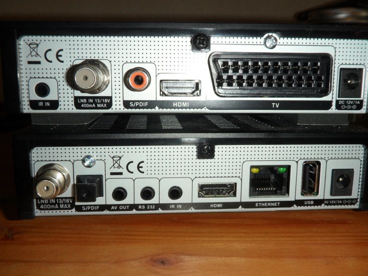

Impulse on top in the rest of the photos

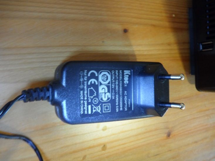

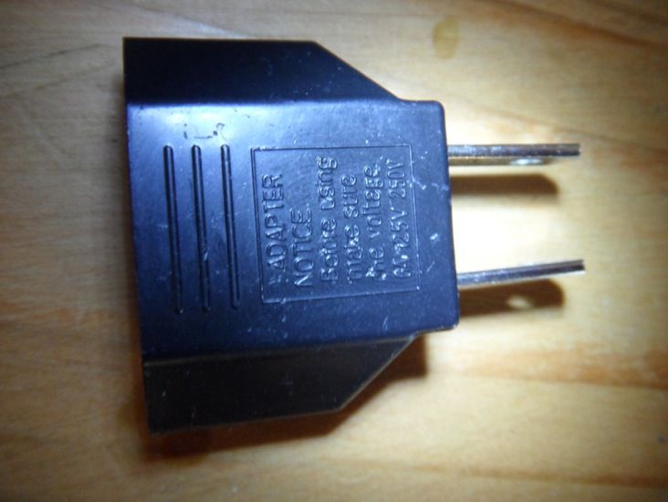

Power cable and adapter

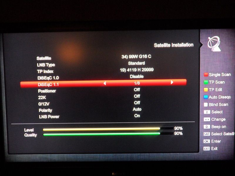

Does it have cascading diseqc control for 1.0 & 1.1?
Sent from a phone, probably while I'm driving over the speed limit through a school zone with construction workers present.
I believe so, but I have not personally tested that configuration.

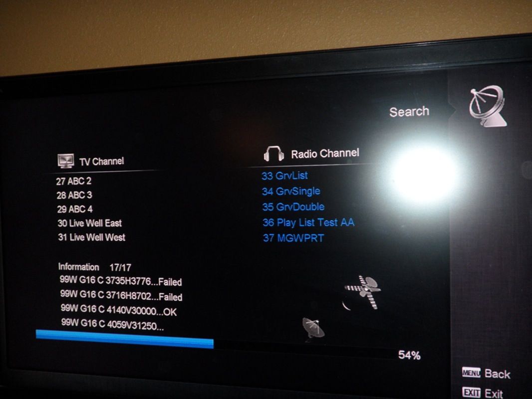

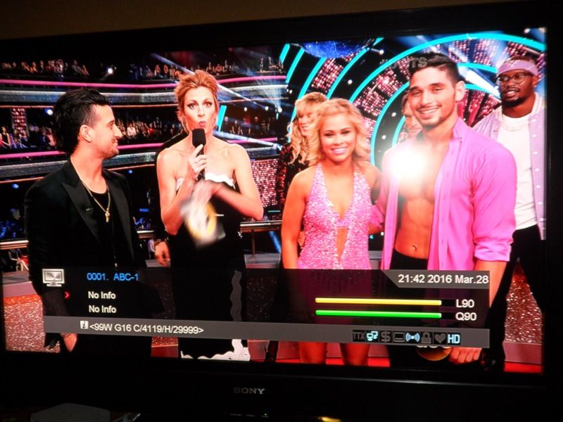

Reading the tech specs, the Impulse supports FEC 1/2, 2/3, 3/4, 5/6, 7/8 and Auto. Does this mean it can't receive the C band ABC with FEC 9/10 transmissions?
Scanning C-band on 99W with the Impulse. Scan time on 99W-C was 3:00 flat. I didn't look at all scanned transponders or channels, but didn't see anything abnormal.
9/10 FEC
Screen photos of selection parameters
Correction from previous post: The photo of the power supply I originally posted was incorrect. This is the power supply that was included with my Impulse, the other photo was the Mini HD SE power supply. Mini HD SE is 12V 2A input, the Impulse is 12V 1A input.
