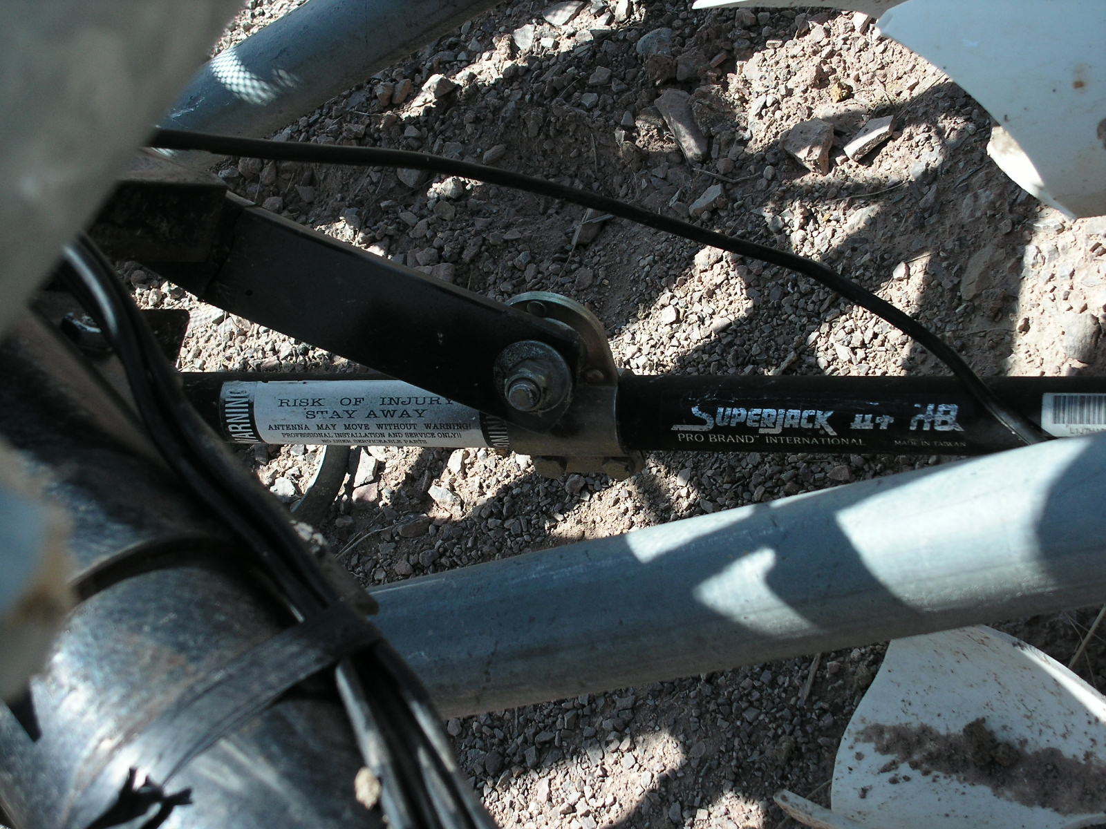

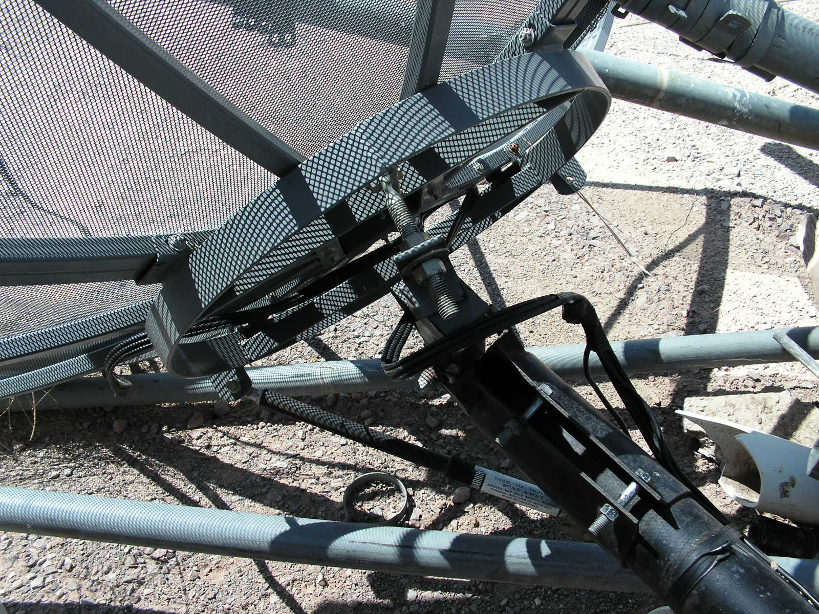

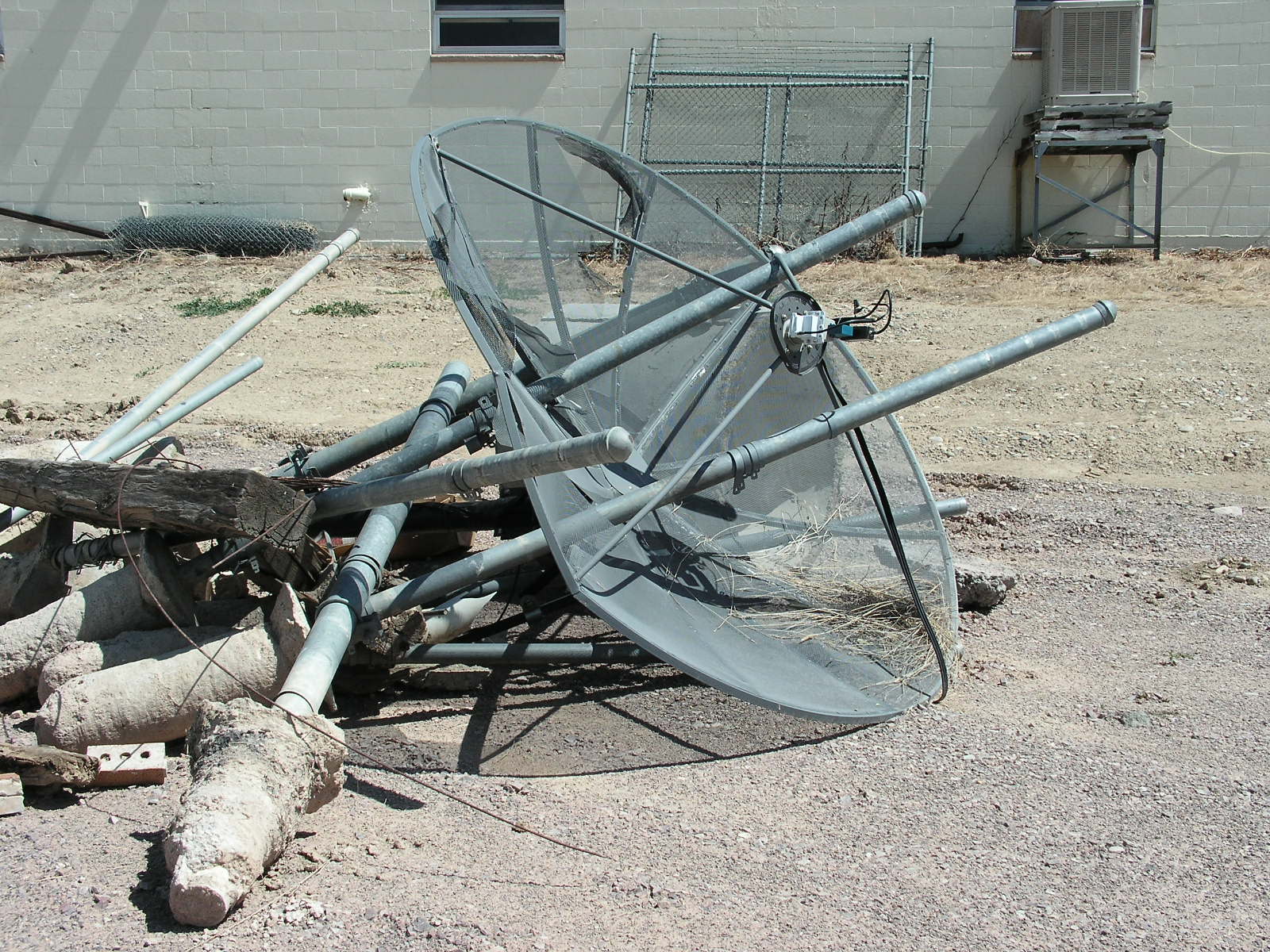

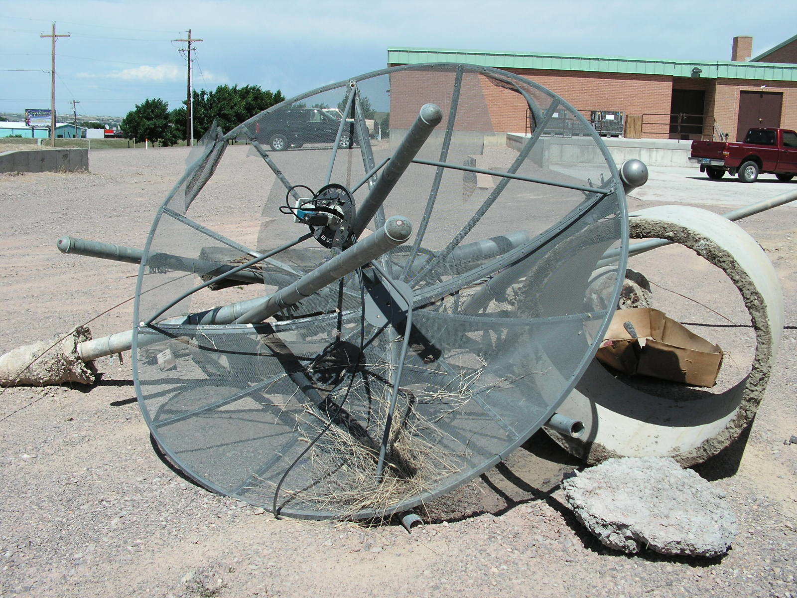

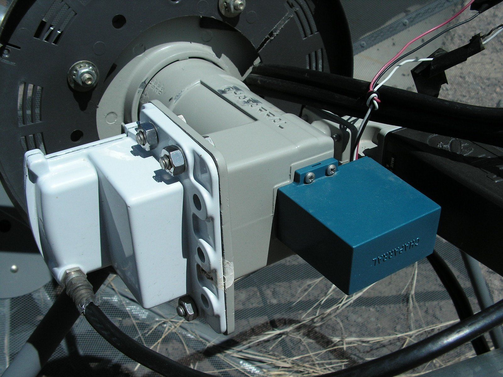

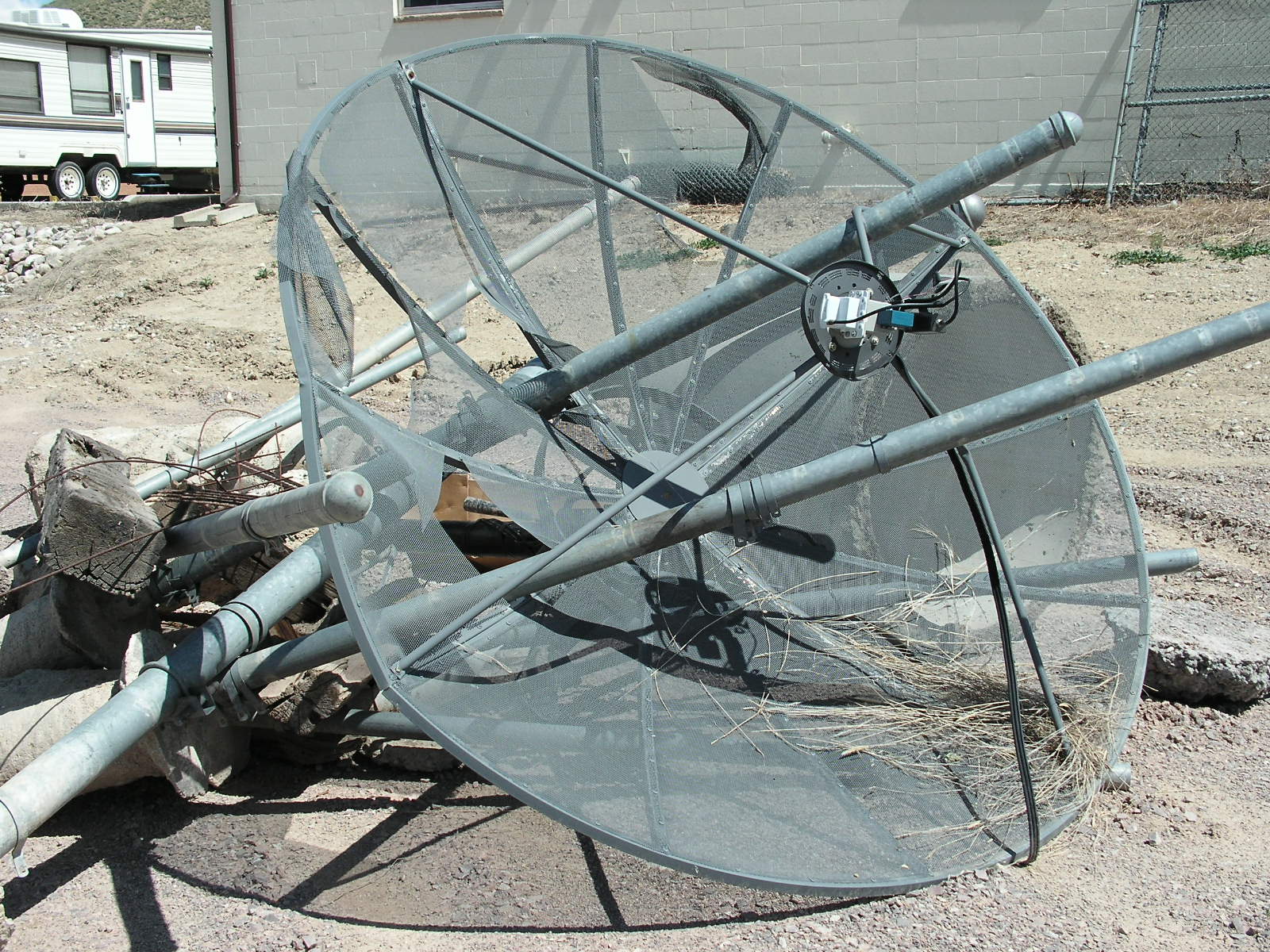

Pictures Attached
Ok, I got some good pictures today. A sad sight indeed.
I got permission to cart off the parts but I have to be done by Thursday of next week.
Actually, only one quarter of the dish frame looks bent. Aside from the punctures, it could possibly be fixed.
Perhaps those who know better can tell me if I'm wasting my time. It looks like a six foot diameter dish made up of wire mesh quarter sections bolted together.

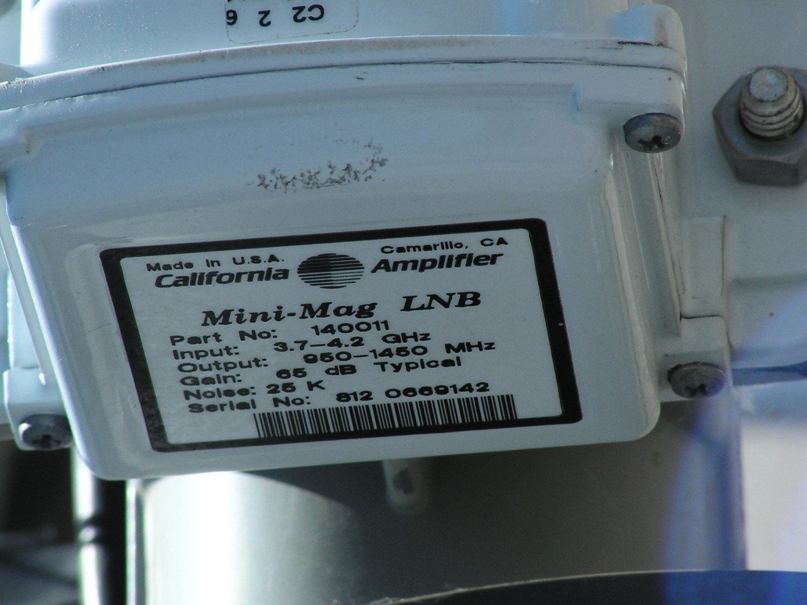

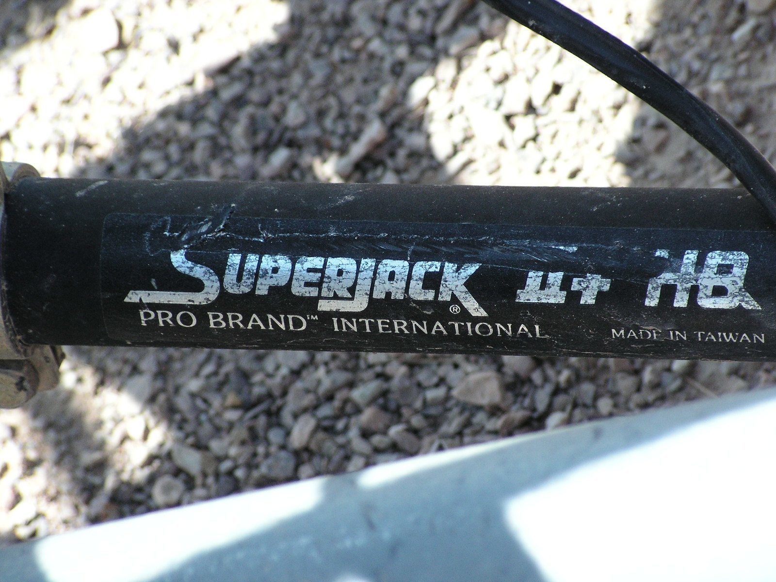

The LNB looks like it may be undamaged. The motor thingy looks like it might work, but hard to tell until I can get to it.

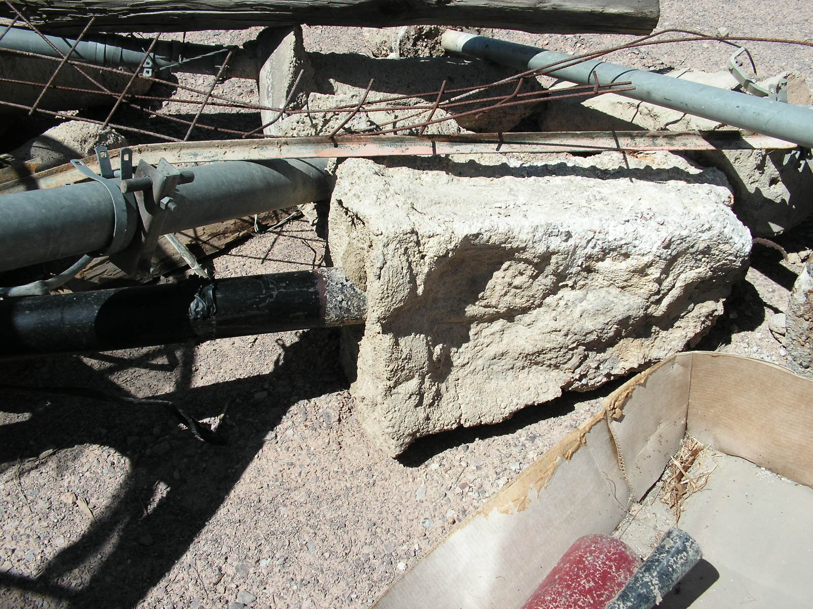

I would have to take a sledge to the concrete base, I think, to get it into the back of my truck.
What do you think? :up or :down or :sob:

The dish is toast. Take the Corotor and LNB's and maybe the actuator and haul the rest to the trash. Keep the mount if it's not broke and you could use it someday for a polar mount for an offset dish.

The Corotor and LNB's are in pics 3 and 4...the actuator is in 5 and 6...

It was one of these I believe. A Perfect 10 6.5 foot with C/Ku Corotor with servo motor.

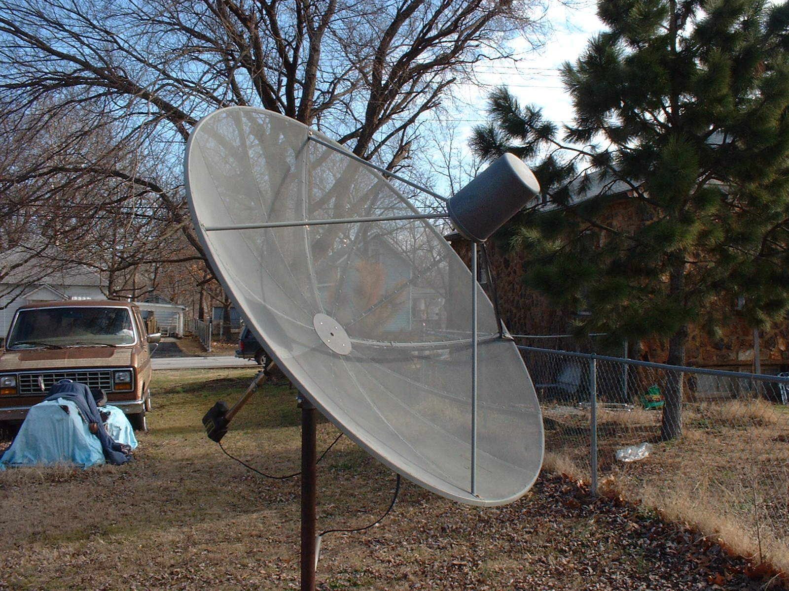

This is a picture of mine. It had a corotor until I replaced it with a DMX741. Looking to upgrade to a 10 footer for S2 feeds.
Fizbi, Worse case scenario you could always experiment with it. Maybe try and make a fixed dish out of it? Maybe find some mesh of some kind to patch/replace. Depends on how much work you want to do, with trying to salvage an almost hopeless cause lol...I've done it before....But I've brought a mangy dog home and made something out of it too lol

That's a Chapparal Corotor with both C and Ku LNBs along with the servo motor to switch polarity. I've seen those sell for $80 to $100 on fleabay. That Super Jack isn't my "first" choice for an actuator but they do work and I have one and it does what I ask it to do. Counts on them are somewhat wanting but other than that they seem to be a "well" built unit. It's definitely worth keeping!!
The polar mount "might" be worth pulling off if it's free. Who knows, you might run up on another one along the way that needs one of those.
