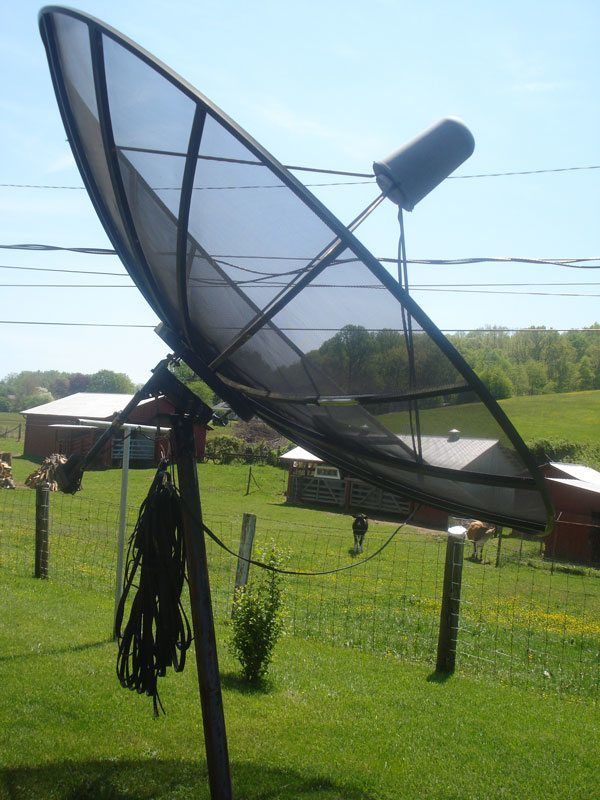

Hello everyone,

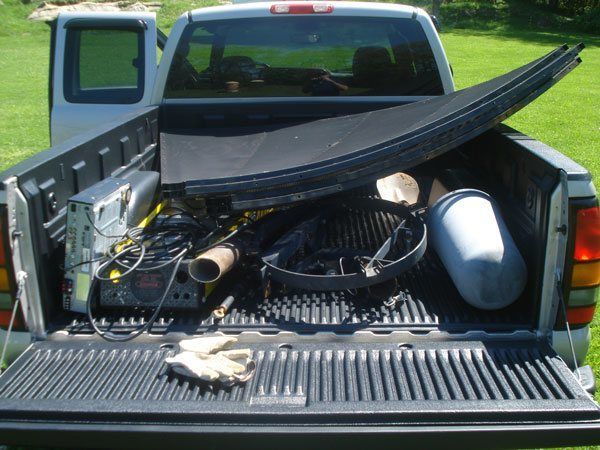

Today the wife and I went and picked up a 10' Sami from a kind Gentleman about three miles from our home.
The pole the dish was setting on had no concrete in the hole so I don't think it would track the arc very well.
The dish passed the string test so I hope it will make a good signal catcher.
It took about an hour and half to dismantle and load it up.
A few years ago we scraped a 10' Unimesh (before I ever heard of FTA) that we had used before going with the pizza delivery. Luckily we did not take up the pole and now we have a good base for the Sami.
So I have a C-2 LNBF from Satellite AV and a Vbox-X from Galaxy Marketing ready to be installed.
We got the dish put back together and set on the pole today, so in the coming days I will work on tuning in the dish and hopefully I will be able to catch some Tribe games.

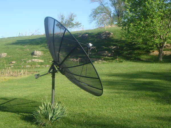

Well the Sami is tracking the arc.
I spent about six hours trying to find my true south satellite with no luck and then I read through Dee Ann's thread again and another thread about declination and figured out that I was using the wrong elevation. I was using the elevation given by Dish Pointer and then subtracting my declination value from that. Should have subtracted the Dish Pointer value from 90.
After waiting for the sky's to clear, we've had a lot of rain here lately, I set my elevation and declination to the correct values and swung the dish to were I thought 83W would be and there it was.
I worked my way west from 83W and found sats down to 121W. Did the push down and pull up on the dish test and didn't have to make any adjustment.
