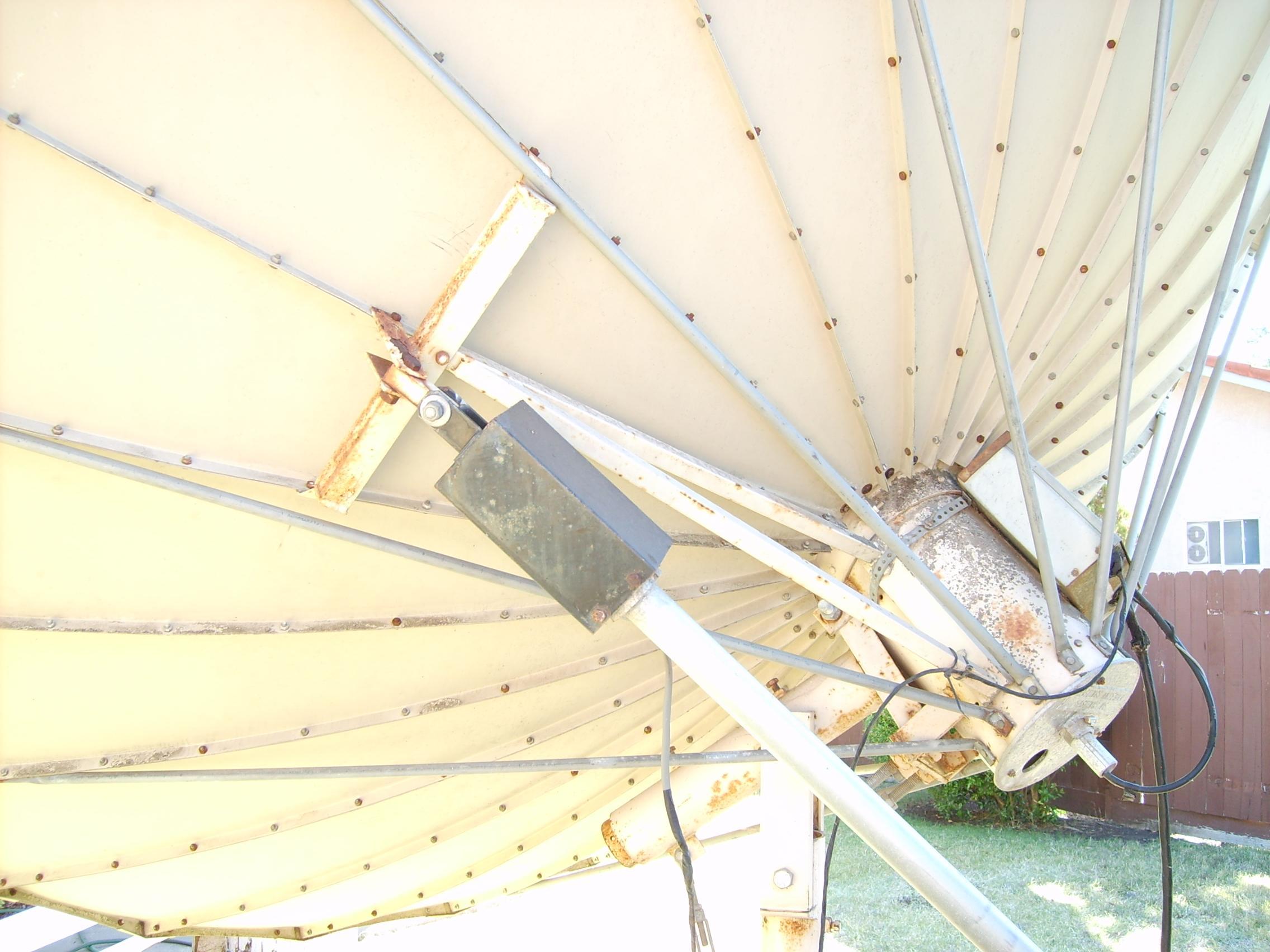

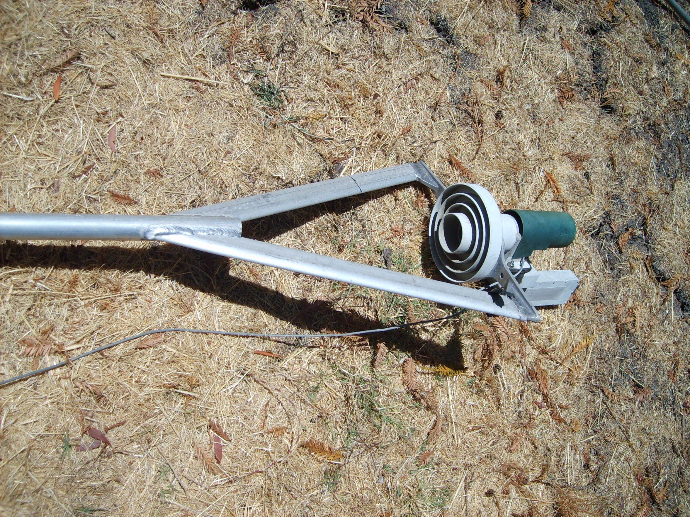

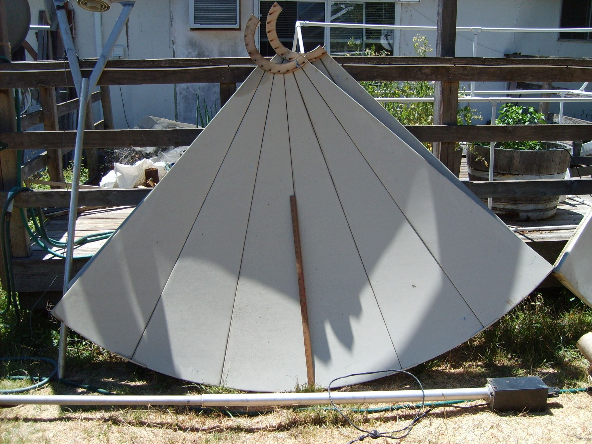

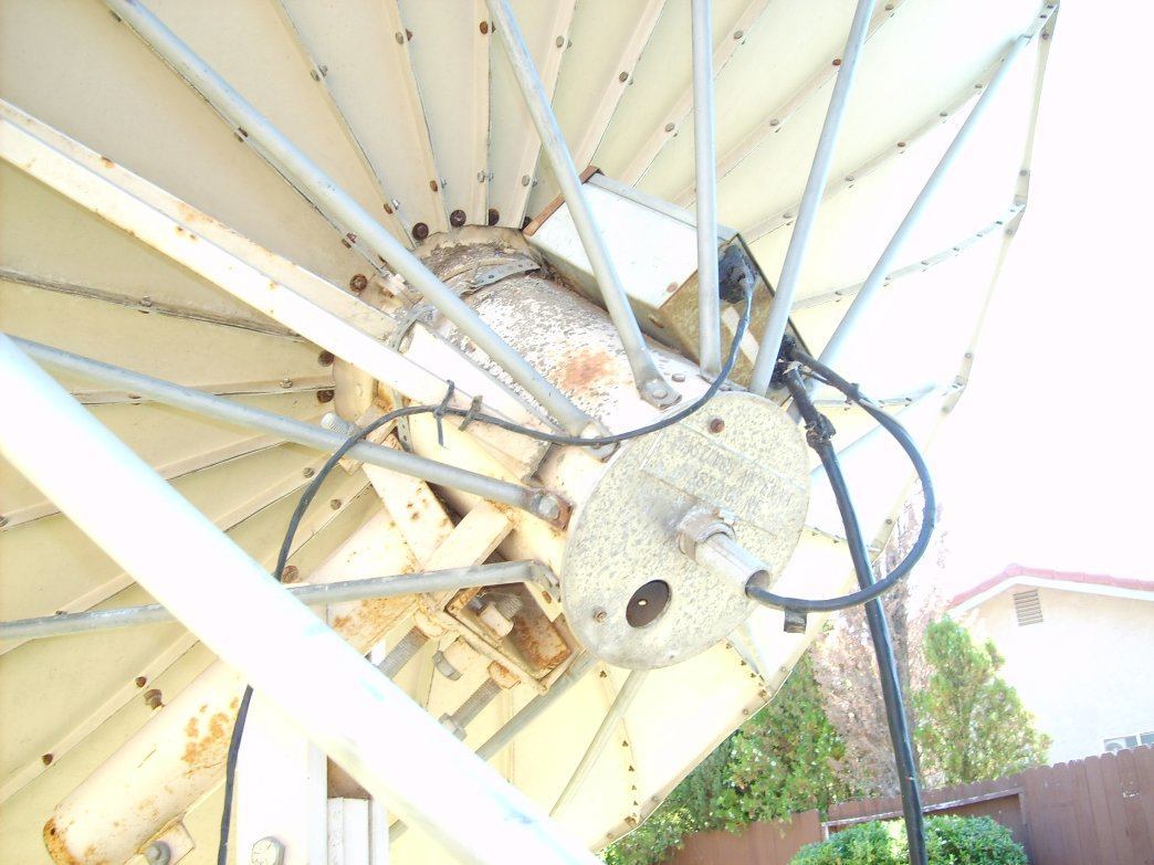

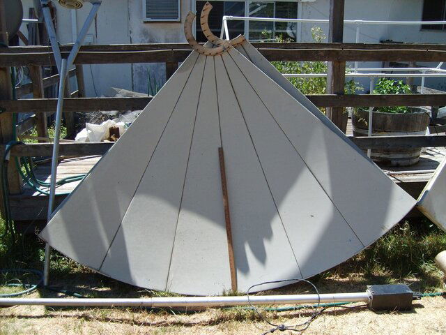

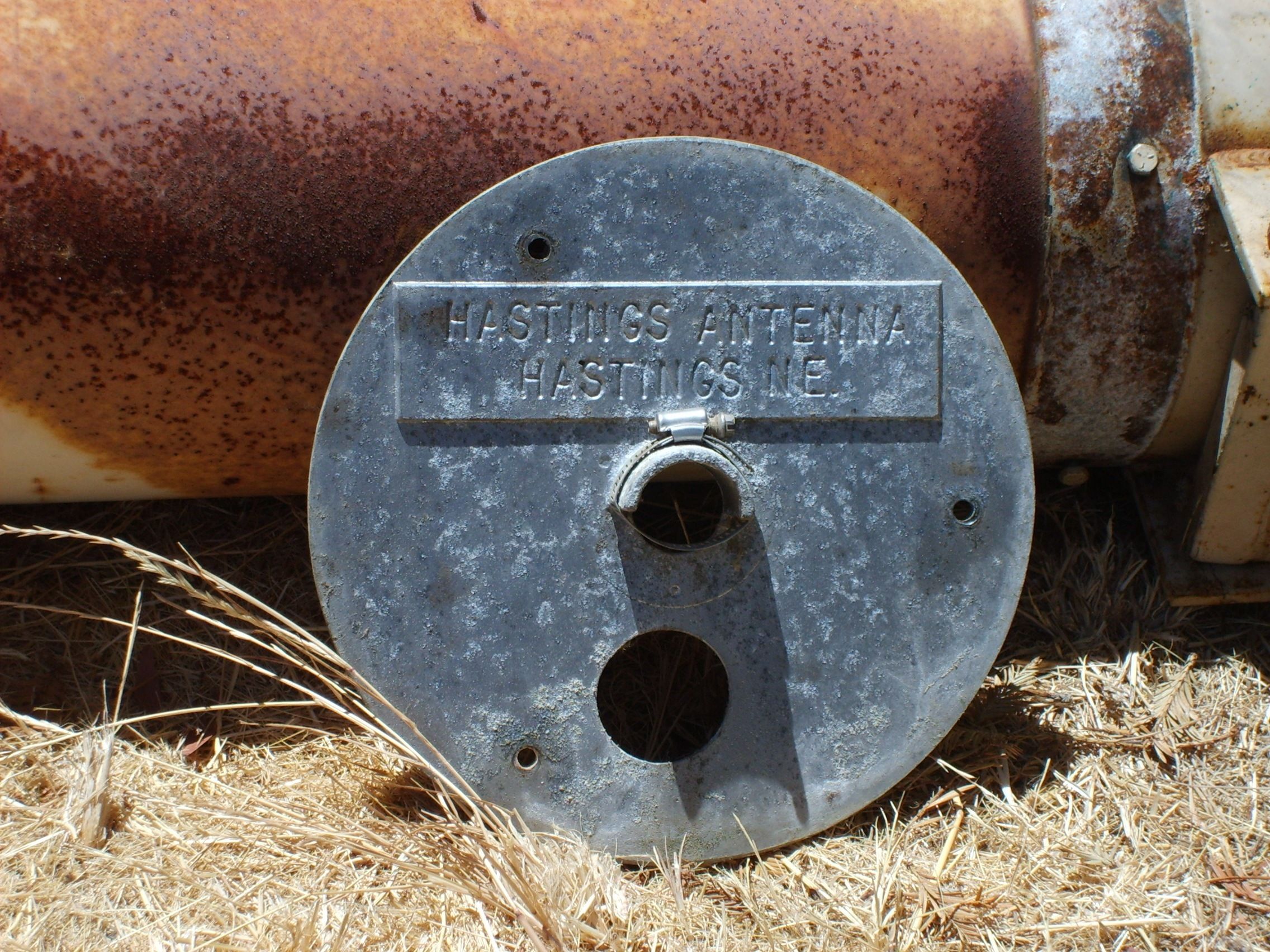

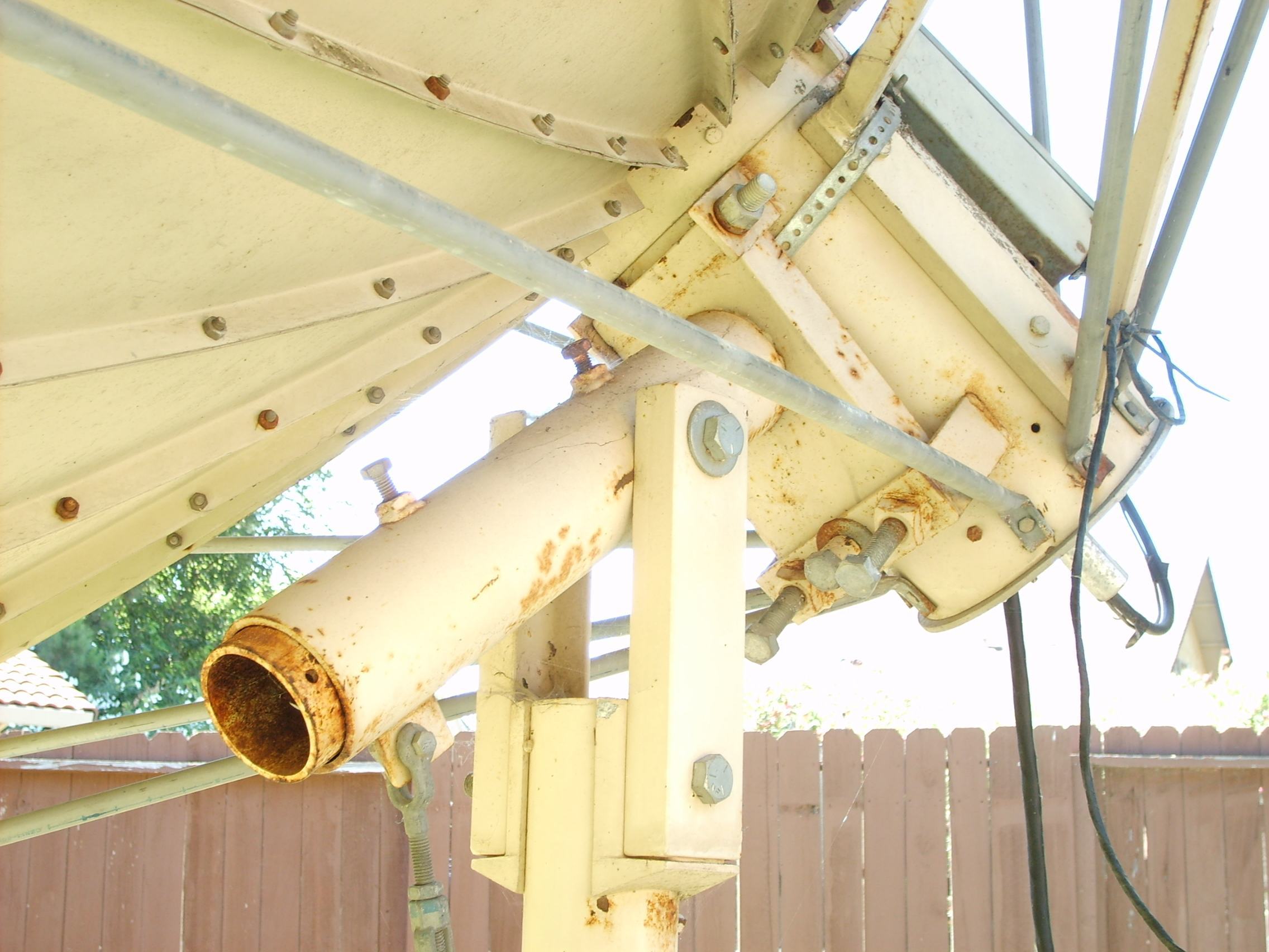

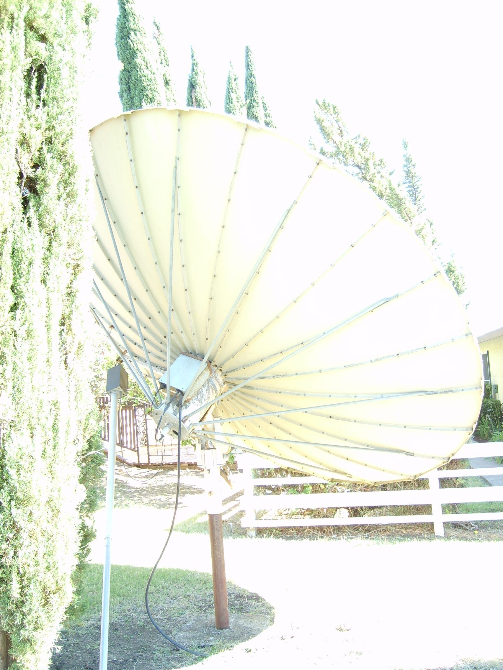

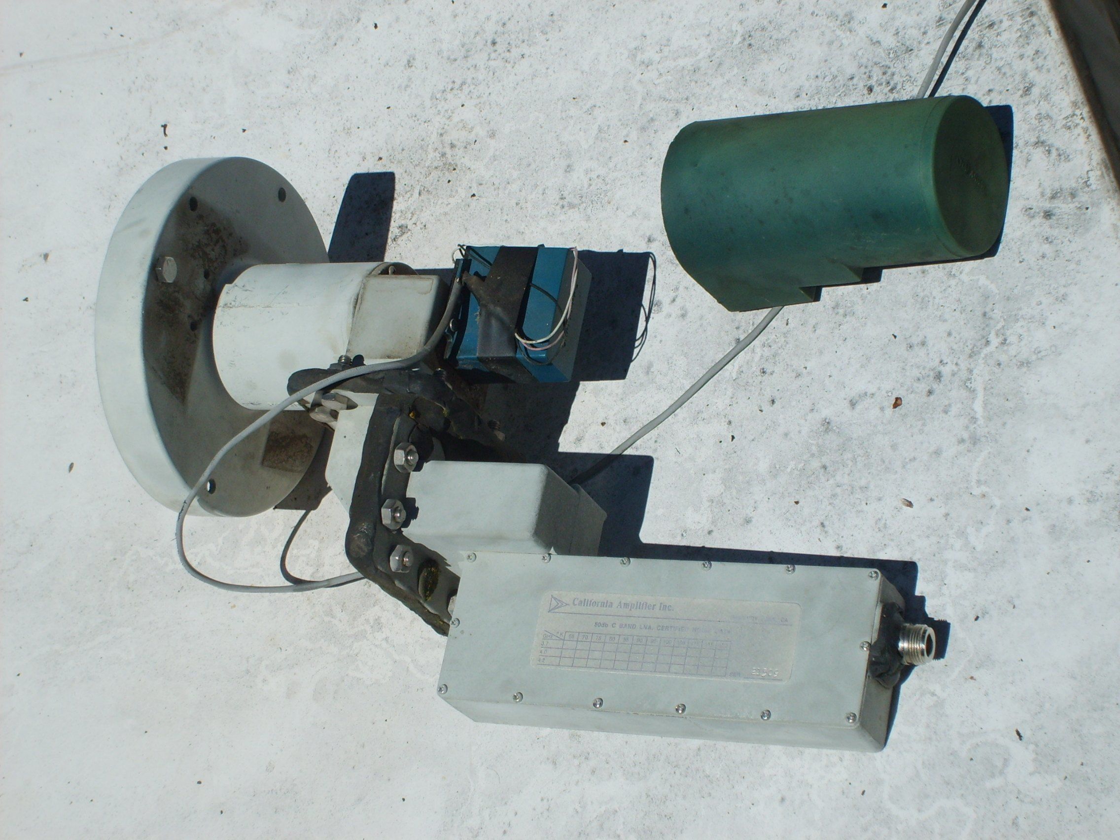

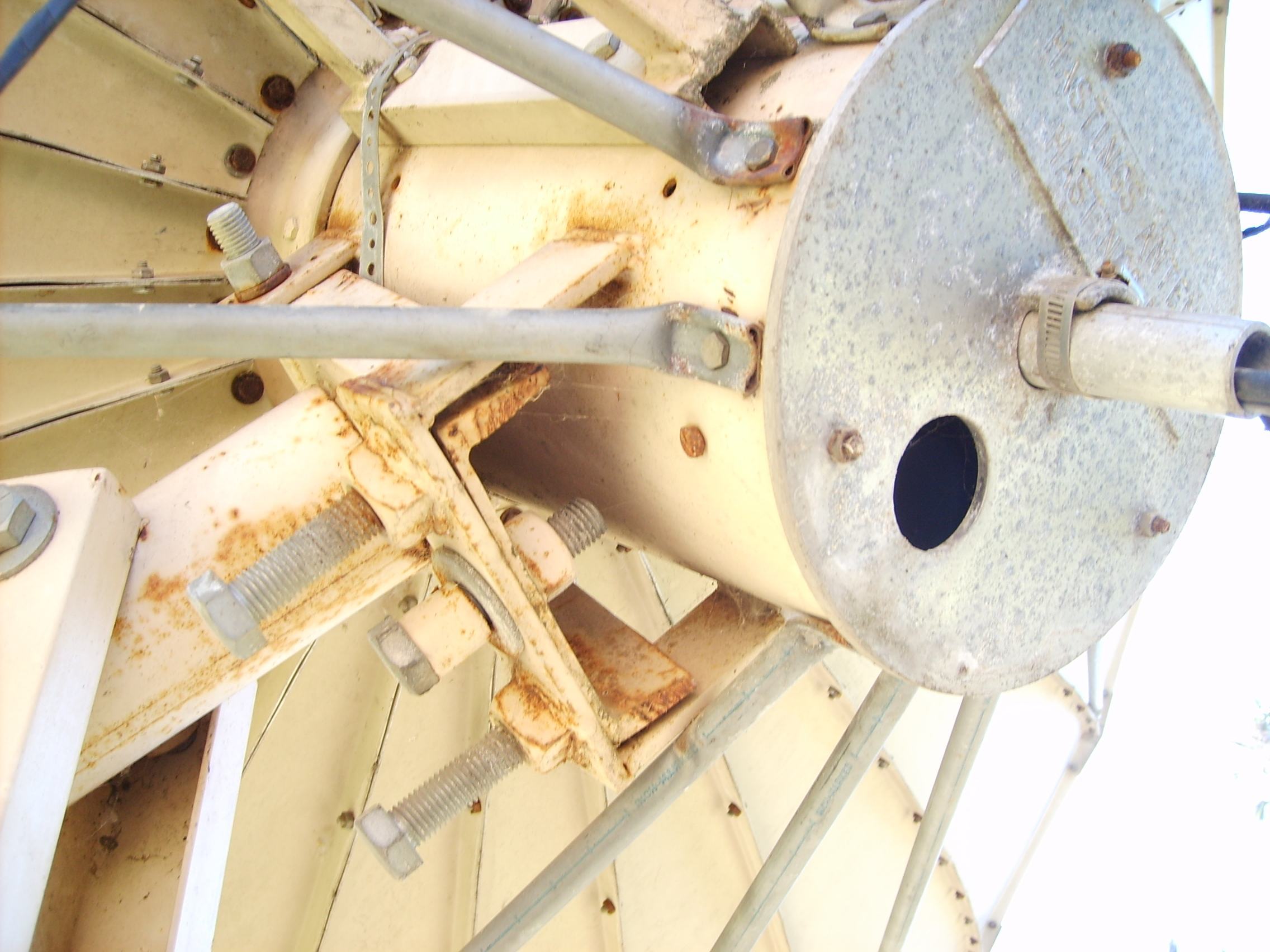

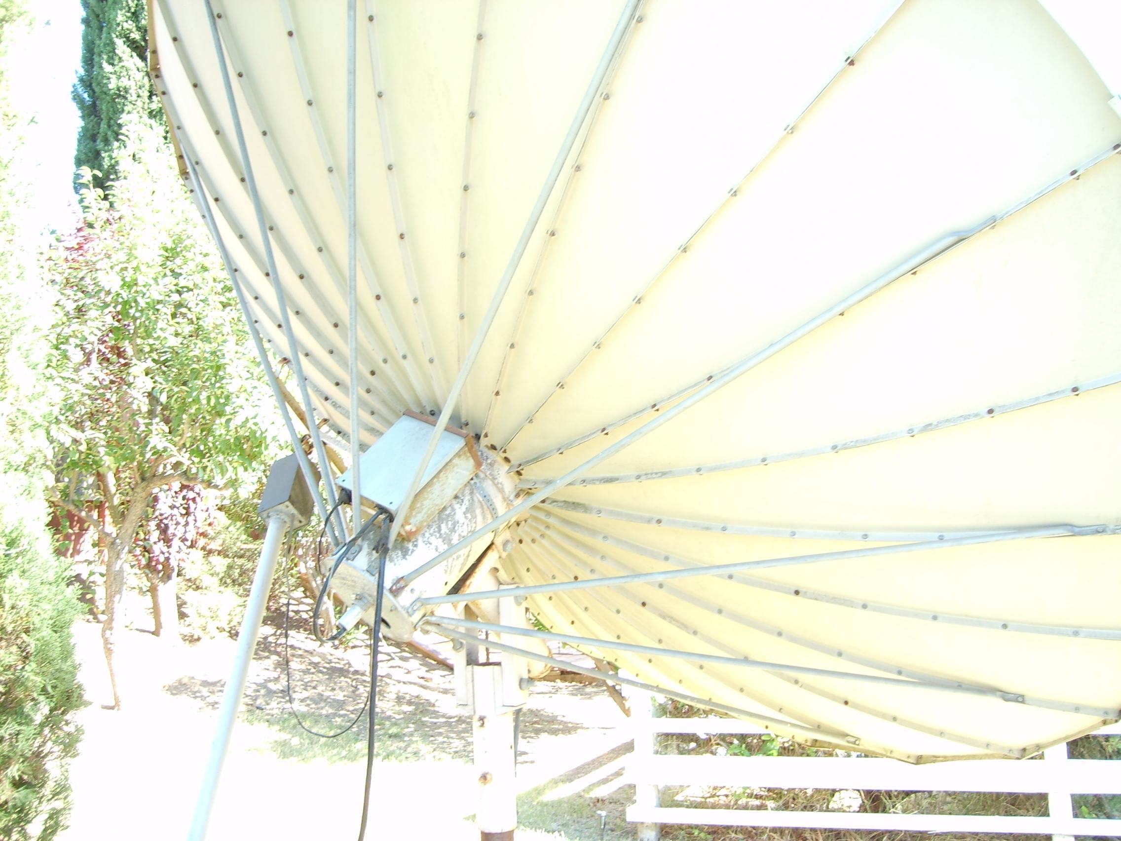

I have returned from my successful BUD extraction mission. After 4 hours of fun with rusty bolts eased with WD40, I was able to bring it home in a pickup truck. It is an 11 foot dish comprised of 24 segments of stamped sheet metal (non-ferric, light and stiff) held together with numerous nuts and bolts. It is made by Hastings Antenna of Hastings, NE. There is an early Chapparal co-rotor feedhorn with a Calif Amp LNB for C attached. The owner gave me the remotes for a Houston Tracker 4 and a Drake ESR240 receiver, but could not remember where the IRDs were.
I took numerous photos before disassembly, but the camera was not fully cooperative, so I'll attach what I was able to salvage.

That looks more like an LNA to me which would mean there's a block downconverter somewhere. Looks like it's hanging on the back of the dish. It's probably not been used in YEARS! You'll likely want to upgrade to a newer LNB but the feedhorn should be ok.
That's an interesting mount for the feedhorn, actually the whole thing is pretty interesting. I've never seen one like it. Looks very well built, if not overbuilt, but in this type of thing that's not a bad thing.
Does the actuator actually connect somewhere behind the dish? Looks like it from the pictures.
Very interesting........very interesting indeed!
Yes, you're right the LNA with an uncommon RF interface connector feeds a Drake downconverter for a 70MHz IF feed to the receiver. The 2.5-yard long(extended) actuator used a ground anchor to move the dish.
It'll take a helluva well-set and concreted pole to hold that monster (looks like the one it was on is leaning) but that rig ought to be a great setup with some modern electronics, nice score! :up
I was thinking the same thing, I bet that thing is HEAVY. Looks very nice though, nice score!

That brings me back to my first system, it had a Drake downconverter with 70Mhz IF output.......can't remember the model of receiver, it was a Drake too. Got hit by lightning so I was forced to upgrade. Good stuff in it's day. Still couldn't stand a direct lightning hit.
