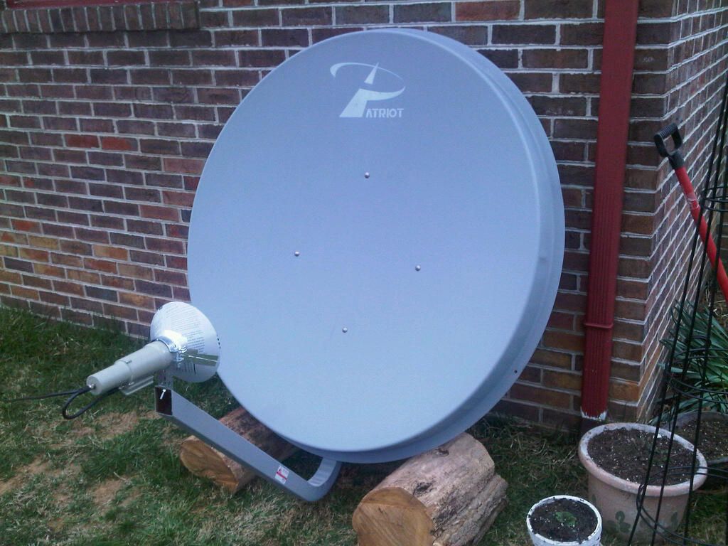

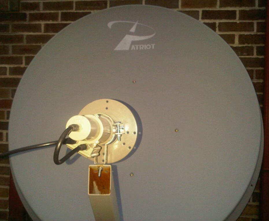

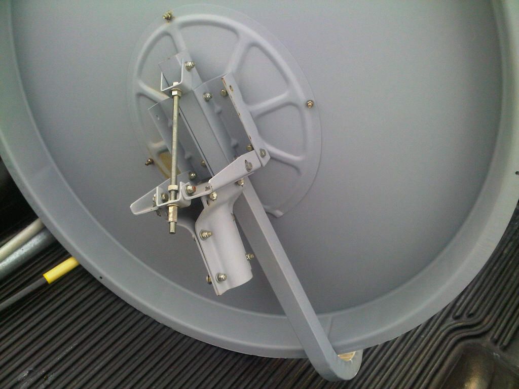

Well the 90cm GeoSatPro has already taken second fiddle to a bigger dish.
Yesterday I got this Patriot 1.2M dish for $75 from a place that sells homes. It was installed at the model home before any other internet services were available in this area. Measures exactly 4' wide and 51" high.
Anyway, got it home and immediately started playing with it. Sure get a lot more signal with this dish than the 90cm.
Really only had a few hours to play with it - - - - more later.

Very nice dish. I like how stiff the rim was made and the elevation adjustment device. Let us know what kinda C Band you get on that. Also like your stacked cone scalar setup, you'll blow those guys away with their 6' PF.
Very Nice looking dish. I have always liked the Patriot dishes, which I could find a 1.2 for that price locally.
WOW - I like this dish
In this case bigger is better! It would be hard to go back to the 90cm dish for "C-Band" after playing with this dish.

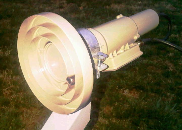

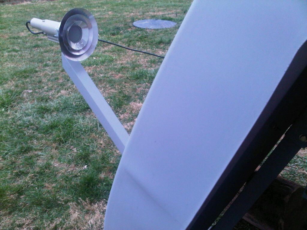

I found that the flat scalar works better with the 1.2 meter dish than the conical scalar. I'm not sure why this is but it may be due to the fact the the
symmetry of the cones is very important once you go larger.

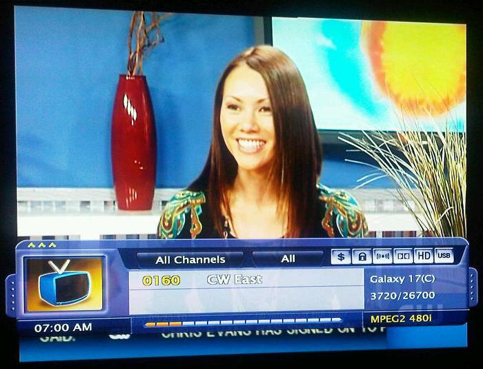

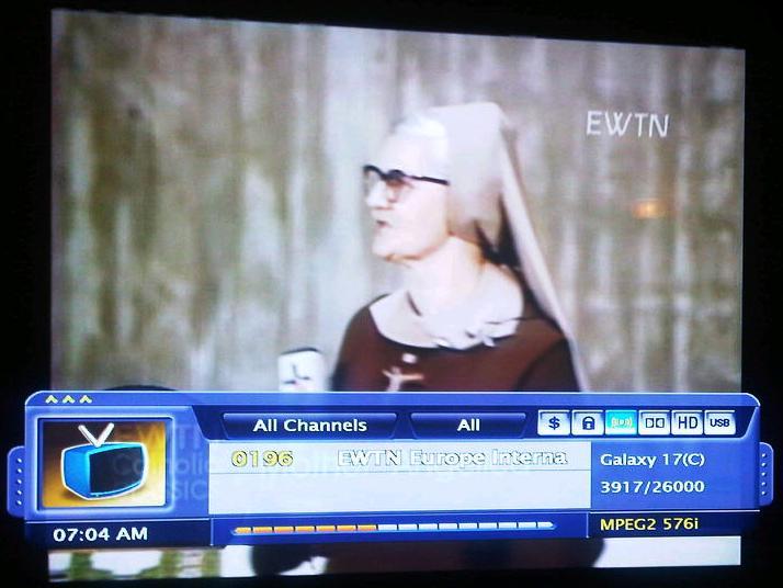

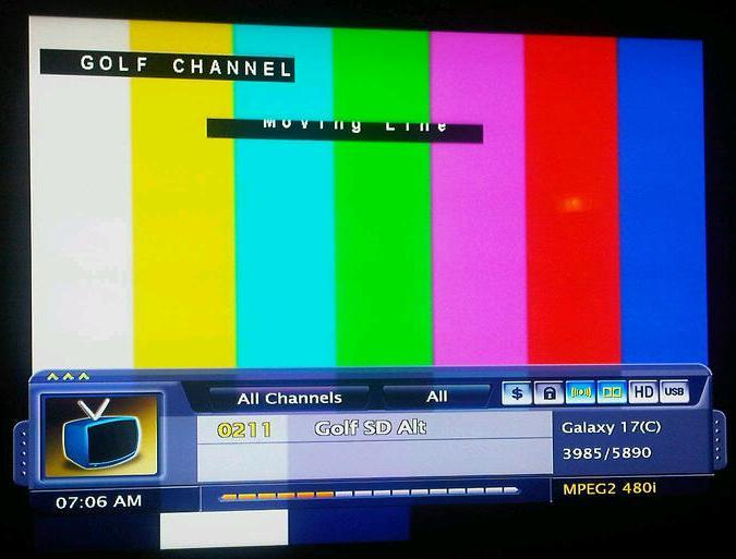

I'm still testing on 91W and of course, I got more channels. Blind Scan for both ITC and Encrypted channels came up with 54 channels TV and 53 Radio.
I could not blind scan the CW so I had to download my channel list to a USB drive, open it up in Channel Master, add those three channels and then upload that back to my SonicView HD8000. I have only just started to play with Channel Master but it is a way cool program and if your receiver does not allow manual PID entry this is about the only way to do something like this.

A few more PIX.

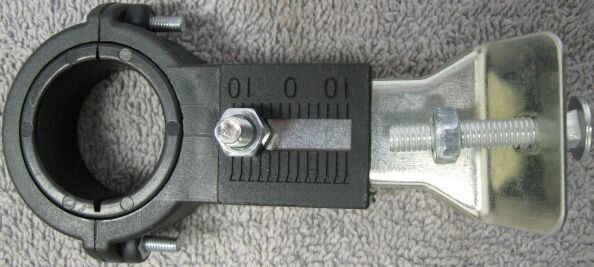

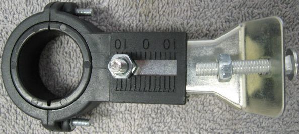

Great job!! I see you incorporated the "9/16 nut" patch in your setup. :up:D:cool:
Thank you for the link. I just placed one into the cart and then saw that shipping is as much as the part itself. :eek:
I'll buy something at Home Depot or Lowes.
Just purchased this one on EBay for only $7 shipped. Plus it adapts to C and KU LNBF's and is adjustable.

That doesn't look like a C-band clamp. It appears to be a standard 40mm with a 23mm reducer donut.... let us know what they ship to you.

I could be completely wrong, but this clamp appears to be too small and would not be large enough to hold a 65mm C-band feedhorn.
The unit is adjustable in height, but the size of LNBF clamp is limited to the standard KU size of 40mm and the smaller throat size of 23mm.
