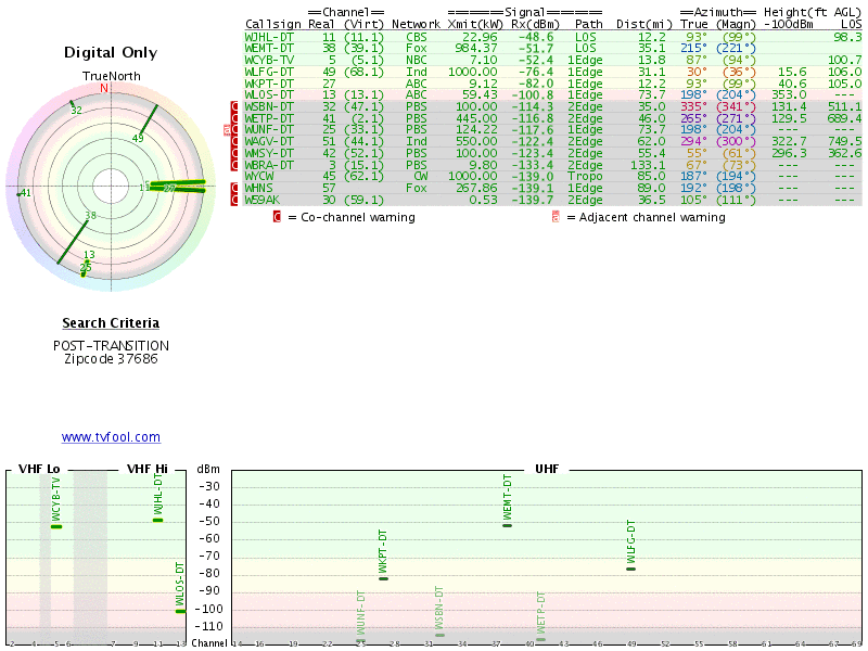

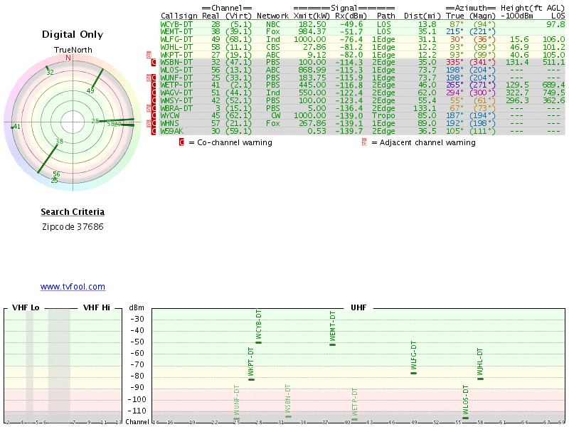

See attached pictures pre and post transition from tvfool.com for your zip.

According to tvfool.com NBC 5 and CBS 11 will be VHF after 2/09. So far they have been pretty accurate. They get their data directly from the FCC database.
