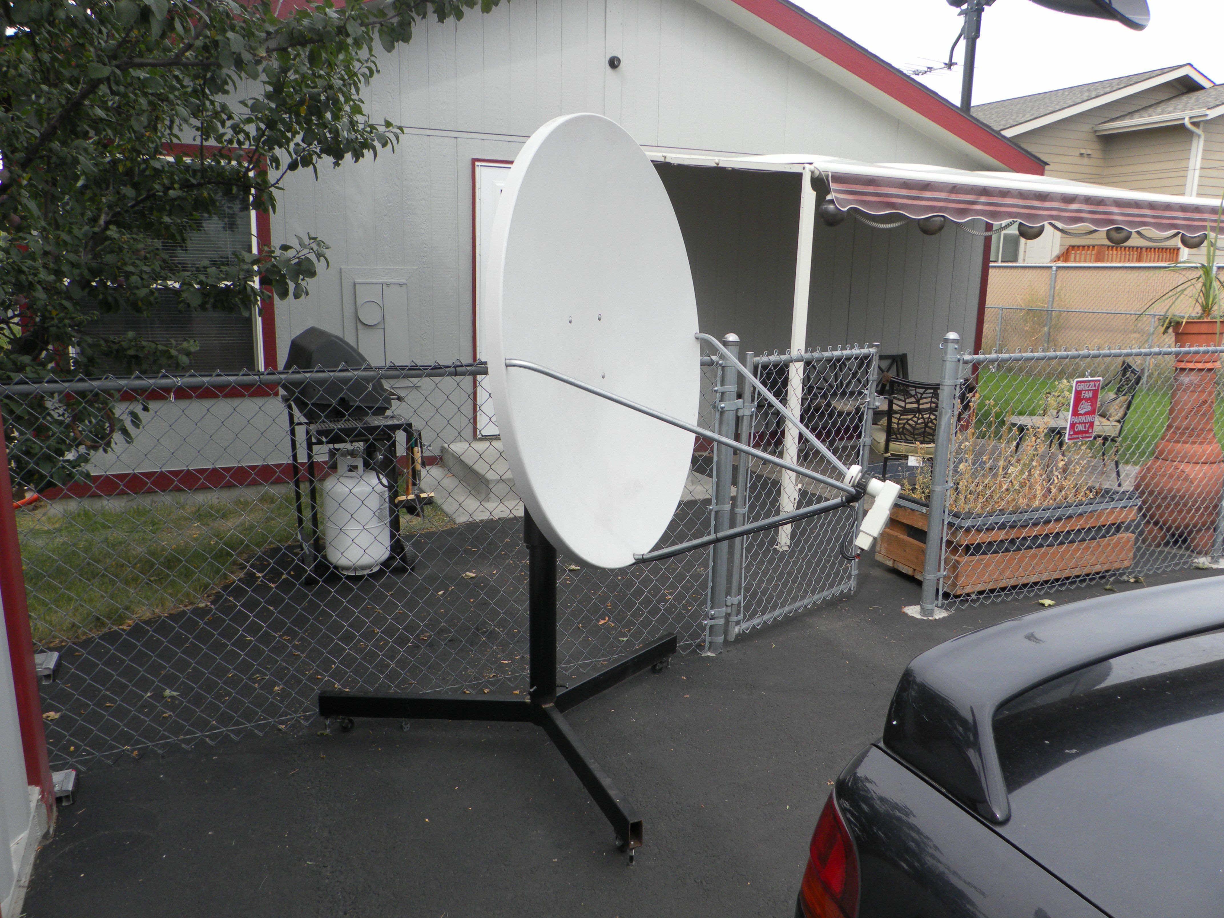

My local college team will be on AMC16 a bunch this year. The other games will be on Galaxy 17. The first game ia App State here :). I put up a 1.2m in the driveway (Iceberg Special ;) ) and lined it up on AMC 16. I'm ready for some football :)
Love your parking sign. My grandson is No 82, freshman Tight End Noah Scarver. Hoping he gets to play some this season for the Grizzlies. Met Coach Delaney in Minneapolis when on a recruiting trip.
