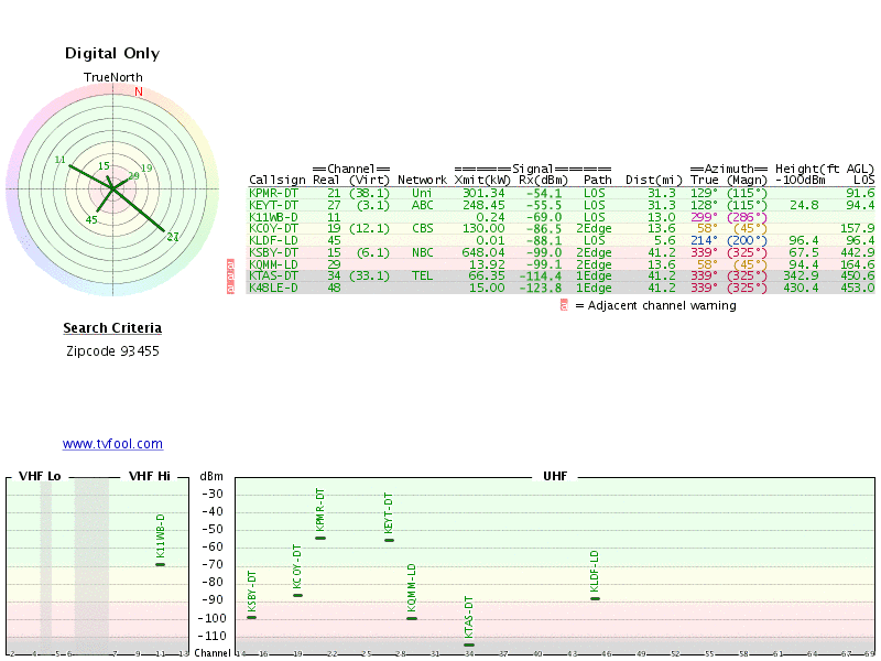

The attached TV Fool analysis for your zip code shows the relative signal strengths of the channels reaching your area. This is only used as a rough example, and you should definitely get your own analysis with your exact location for more accurate results. Pay attention to whether or not your location has a line-of-sight or a 1- or 2-edge diffraction view of each of the transmitters.
A rotator is definitely the way to go, but if you are philosophically against the idea, it will be a bit more tricky to do and you'll probably end up doing a lot more trial-and-error testing.
BTW, the "front-to-back" gain ratio for the SS-1000 is probably too high to allow you to get both ABC and NBC simultaneously. What you really need is a bi-directional antenna with decent gain out both sides. Also, beware that some antennas labeled as bi-directional actually do a poor job of being bi-directional (e.g., they become uni-directional on some channels).
An "omni" antenna will receive signal from both sides, but they have very little antenna gain, so you might not be able to pull in enough signal to watch the weaker station(s). This is a simple setup, so you might just want to try it to see if it works, but be prepared to return any products you purchased in case it doesn't.
