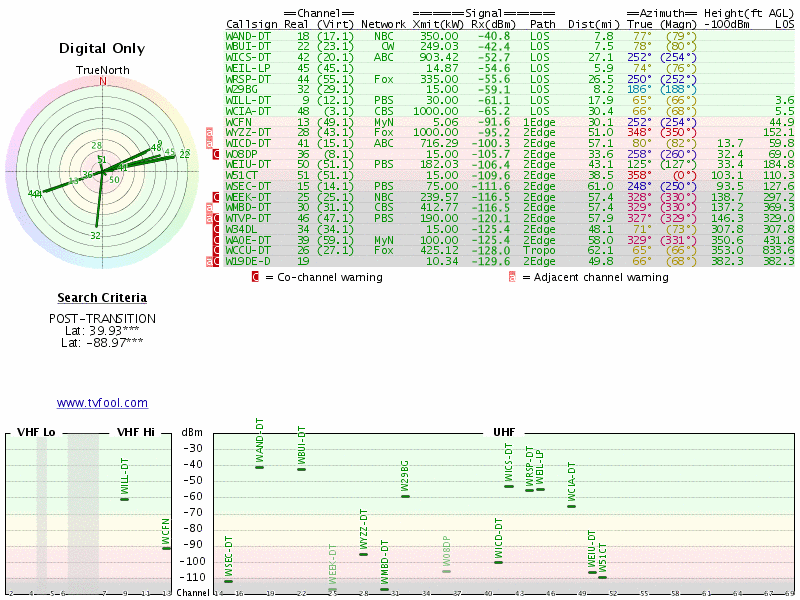

This may be more helpful than antennaweb. The channels shown are the final channels for February, 2009.
