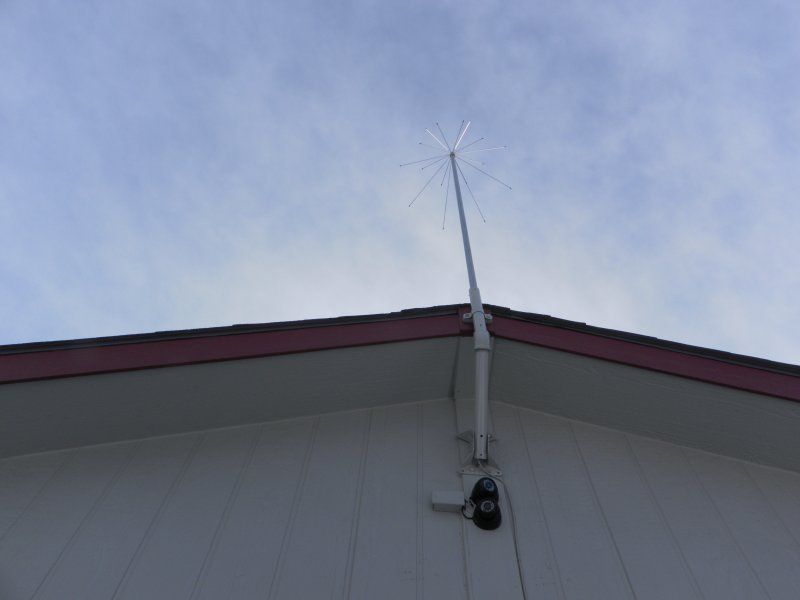

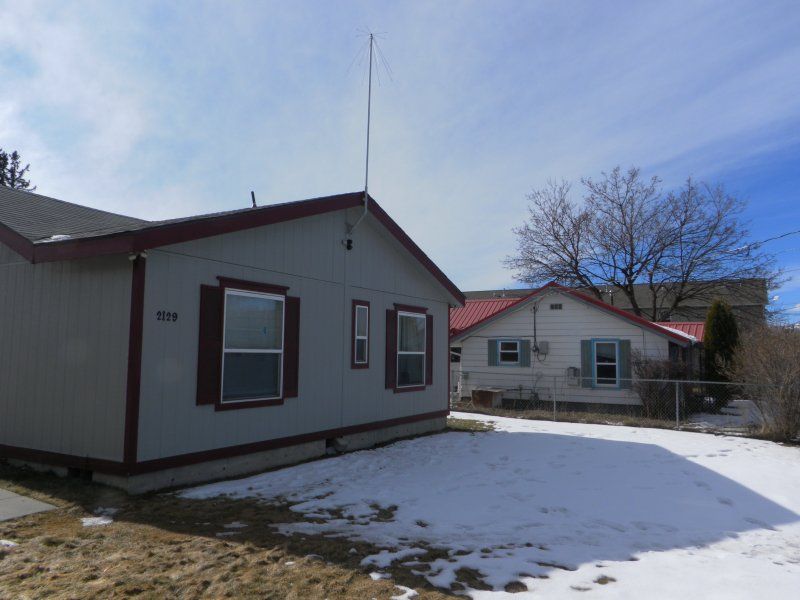

After a lot of consideration, I think I am going to go for a unconventional type of mast mount out of my own madness. ;) It may be a few weeks before I get it done. I'm not one for climbing around a roof covered in ice and snow. And it's still very much winter here.
Reactions: Nascarken 91xg
Well thanks to nasty weather in California pushing some warmer air my way, the temps have risen to seasonable levels for a couple days. It has hit upper 40's and most of the snow is off the roof :) So I jumped on my antenna project and put it up.
