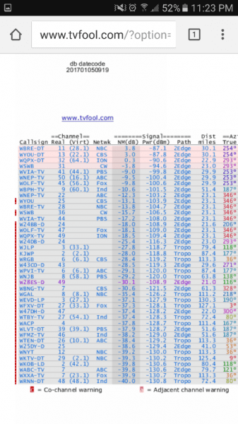

I want to stick with a fairly compact antenna, But my terrain and OTA in my area is fairly poor

My towers are around 30 miles away, But I'm in a valley which puts me at the poor scale for OTA.

Yes, they all come from west.

You have several VHF channels a UHF antenna isn't going to get all the local channels. Buy a good branded such as a Winegard or Channel Master antenna designed for VHF/UHF. The more signal the antenna captures the more effective a preamp. will be if needed. All your signals are 2 edge so you are most likely in a valley or on the back side of a hill UHF signals will bend more easily than VHF does. NBC 11, CBS 13 and Independent 9 will be harder to receive. A Winegard 7694 might work for you but don't expect small antennas to be very successful.

However, I prefer NEPA stations, and I've been able to get WNEP and WVIA with this antenna. The reason I couldn't get WOLF is because they are on RF 45 and WFMZ is on RF 46 (co-channel int.). I'd need a more directional unit to pull that off. The reason I couldn't pull in WBRE and WYOU is because the distance to Mountain Top is too far for Hi-VHF (WBRE is RF 11, WYOU on 13). The antenna is apparently capable of 25 mile Hi-VHF. You're location is pushing it, but with an outdoor setup and pre-amp, you might be okay.
For the record, I can't get WQPX and WSWB because they broadcast from Scranton, as opposed to Mountain Top (south of Wilkes-Barre)... their signals don't reach Lehigh Valley.
