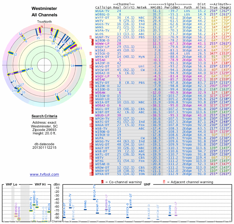

So what type of antenna should I purchase, with what accessories. tvfool attached, thank you!

Am not factoring in your analog stations. For digitals, assuming your LOS is clear of trees and hills, I'd put the antenna as high as possible. Use a deep fringe antenna (91XG) and a pre-amp (CM-7777) then adjust and hit the "sweet spot".

You have 3 VHF channels 7(7.1 & 7.2) 9 (29.1,2,3) and 13(13.1,2,3) the rest are UHF. Your MANT940 is for UHF so that is why you describe 7 & 29 as bad. I would recommend an Antenna Craft HBU33 or larger at 20ft above ground level, with the antenna aimed 41-49 degrees. I don't think you will get many more stations than you are getting now unless you want to add a rotor to get channels from different directions.

most stations do not broadcast on their old analog spot. You need to look at your tvfool report and look under the "REAL" column
As example 4 (WYFF) actually broadcasts on 36 (it maps to 4 like your use to seeing)
You have 3 VHF stations (4 if you consider a low powered station)
PBS 29 broadcasts on RF9
CBS 7 broadcasts on 7
ABC 13 broadcasts on 13
