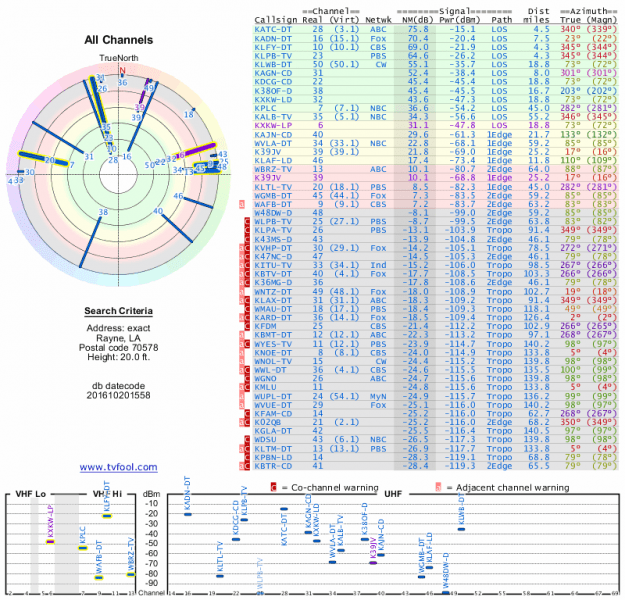

Boba here is my TV following from my address in Rayne La 70578

Based on stations coming from multiple directions and the proximity, I'd say you're using the wrong style antenna. A good omnidirectional antenna may be much better than a directional array unless you're trying to chase after some of the 1 edge stations in the yellow zone with a rotator. The two-edge and tropo stations are pretty much off the table in UHF band. KXKW is going to be a serious problem for most UHF antennas (this includes the UHF antennas that claim -- typically a stretch of the truth -- to support VHF).
