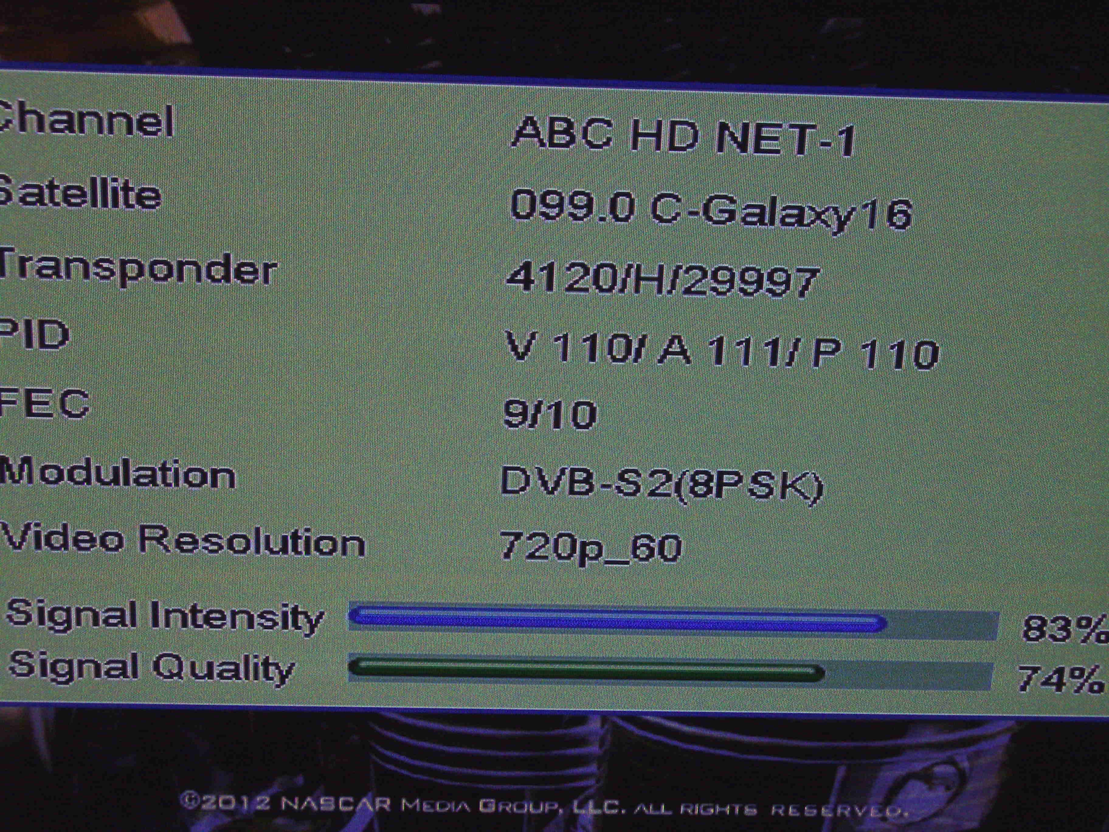

And this is pretty crazy. Scanned in something that is either ungodly strong or a fluke ;)
attachment.php
a 9/10 FEC S2 feed on a 6 footer? :eek:

What receiver are you using that shows the modulation? Thank you for taking the time setting up your dish to answer my questions. Tomorrow I'm going to try to fine tune it more to gain access to the other stations. I scanned in 45 channels, but I know there are more on this satellite.
Manhattan. I didnt get the Fox that is 8/9 FEC.
Funny thing I just aimed the dish with the GeosatPro 200 to lock on the nets and World Harvest (to answer the other question) then hooked up the cable that runs into the house and scanned with the Manhattan.

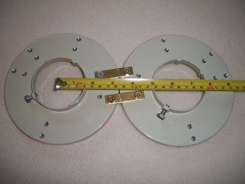

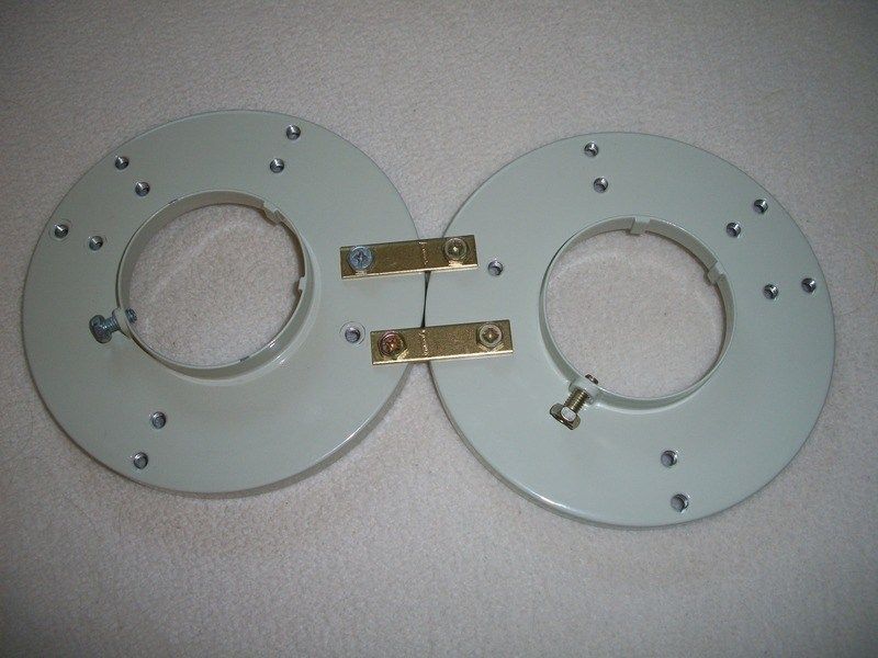

This is how I added an additional C band LNBF onto my 6' dish. The 6.25" center to center spacing receives satellites spaced 8 degrees apart. It worked really well to receive Galaxy 17 and Galaxy 16 with Galaxy 17 being centered. This morning I centered Galaxy 16 and will be receiving Anik F1R on the secondary LNB. The brackets I buy at Lowes and the holes are spaced perfectly to secure the two scalar rings.

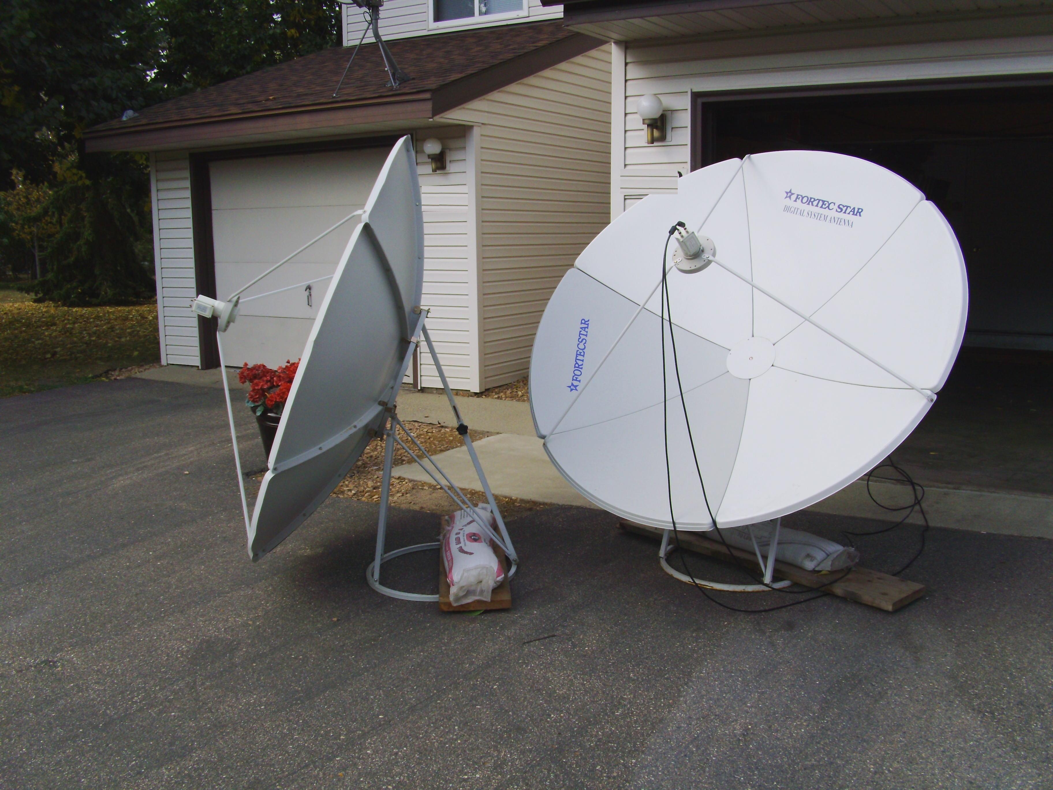

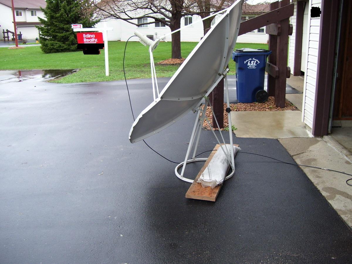

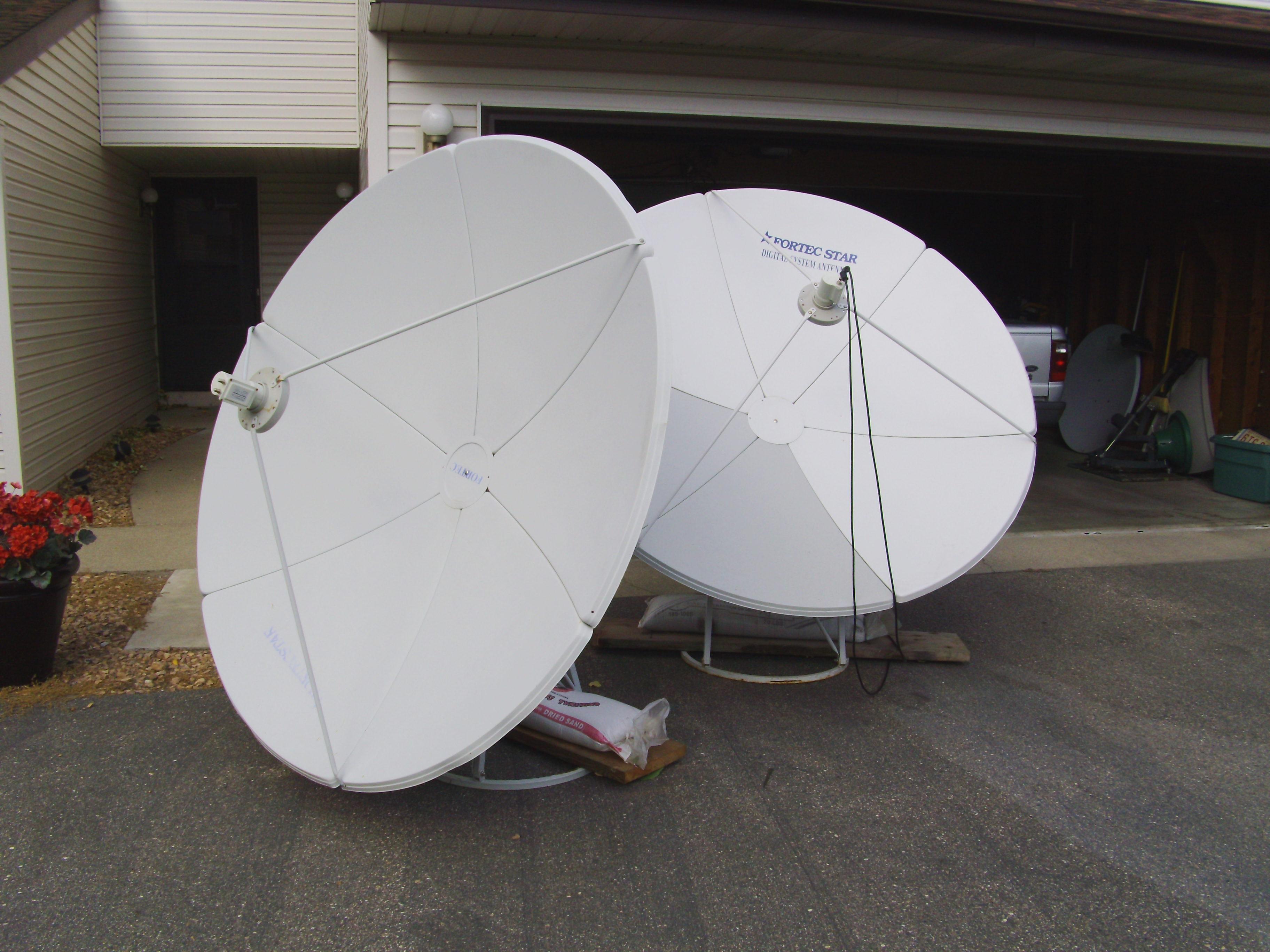

There really isnt much to it. All I have is a 2x6 on the "O" ring and a 70 pound sandbag on top. I have a 2 wheeler that I wheel it out on. There are 3 marks on the "slide scale" (the elevation bar). One is for true south, one is for lowest west which is 139 and a 3rd is for 121.
The advantage of being in Minnesota is from 87W to 103W the elevation is almost the same (87 is at 38 elevation, 93 is at 38.4 and 103 is at 37.6) so all I have to do is drop the dish and pull it along the arc to see 91, 95, 97, 99, 101. I have to lower it a smidge for 87,89 and 103. 107 for CBC is minimal too. If I want to see 118-125 or so I work off that middle marking I made
137 and 139 I have the 2nd dish (the one that use to be on the deck on top of the table) and its pretty much fixed for those. The slide arm is really rusted so if I want to raise it up I need to WD40 the heck out of it :)
