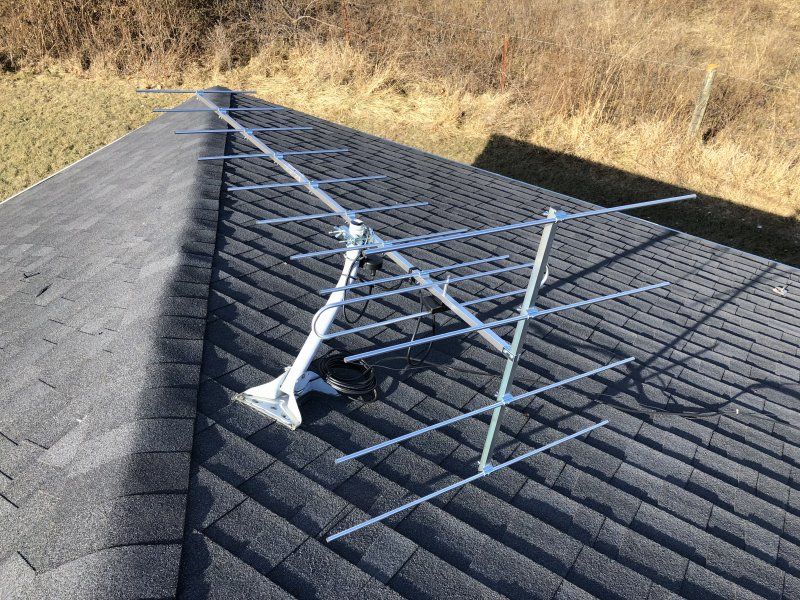

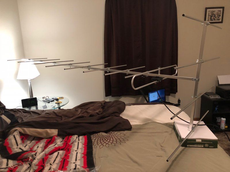

Received the antenna today and put it together. Simple to install, took less than 20 minutes. Hooked it up to an extra TVPRAMP1Z I had in the closet, and laid it across my bed just to test it out. Received signal on KTWU and WIBW. Hope to hoist it up on the roof tomorrow to see what my top signal gain will be. It's a lengthy beast but weighs next to nothing.
The other observation I can add- in it's current location in my bedroom, the VHF antenna is also pulling in ALL the UHF channels I can currently receive with my RCA ANT751R, which is mounted high on the roof. Pretty darn impressive.

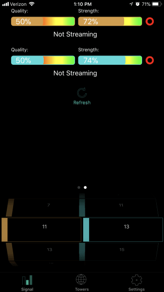

Getting decent results. Both channels are in and out, but at 85 miles I guess that's to be expected. At the very least, the antenna will be good for VHF DX'ing. I also discovered that I lose signal when I try to use the separate VHF input on the preamp, so I'm just going to run a separate feed for my UHF antenna to a second separate preamp.
Don't forget to flip the switch to "separate" on the amp.
I did, but I wonder if it has to do with the fact that the VHF antenna is pointing in a completely different direction than the UHF. Or perhaps there is a certain amount of loss when you combine separate antennas. At any rate, when the desired VHF channels are so weak that any loss can be devastating, I decided to do separate feeds for best results. I have 2 separate HD Homerun tuners on my router that can share the final signal to my PC's in a seamless way, so I think all is well. My plan is to buy my own house in a couple years and either install a very tall tower, or buy a place that already has one. Too bad the City won't let me put antennas atop the water tower :biggrin

All that extra coax has made for bad physics, those two loops hanging under the antenna, just made the shield of the coax part of the antenna. Also the coiled up spool of coax is making a poor mans choke bauln.
