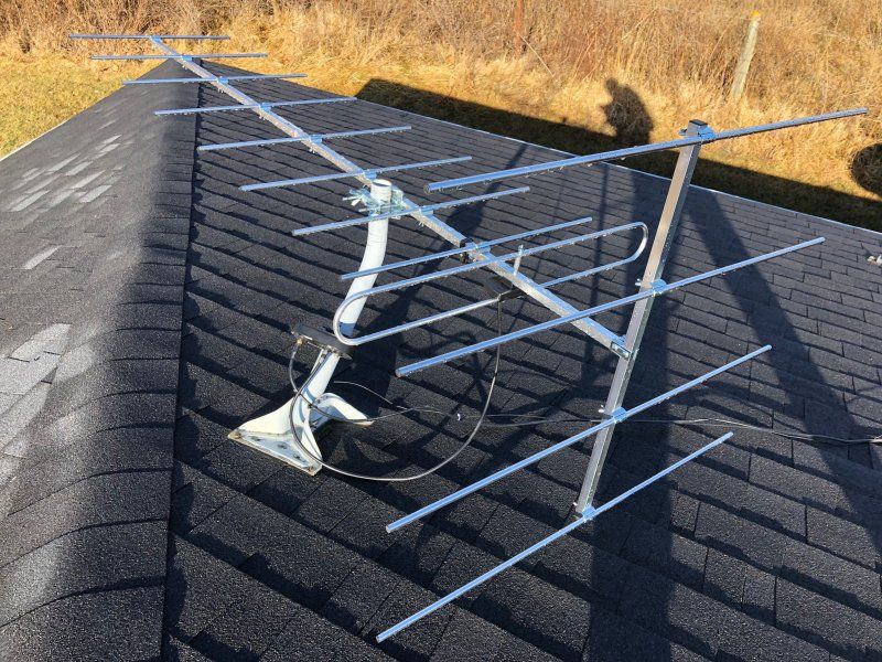

Anybody have experience with this antenna?
All that extra coax has made for bad physics, those two loops hanging under the antenna, just made the shield of the coax part of the antenna. Also the coiled up spool of coax is making a poor mans choke bauln.
I made the loop so that the barrel doesn't snap the adapter out of the antenna's transformer. I've had experiences with those breaking before. I'm also assuming that's why the manufacturer put the coax clip on the boom where they did. I can do something about the coiled up coax that is sitting up there, though. I just need to get the tool to put a barrel on the end so I can cut off the extra coax.

Is it the location of the coil or the coil itself that is the issue? I could go up there and uncoil it, then run the excess down the tube and spread it out in the yard until I can get the compression tool.
Any suggestions on the loops near the antenna? I can put the preamp at the base of the J-pole, but I'm not sure what to do about the loop under the matching transformer. Should that lead just be a free-hanging wire? I'm confused because the manufacturer put a coax clip on the boom.

Tie wraps are your friend. Run the cable 90 degrees from the antenna, you can make one drip loop were it enters the house, make it large enough that you don't kink the coax. And as always, the shorter the run the better.
It is the coil itself, randomly splaying the cable anywhere is preferable to coiling it around and around.
No need necessarily to shorten the cable unless you want to or have no other choice.

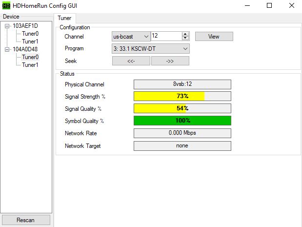

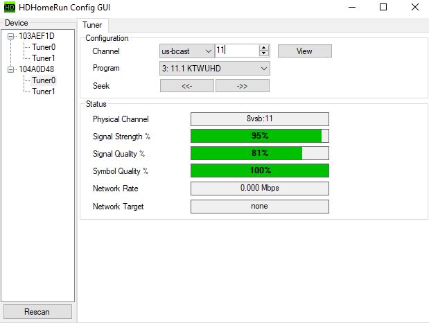

Ok, so I made the changes you guys suggested. I uncoiled the coax at the foot of the mast, pulled it down the tube, cut off the excess, terminated with a new barrel. I then situated the preamp lower on the mast, relocated the antenna lead to a 90 degree angle, and HOLY COW, what a difference. I'm now getting a near 100% signal on KTWU, and I'm also picking up KSCW VHF 12 from Wichita, 203 Miles from here! I guess that could be tropo, but it's only 12:30 here, and that seems highly unusual for this time of day. At any rate, THANK YOU THANK YOU for the suggestions. I had no idea such small inexpensive changes could make such a difference.

I still get tropo several nights a week. It's different stations from different directions each time, though. The two target VHF stations in Topeka that I wanted still come thru pretty well most days.

If you can get my Wichita stations 200 miles away I better be able to get them at 60! :)
Reactions: comfortably_numb
VHF travels farther than UHF over the horizon (longer wave length refracts sharper), so it is not unusual to occasionally get VHF from far far away. Back in the NTSC days our NBC station was 2 edge 82 miles away but reception was 24/7/365 with a clear color picture.
