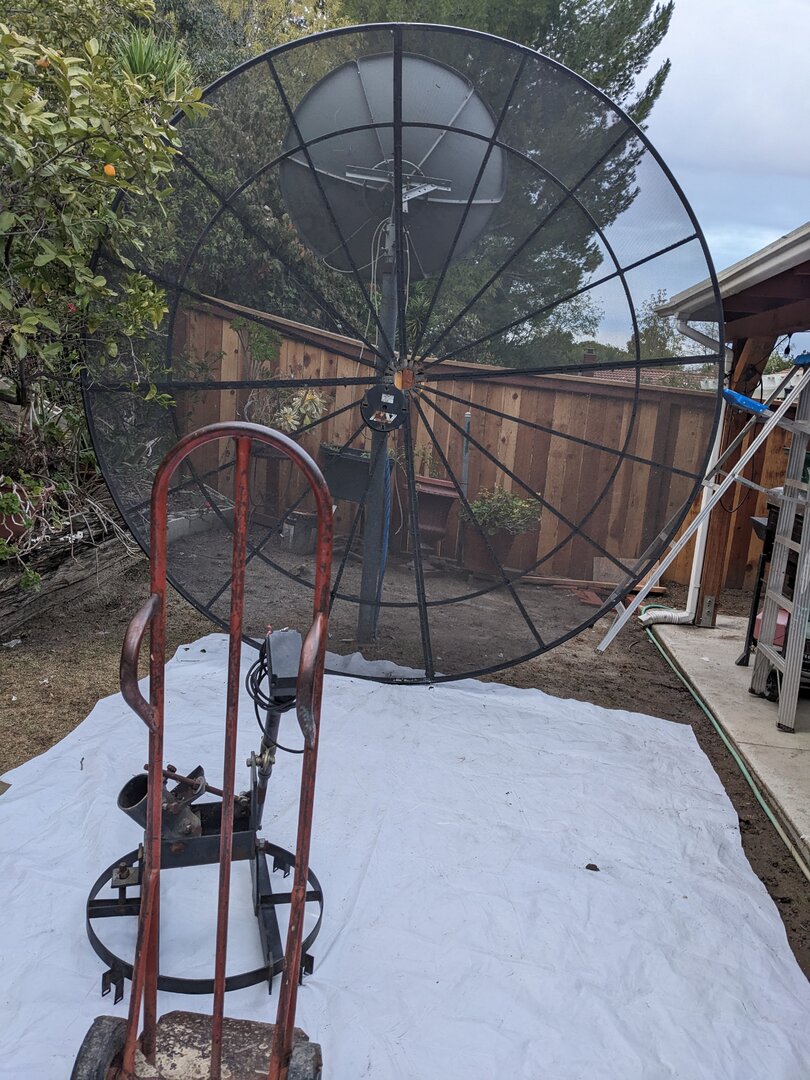

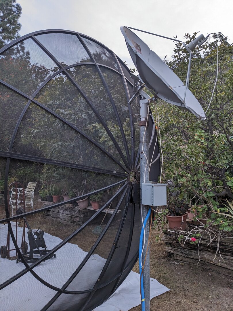

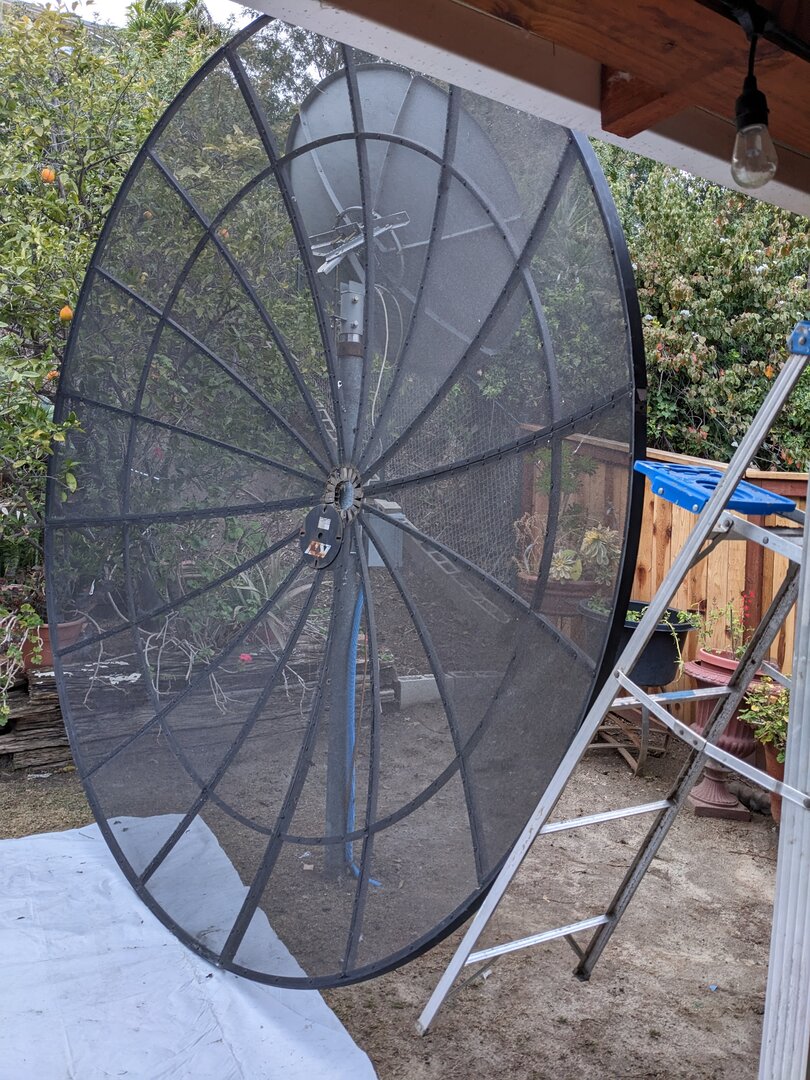

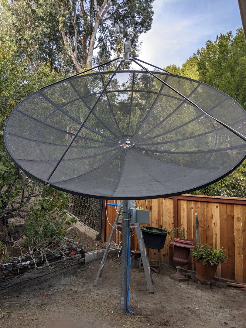

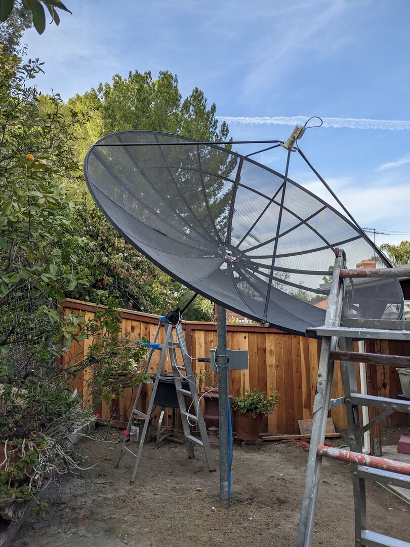

I just got a 10ft kit dish for free and knowing myself i tried it all even a 5g titanium LNB
But the question is does China meters do good with are normal Fta channels because it just looks like they do by having them on the list can seen to find anything. I live in California mission Viejo tried getting the signal from my receiver as well but still the same. I have a sathero the receiver and on both the signal goes up and down.
And if anyone live near me with a good meter and knows what's there doing can come help.
Or any recommendations on a meter budget not Chinese
This is the new setupi just put up
10foot it's late right now so I'll take a full complete pic tomorrow

Ah, you gonna try to install that dish THERE? Those trees look like they are going to shade the whole bottom half of the dish, all across the arc... That'll wipe out a LOT of your signal.
