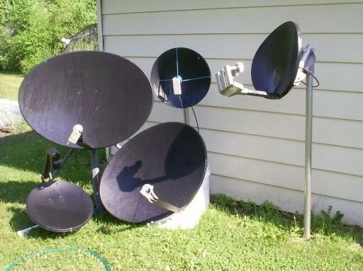

I gave up on the 40" P* dish for C-Band when I got a 6' dish! I get about 99% of the C-band satellites NO PROBLEM now :)
