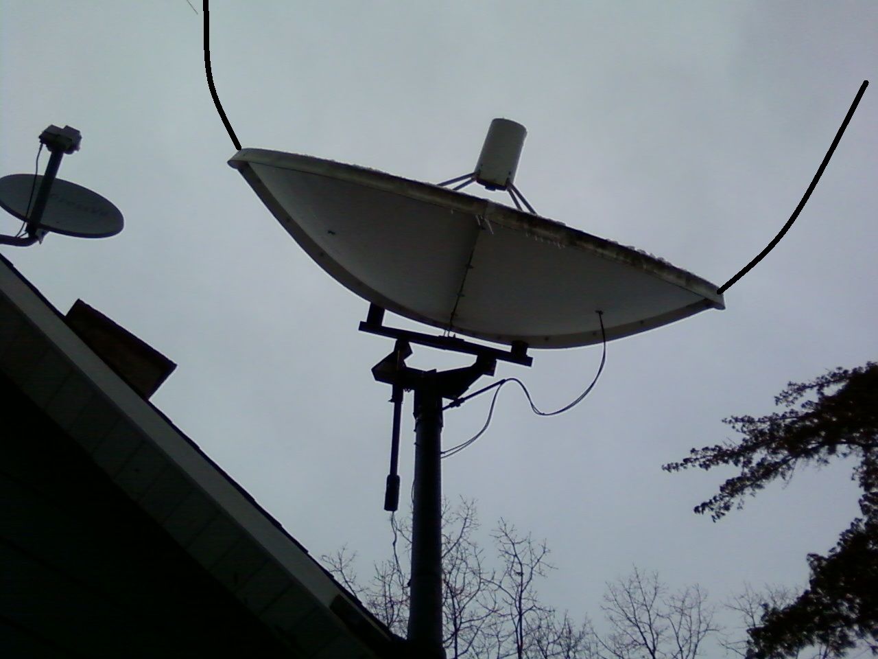

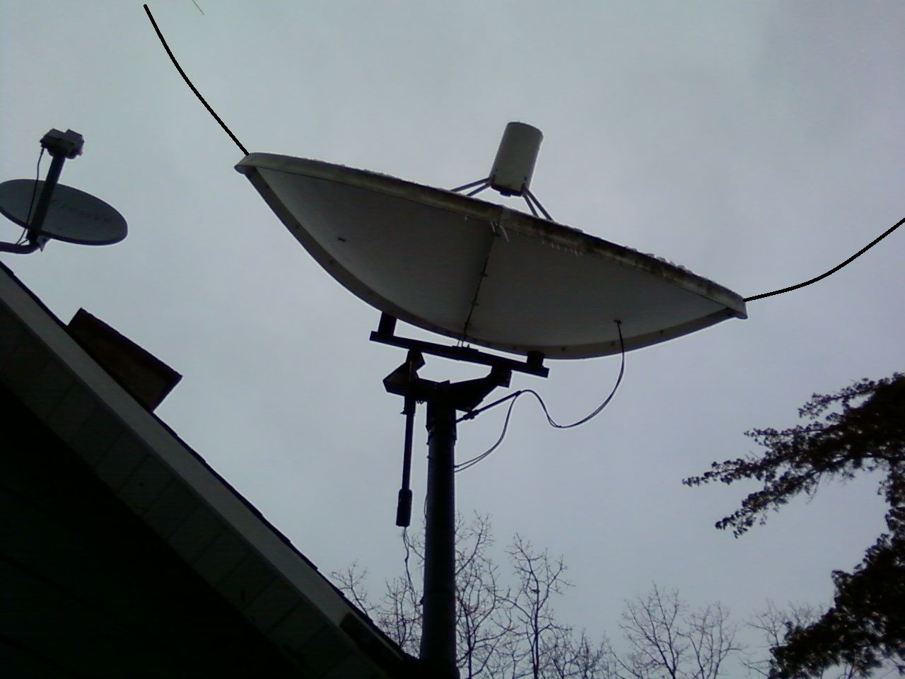

just an update. I gave up on my enlargement project since I followed the f/d ratio exactly with my new sections it really didn't enlarge my dish enough. so the small amount of gain increase say 1db wasn't big enough for all the added drilling and shaping of panels. I found that following the f/d ratio exactly (0.35 to 0.35) only increased my 10 foot dish to 11 feet at the most. So I just figured it would be simpler to find a ready made 12 foot dish. it also could be I couldn't get my head fully wrapped around what exactly needs to be done to increase the size of dish :) after I just simply bolted on my existing panels and followed the original shape it turned out like the pic below called "incorrect". then once I used the parabola calculator program I see it should have turned out like the pic called "correct". You can see in the pic called "correct" following the parabolic formula really doesn't add much diameter to the dish so it wasn't worth the extra effort for me. I hope the pics illustrate things better.
