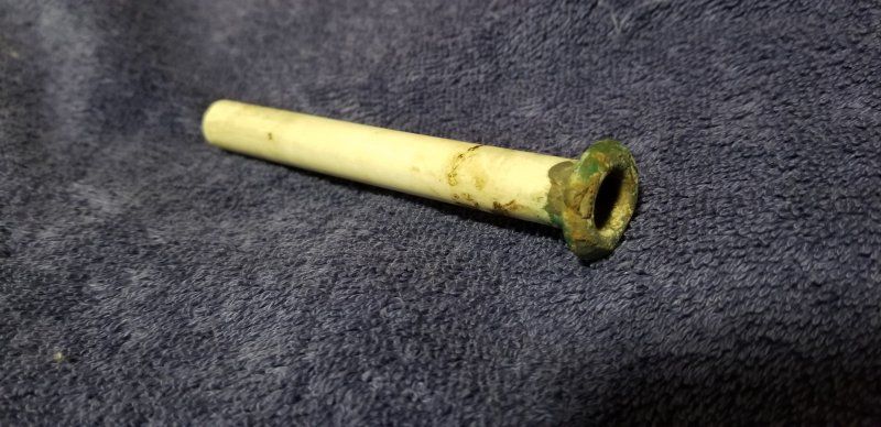

Anyone ever seen one of these?

It goes into the rim joist and it's to protect the cable through the joist. What are they called and where can I get one?

Its a "feed through bushing" for cables and wires. If you Google it, you will find a lot of places they are available. They come in different lengths and sizes
That is an old electrical Knob and tube part!....Wire wrapped around knob, and the tube sent the wire down the wall...
Just go buy some nipples (any length that works) and but matching fiber bushings (which are now plastic) and screw it on the end you need.
Been a long time I even saw those old ceramic tubes!

It's plastic, not ceramic. And it's out of my house which was built in 1950, so no knob and tube here.

My first glance at it was as said here, a knob and tube insulator and I have used them in the past to pass wires through them as you are.
It's similar to a knob and tube insulator, but being plastic, I doubt that's it's original use. Weren't they all ceramic?
I see what your looking at often in older homes, they use to use it for running phone lines or cable lines into a basement in most cases, I believe most of them are plastic ...
We don't carry them so I gotta believe its an item that isn't used or made (at least for that application) anymore.

Probably because you don't need to insulate anymore, it just makes a nice small conduit but honestly they were replaced with "Feed Thru bushings"
