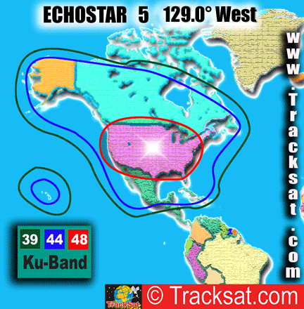

Unless your installer is wearing a spacesuit I don't think he's going to be of much help. The poor installers up here get the raw end of the frustrated customers.
In this area they are automatically installing a separate 24" dish pointing at the 129. It only helps a tad. In other areas it might be the solution. Here in the NW, especially N of Seattle, we're on the edge of the beam, so when it starts falling out of orbit -- 2x an hour -- the signal drops from say 55 to zero and takes 3-5 minutes to recover.
Here's an image that shows the beam and the cut-off N of Seattle, S Texas, and S Florida. It appears from the posts that indeed things are getting worse.
