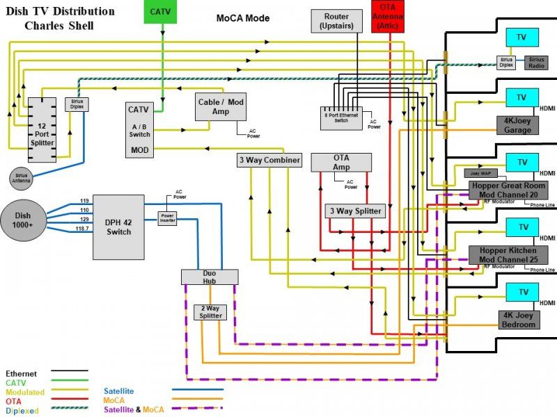

The installer showed up promptly within the scheduled timeframe (10:00 am). He was very friendly and cheerful. I've always found Dish installers to be this way. So a pleasant start to the morning.
Initially, when discussing the work order, he became a bit confused because I told him that he was installing two H3's. His work order said one. I explained to him that he was installing a leased one that he was to have brought and the one that I purchased, sitting on the floor in the kitchen. That was enough to get him to understand what he needed to do. No problem after that in terms of his understanding.
The installer had never installed two H3's. I asked him about the 42 switch and he said it wasn't necessary and that all he needed to do was get up on the roof and exchange my LNB for a duo hub. I questioned him on this and he assured me that it was all that was needed. I didn't arguer back because I don't have enough knowledge in this matter and I figured that if something went wrong, he'd fix it. He then went outside and climbed on the roof and proceeded to install the duo hub. He then came down, went into the basement, and connected all my wires together using what looked like a splitter. He then came upstairs and proceeded to hook up the two H3's. Unsurprisingly, it didn't work.
When the above process didn't work correctly, the installer called in to his offices and asked for help. Afterwards he came and apologized and said that I was right and that indeed the 42 switch was needed with the prior LNB that I had. So he went back to the roof, uninstalled the duo hub and reinstalled my prior LNB, went to the basement, and hooked up the 42. Everything went fine after that as expected. Likely about an hour of his time was wasted, but he did learn for subsequent installs and he was very contrite about not knowing how to do the hookup. It was no big deal to me as I was happy with his service overall.
The two H3's see each other and can access each other's shows. It's just like my H2 systems were before, except it's definitely faster.
