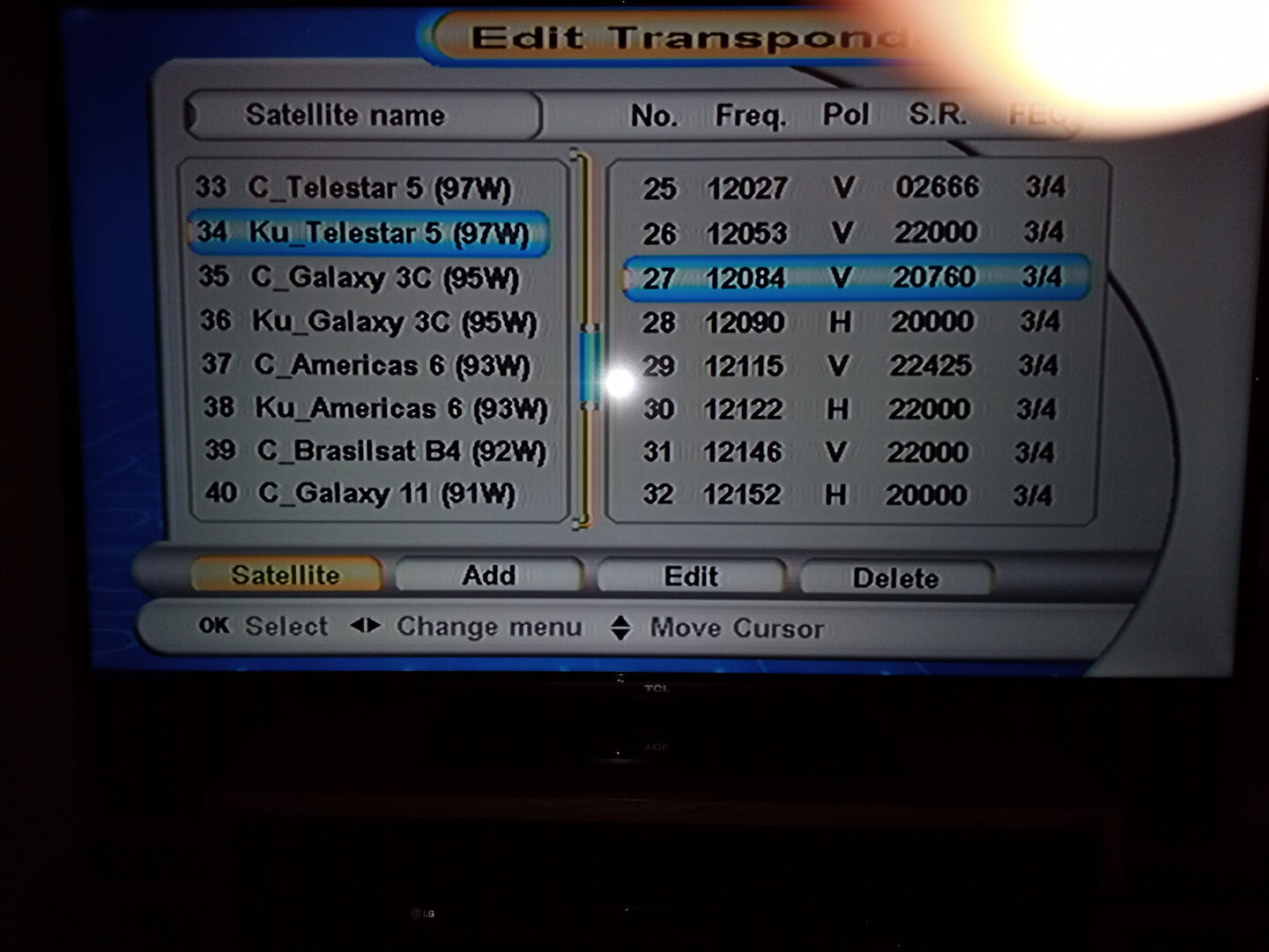

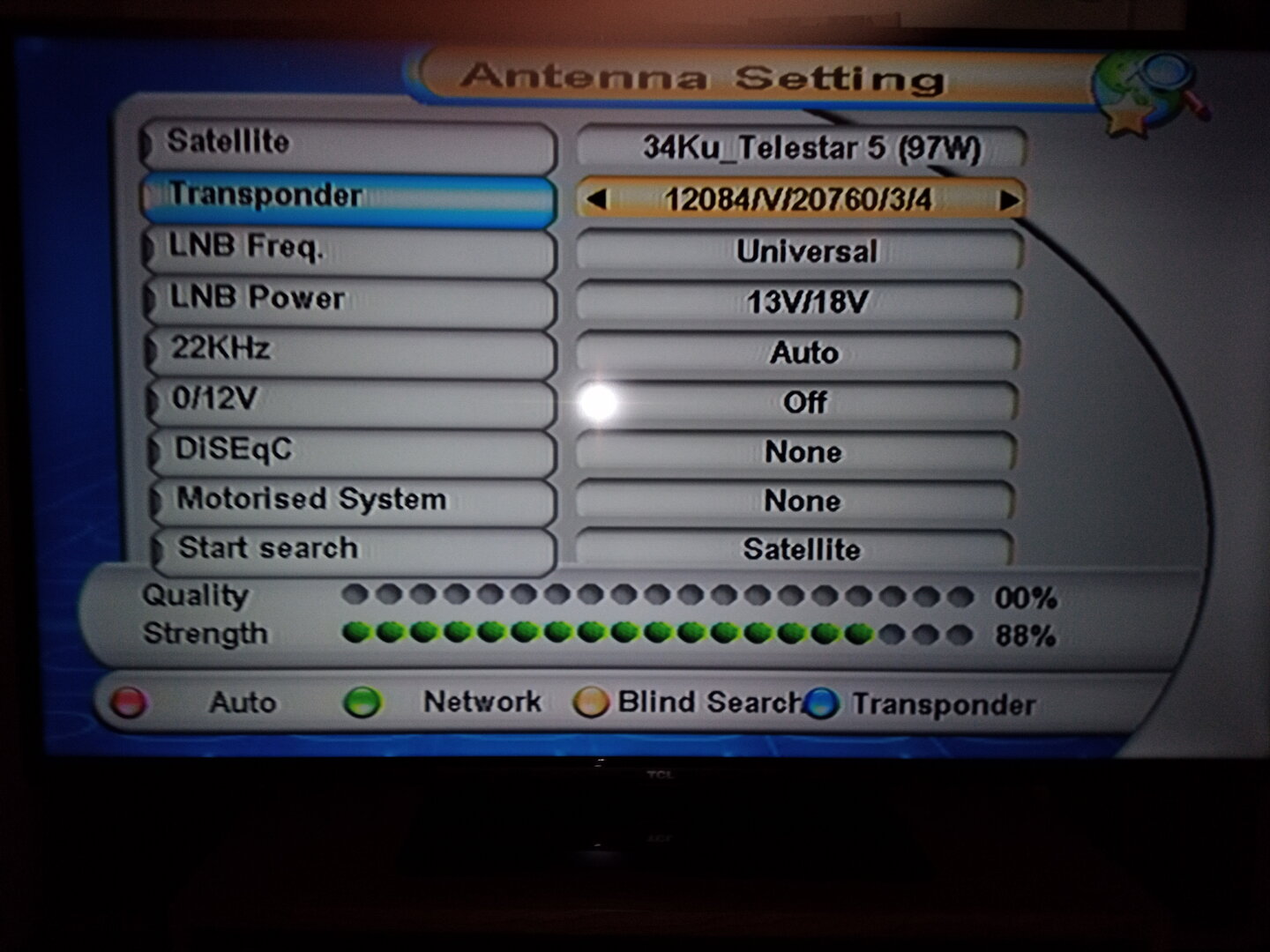

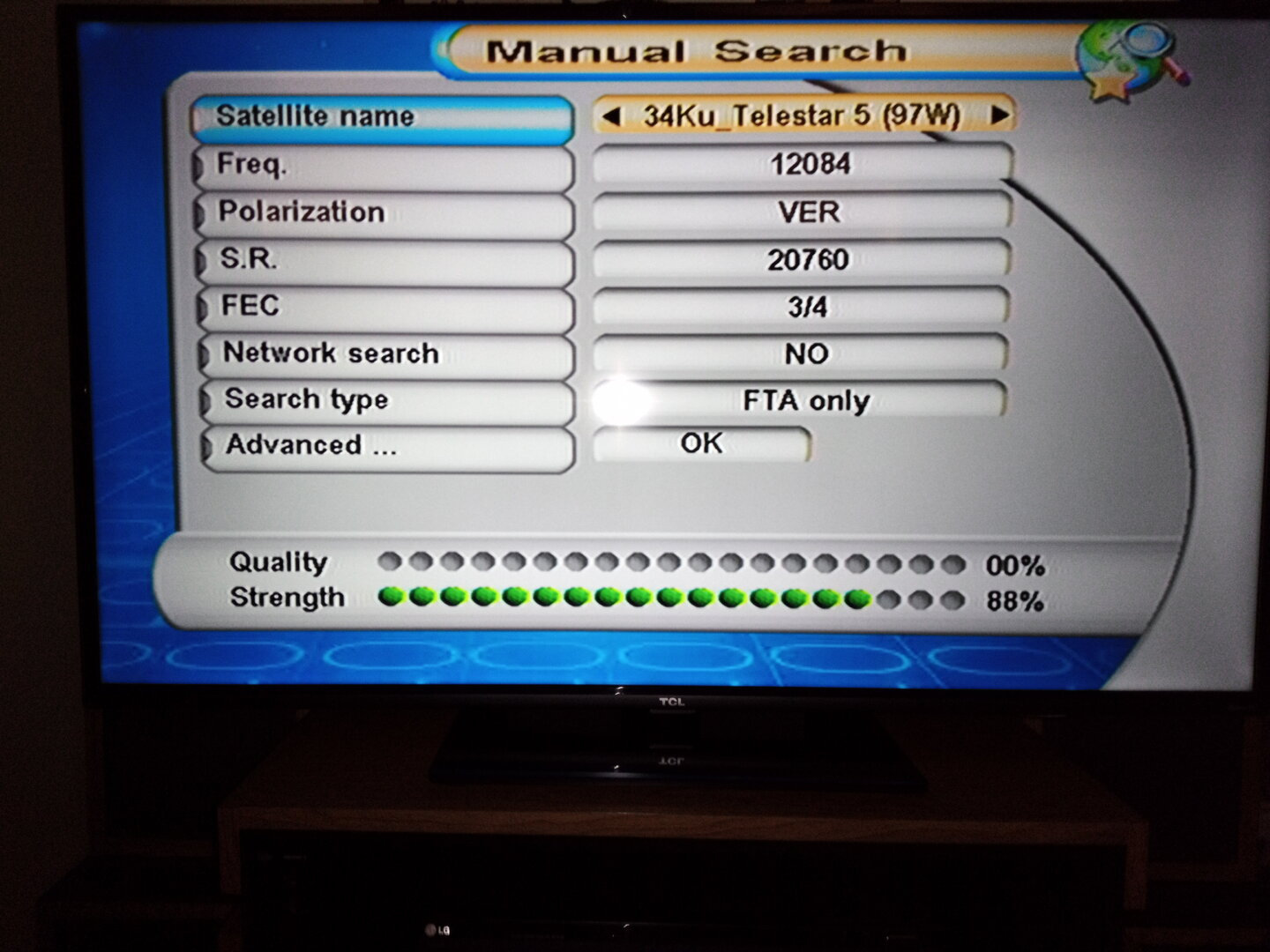

How can I check how many transponders there are ? There is virtual button that says "Transponder" in the menu screen, but when I pushed on it nothing happens. I noticed when I went into the manual setup "Edit Transponder" I noticed that the frequency 12084 V SR 20760 FEC 3/4 was not on the list for T5 so I added it manually trying to get it on transponder 21, but did nothing after another Blind Scan. So deleted all the useless satellites hoping it would shorten the Blind Scans on the list, but now most of the frequencies disappeared ...WTH ..LoL

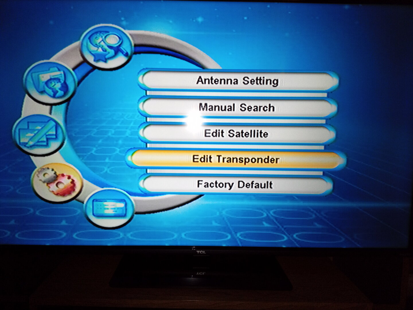

I am not too familiar with my DVB Captive Works Ultima receiver to be honest, since I got it in 2011 I was able to catch CCTV mux without much trouble and never really played with it. I will try to post some photos of the menu screens of the DVB receiver when I get a chance.

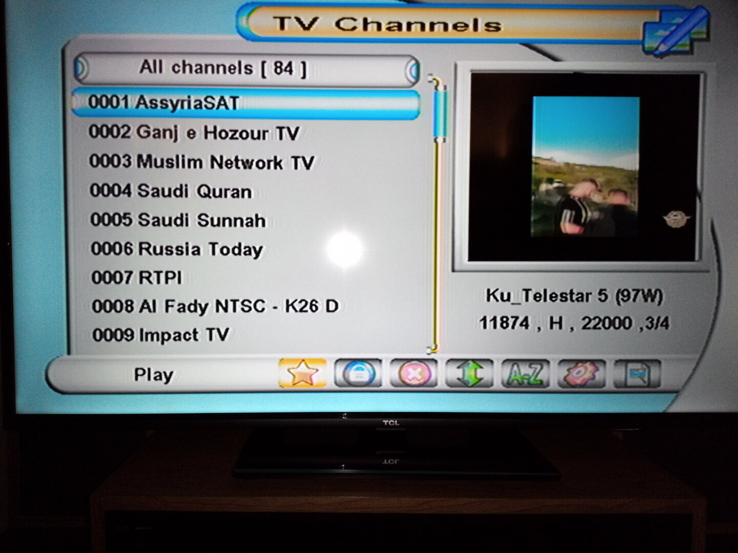

Here are some photos of the menu screen on my Captive Works Ultima:
If AssyriaSAT is located on transponder 11874 H 22000, as your fifth screenshot seems to indicate, then you have your LNB set up incorrectly. AssyriaSAT is located on transponder 12028 H 22000 (there is no transponder at 11874). Your LNB is a standard (LO of 10750) whereas you have is as Universal (LO of 9750/10600). The difference between the two LOs (10750 - 10600) equals roughly the 150 you have to add to 11874 to get 12028 (actually it is 154 difference, but a few points here or there doesn't matter).
I would change the LNB to standard (LO of 10750) and delete all the transponders/channels for 97w, and re-scan. Also, if you have scanned in 84 FTA TV channels for 97w (again as the fifth screenshot seems to indicate), you are missing some channels (I get 103 FTA TV and 2 scrambled TV channels). There are ten transponders with TV channels.
Agree with Keith on settings change. Perhaps a bit more tweaking on the dish will be required as well to get it exactly on 97W.

It might be useful to know what exactly are you using for a feed.LNBF or LNB with polarotor or orthomode feed?If polarotor,what is controlling the polarity?In any case,is the skew set correctly?Are you using standard or universal LNBF/LNB?
C-Band LNB: Aspen Eagle, Range: 3.4-4.2GHz, Noise: 17Deg, Gain: 65dB
Ku-Band LNB: Norsat 6605A GM-6921, NF: 0.5dB, Gain: 58dB
Feedhorn: ADL DP3A
Feedhorn: ADL DP3A
Hard to find the specs for the Ku Band LNB, but I did see a Norsat GM-6921 listed as a Standard LNB (with a LO of 10750).
Easy to check, just delete all transponders for 97w, change the LNB from Universal to Standard, blind scan, and compare the channels with the transponders here: Galaxy 19 at 97.0°W - LyngSat

I don't see there is a "Standard" option, if I move it from "Universal" it starts giving a slew of numbers like 5150 etc... after each press.
When I checked the transponder list on the T5 satellite it doesn't list the 12084 V 20760 3/4 so I added it manually and that didn't do anything as well. Will it automatically find the transponders if I delete all the listed transponders from the list ? I also changed DISEqC from Auto to LNB1and LNB2 and it didn't do anything as well.
I will try to change LNB to standard (LO of 10750) and delete all the transponders/channels for 97w and re-scan and report back,
