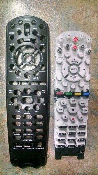

I have swapped out six defective 40.0 remotes with DISH thru the years. I tried several things and never could get the sticky keys to act right. When I tore one of the defective remotes apart I was expecting to just do some more cleaning. But the buttons are made out some kind of rubber material on a solid mold for all the keys. (see my pic in post #2) I think the rubber has gotten weak from use.

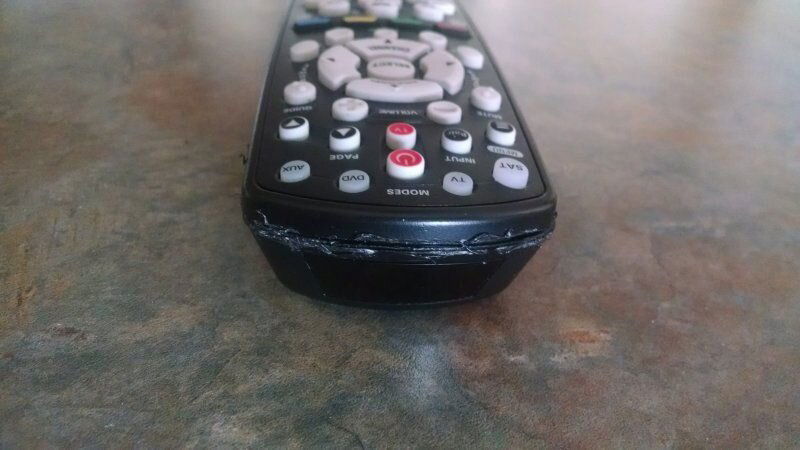

I would except I have a Hopper 3 so they will only send the smaller 52.0 remote. I actually already figured out how to do it from watching a youtube video... The problem is when I pry it, I leave marks all over the side as I did yesterday but the remote works fine now except the remote feels weird in the hand with the plastic being broken from the screwdriver. On the youtube video, the guy basically was able to do it with a screwdriver and not leave any marks. A question, is the On Demand button on yours a separate piece as on mines, the On Demand Button, the one that says DISH seems to be a individual button while all the other buttons are on the same sheet.

I actually have the iFixit 70 piece classic ProTech toolkit that I completely forgot about until you mentioned the toolkit so I used a screwdriver to pry instead and left marks all over the side of the remote. Seems like some people like the Youtube video above can pry with a screwdriver without causing any dents, marks, etc.
The replacements are only free on the protection plan but the problem is they will only ship you the same remote that shipped with the receiver you have so in my case, my 40.0 remote came from the Hopper 1/2K which was upgraded to a Hopper 3 so the only remote they will send is the 52.0 as that was what shipped with the Hopper 3. Mines was not the rubber with the remote but rather in the middle section where all the DVR keys are, there was a film of sticky liquid on both the button contacts and also on the circuit board. Cleaning it with 70% Rubbing Alcohol, air drying it and then applying a layer of Caig DeOxit D5 to improve conductivity and protect fixed it, remote is as good as new except for the physical dents from prying with a screwdriver.
