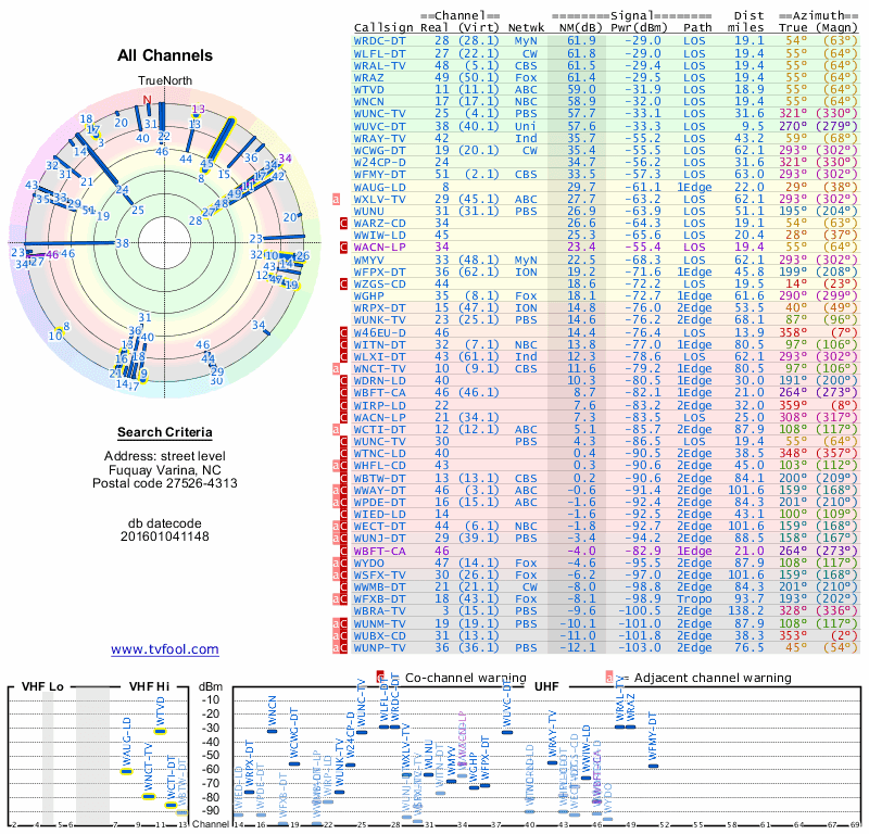

I did the TV Fool report. I've normally been able to pick things up from the top of the list down to WUVC with no problem through the AM21.

Ok one more question, what kind of antenna are you using and is it amplified? Most of your stations are very strong, they could be overloading the AM21. Yes I know it doesn't make much sense that it worked fine with the 34 but not with the 54. However the fact that it completes setup fine without an antenna attached seems to prove my theory about it being a scan/stream issue correct
I have one more idea you can try. Do you have an extra coax cable (3 foot, 6 foot, etc) laying around? If so try hooking the coax cable to the antenna input on the AM21N, and run the setup. Just let the cable act as your antenna and see what happens. I think as strong as your signals are it might receive enough of them to make the AM21 recognize the stations. If that works, choose the stations you want to include in your guide, and then hook up the Leaf and use it without re-running setup.
Your signals are very high. I know the Leaf isn't much, but with it being amplified signals in the 60's could definitely be overpowering the tuners. Why the 54 is more sensitive than the 34 I don't know, but it is the only logical explanation.
