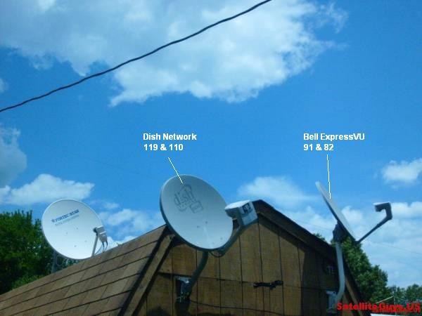

Just a note on dish size,
I get 91 and 82 on a Dish 500 excellent here in West Virginia!
Just testing those TP's on two STB boxes a bit ago.
Bell ExpressVu on Nimiq 1 91 Signal 96 Quality 92 % 12399 on a Coolsat 6000
Bell ExpressVu on Nimiq 2 82 Signal 91 Quality 88 % 12268 on a Fortec Lifetime Classic NA
That is using the Dish Pro LNB on the 500 also! The VU HD Promo comes in booming with that LNB! If I wanted to use this size dish getting a lnb bracket system on it to get them both in at the same time might work without using the Pro LNB, but would be tricky. But there is a hand full of FTA stuff on them that makes it not worth it unless you had a sub.
I tested that one out years ago when I heard you needed a 75 CM dish or bigger to get those birds. I had to try the 500 to see for myself! Yes, it worked! I still have the dish pointed there today just on the 91 side. At least for my area you can use a smaller dish for bell.
I don't know about using a 500 in the lower US but it comes in just fine here on that dish size! My guess it would differ to what state you lived in!
