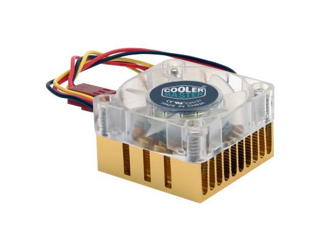

If you aren't afraid to open it up, do so, and to a computer mod-shop or parts store (or order online) a Northbridge/Southbridge heatsink. They're about 1.25" square, and attach using thermally conductive adhesive. That should cool the decoder chip plenty.
If it's the tuner getting hot, that's a different problem......:confused:
Similar to this (without the fan)
http://c1.neweggimages.com/NeweggImage/productimage/35-103-155-01.jpg
You can probably even find one on an old PC you have around (if you have old PCs lying around):eureka
