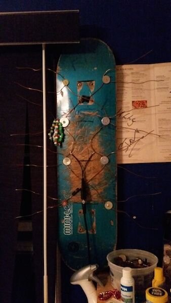

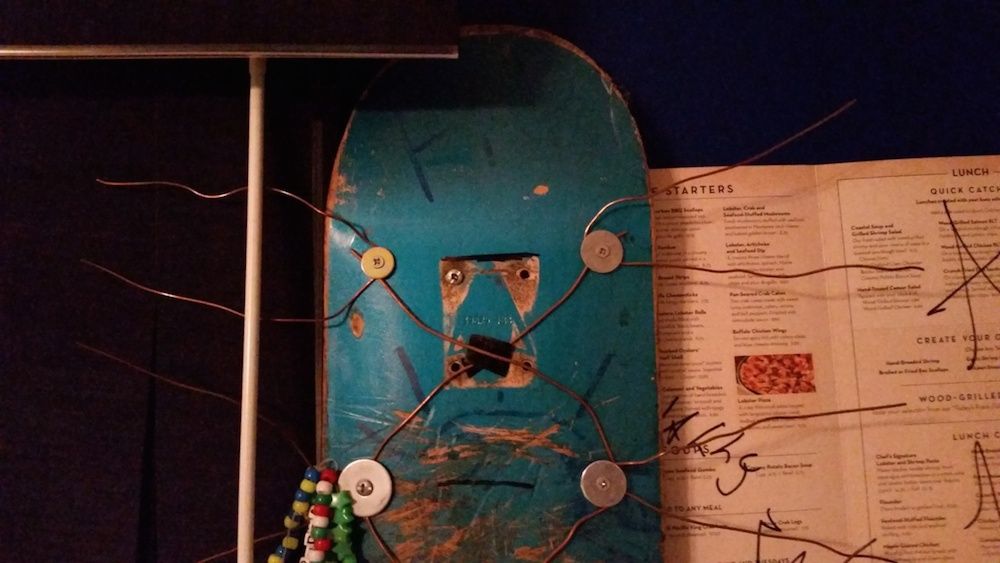

Kizzer Try this in your spare time...if you have a kid that skateboards, that is. ;)
Seriously, my son made this and works really, really well. He is almost 21 now and about 5 years ago the Tesla incarnate child asked me if I had any spare wire.
"What kind?"
"Large maybe??"
"In the basement."
Five minutes go by.
"Dad, where's your drill??"
"In the basement!"
Few more minutes pass.
"Dad, whe...."
"IN THE BASEMENT!!"
After some time of hearing drilling, cutting, curiously quiet time, more drilling and a bathroom break, it stopped. I didn't think anything of it and went about my business. Then a few days later I saw this Frankenstein centipede hanging in his room. Damn near got whiplash from my head twisting in wonderment..or maybe fear. Couldn't tell at the time.
"What the hell is that?!?!"
"It's an antenna for my TV. I made it with an old skateboard and wire. And it works, too!"
Well I'll be. It does. Now, before I ran off trying to get college scholarship applications for this chip off the ol' block, I did ask and he said he saw videos on YouTube for this and made his own version. Still, amazed he made it. At least he wasn't watching porn online. I hope.
