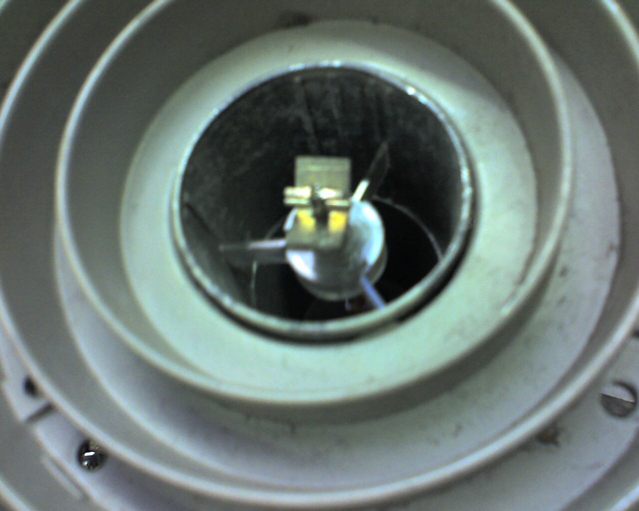

Hey Mike,
If it were possible to show you a Corotor II from about 10 years ago versus one made and sold recently, you would notice a mechanical difference in the Ku probe.
Here is a Co-Rotor II wave-guide mouth that was manufactured prior to 1995.
It is quite different than the probe that is on the newer models. This is the one I have installed on the Birdview.
I can't believe I don't have a picture of the Co-Rotor II mouth that I purchased new and installed last summer.
If someone else doesn't have one, I can climb up and take a shot.
Fred
If it were possible
Ku probe.
Which would this be the original or newer design?
