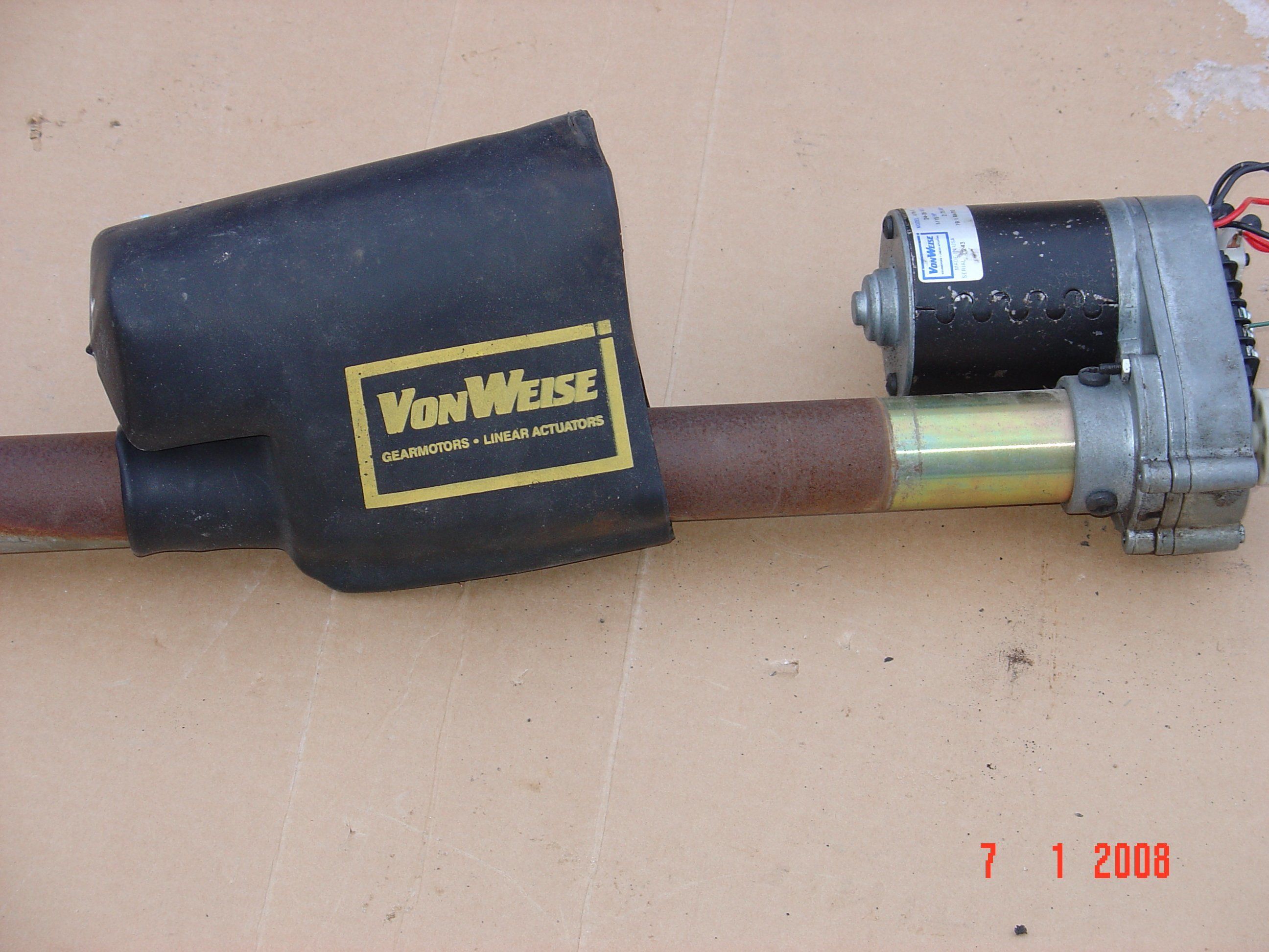

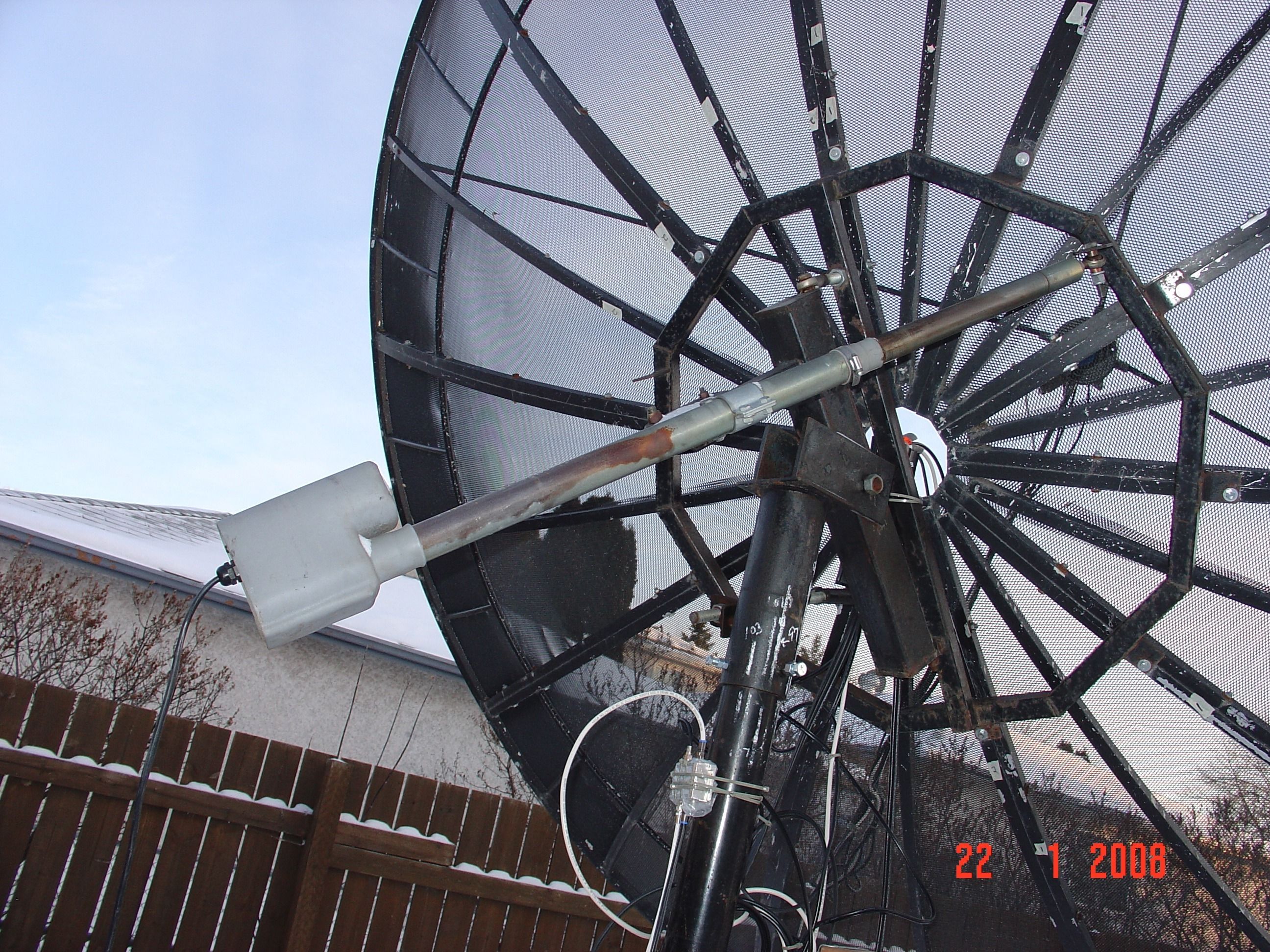

Thanks Anole, I agree that $200.00 is a steep price to pay for an Actuator. Well here's the Deal: I have 3 Actuators none of which work properly.
1) The one on my 12 Footer - the Von Weise runs with +12VDC Battery Charger, but already stuck once already in Feb. It won't work with my old Uniden 9900 Receiver or My VBox III Controller. See Pic #1.

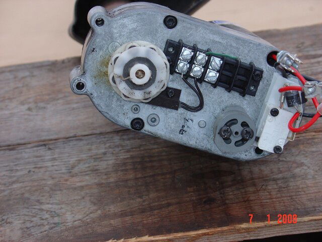

2) The Actuator from the scrapped house where the Strip Mall is now being built, it's an old Von Weise and was running with the Battery Charger before, but now will NOT run for some reason!! But it is a 4 wire unit so it would likely work with my V Box III, see pics 2 and 3.

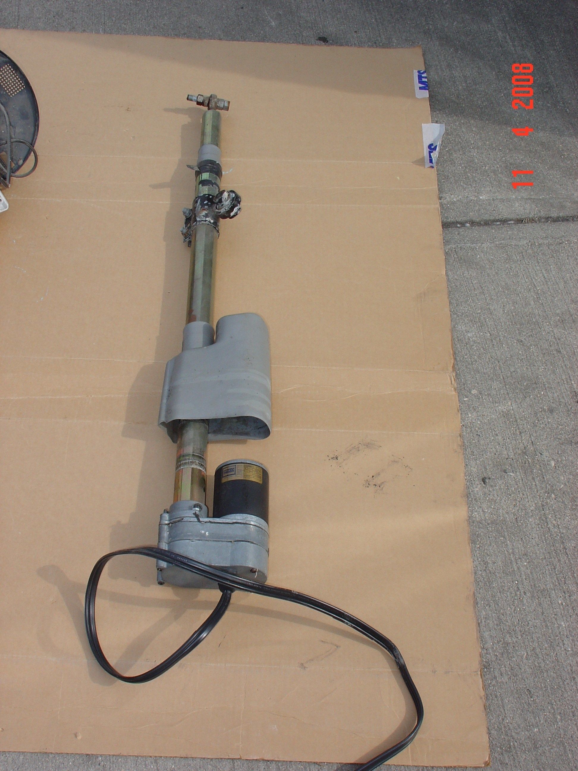

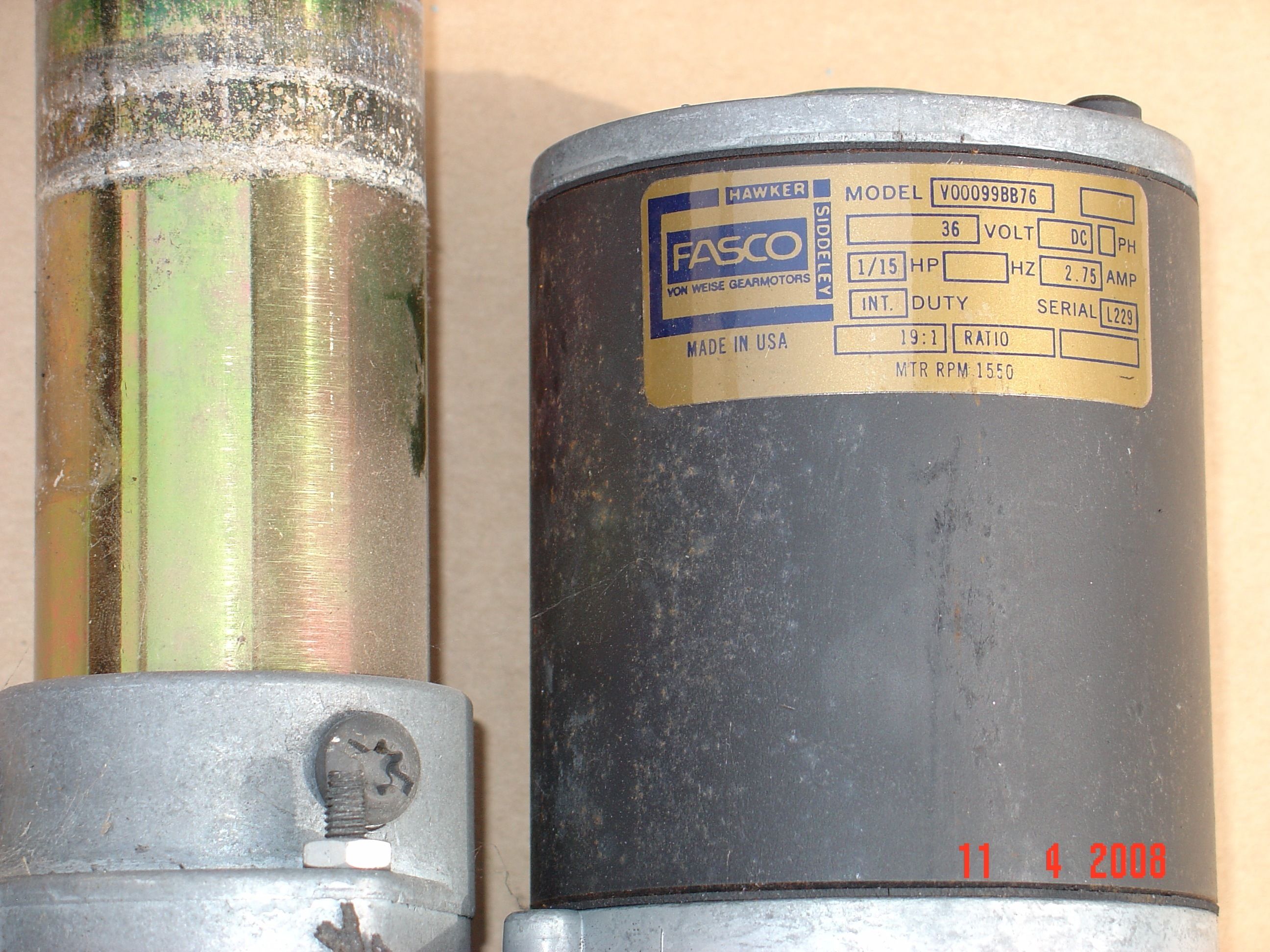

3) The Actuator that came with the 7.6 Ft Unimesh Dish I recently picked up. See pics #4, and 5. It's some kind of Fasco / Von Wiese type Actuator. But when I tried to Power it with the Battery Charger the unit does not move the shaft ...... the whole thing moves in a circle so it seems to be stuck!!
My best bet would likely be (if I don't buy a New Actuator) - to try to somehow convert the working Von Weise Actuator on the 12 Footer right now from a 5 wire Optical Sensor unit to a 4 wire unit - maybe somehow with parts from the other 2 non working Actuators. Does anyone know is this type of retrofit can be done to get one working Actuator?? Any replies would be greatly appreciated.

Thanks for the great info George. The Actuator from the 7.6 Ft Unimesh was a 36 Volt Fasco / Von Weise, (see the closeup pictures of it in my previous post) but it didn't seem to be working when I connected up the 12 VDC Battery Charger to it ... instead it moved in a circle, - BUT it does have a type of Circular Bushing on it that Anole mentioned, so am I testing it correctly? That is can this type of Actuator be tested on a Bench OR does it have to be mounted on a Dish to see if it works??
the way mine worked , unless something held the end that connected to the dish it would turn in a circle. so it would need to be mounted or held to extend the arm.
notice that screw that holds the motor onto the actuator arm if you loosen it, it will allow access to the arm & screw shaft which is connected with a shear pin if you remove the shear pin it will allow you to disassemble the whole shaft. you should be able to swap the motors between units.
George thanks for the info. So maybe the 7.6 Ft Dish Actuator - if it turns in a circle when I put power to it on the Bench with the 12 VDC Battery Charger is okay?? I wonder if I should try to swap motors with my current Actuator in Pic # 1 above, or just try to clean up with steel wool and jig a loo lubricant and reuse the 7.6 Ft Dish Actuator in Pictures 4 & 5 on my 12 Footer?? It is a 36V unit and I believe it has similar specs to my mounted Von Weise Actuator on the Dish, so would it handle the 12 Footer? Any comments would be appreciated.
i think i would just try the 7 1/2 ft actuator on the 12 ft dish
you can knock off some of the rust but its basically cosmetic unless it obstructs the shaft from returning inside the main shaft. the acme screw is what would need lubricant/grease and the little bushing that rides on the screw. but i've always lightly oiled the shaft and i'm sure it only attracts dust. mine had no seal at the arm end just a dust cover/boot to cover the end.
if it is a 24 inch actuator then your in business :)
Have you taken the 5 wire actuator apart?
It could be a 10 turn pot. (not an optical).
Also, the shaft will come off of the motor assy. (screws at the base hold it in place), so you could just replace the shaft if the motor is still in good working condition.
I have a 36" venture jacks on both my dishes. I paid around 150.00 for each. 36 pulses per inch. work good for ku tracking. Both mine are rated 36V. my receiver however puts out 24v.
I would imagine that by the time the 24V gets to the dish (200 ft) it has dropped a few volts also.
No problems at all. Works great.

Thanks a lot for the replies Gabshere, Trinity and Truckracer, I'll clean up the 7.6 Ft Dish Actuator and give it a try. Beautiful sunny 75 degree weather finally up here today and scheduled for tomorrow, so some garden planting is also on my agenda for the next couple of days.
