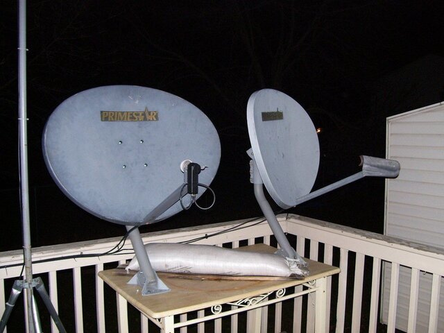

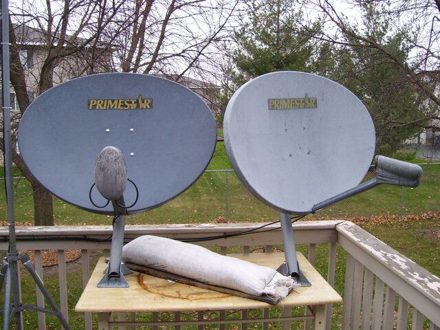

Yes they work GREAT for FTA. The LNB should be fine too. Check on the LNB itself where the coax is if there are separate V & H outputs. Alot of the dual output ones are like that. One output is vertical only one is horizontal. So you will need a 3x4 multiswitch to combine them
I use to have 2 of them set up

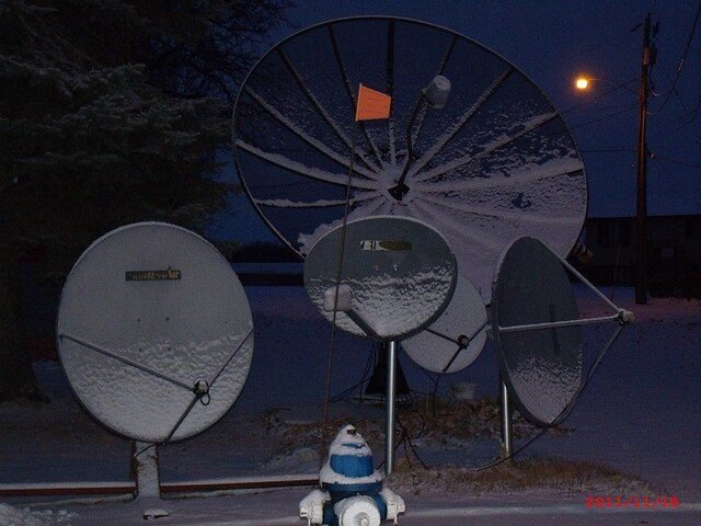

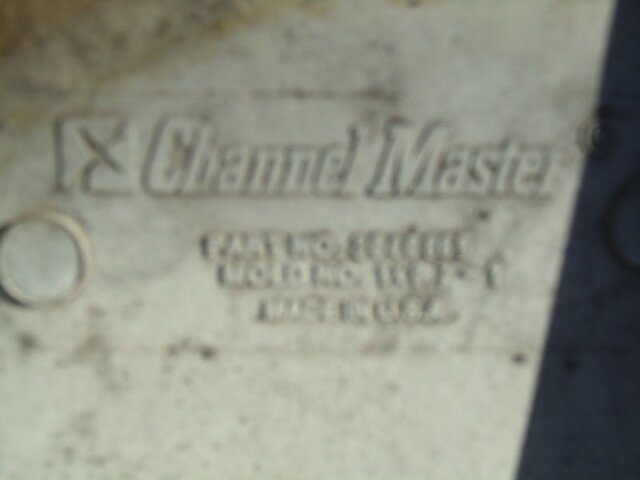

All the big little ones and the odd shaped 84e are ex-Pstar. There should be some numbers on the backside of the dish that will tell us what it is.

I've got one and it is a .75 Channel Master. One of the very best dishes I have.
Makes a great dish to motorize with a DG380 motor.
