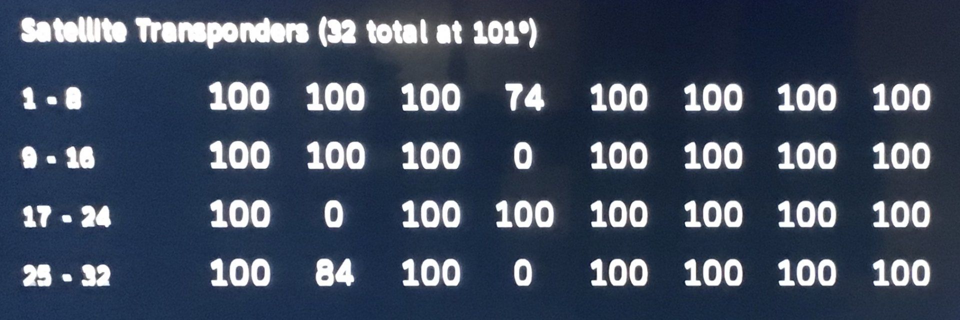

C CSM SatelliteGuys Pro Aug 28, 2015 1,317 421 Chesterfield, MO Jul 21, 2020 #1 I noticed a couple of zeros. Thanks for any info. Attachments 43D74F96-AF57-43FC-B7C5-C7E3129B4A7F.jpeg 147.7 KB · Views: 359 E60D71FD-73B4-43A2-B032-2219902D47A1.jpeg 155.6 KB · Views: 336
H HoTat2 SatelliteGuys Pro Jun 12, 2012 1,303 346 Los Angeles, CA. Jul 21, 2020 #2 Yeah ... Those all look fine. ... The zeros and other sub-par levels on the 101W screen are from out of market spotbeams. ... Sent from my LM-V600 using Tapatalk

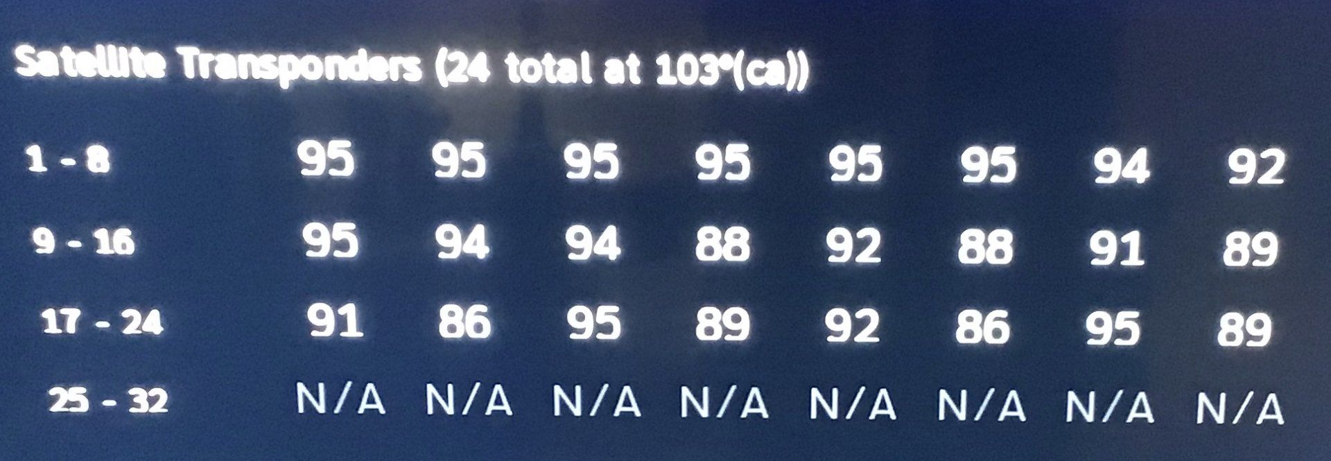

Jimbo SatelliteGuys Master Lifetime Supporter Jul 14, 2005 70,630 9,081 NW Ohio - Buckeye Country Jul 22, 2020 #3 Yup, they are good ... Take a look at the other Sat as well while your looking . You got the 101 sat that they start with and the 103 Sat looks good as well, how about the 99 Sat, it should be very similar to the 103.

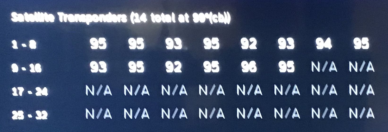

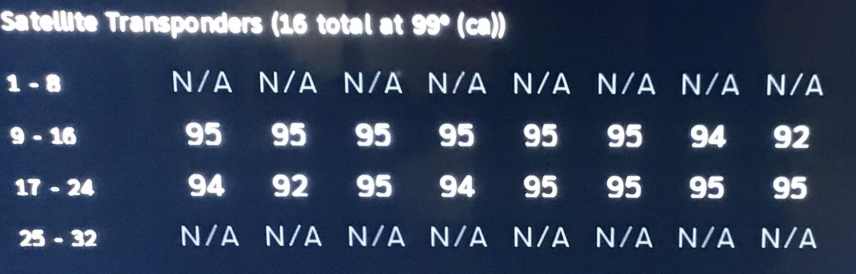

C CSM SatelliteGuys Pro Aug 28, 2015 1,317 421 Chesterfield, MO Jul 22, 2020 #4 Hers are the other signals. Attachments 96099A99-6F8E-4F8B-86E8-32D68034C904.jpeg 118.7 KB · Views: 314 8A1B9CC5-0850-4BDD-A328-BCC6E9EC0498.jpeg 109.9 KB · Views: 359
raoul5788 Studebaker driver Staff member HERE TO HELP YOU! Supporting Founder Lifetime Supporter Dec 28, 2004 33,150 18,477 Cheshire CT Jul 22, 2020 #5 Those are excellent, couldn't get much better. Reactions: TheRatPatrol
