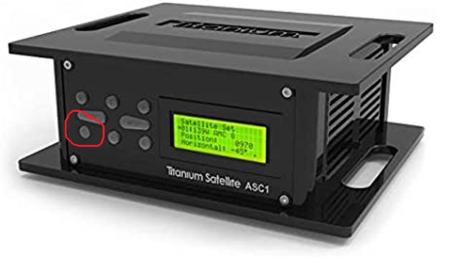

The sensor is behind the little window circled in red. Also, have you tried unplugging it for a few mins and plugging it back in? As, a last resort you can do a global reset.

Hi All,
I MIGHT have solved the problem.
On closer inspection of the IR sensor on the front panel, it seemed to be not totally flush with the opening in the front panel. I may have inadvertantly pushed the sensor out of alignment while cleaning the unit.
After realigning all is well...I hope.
John
