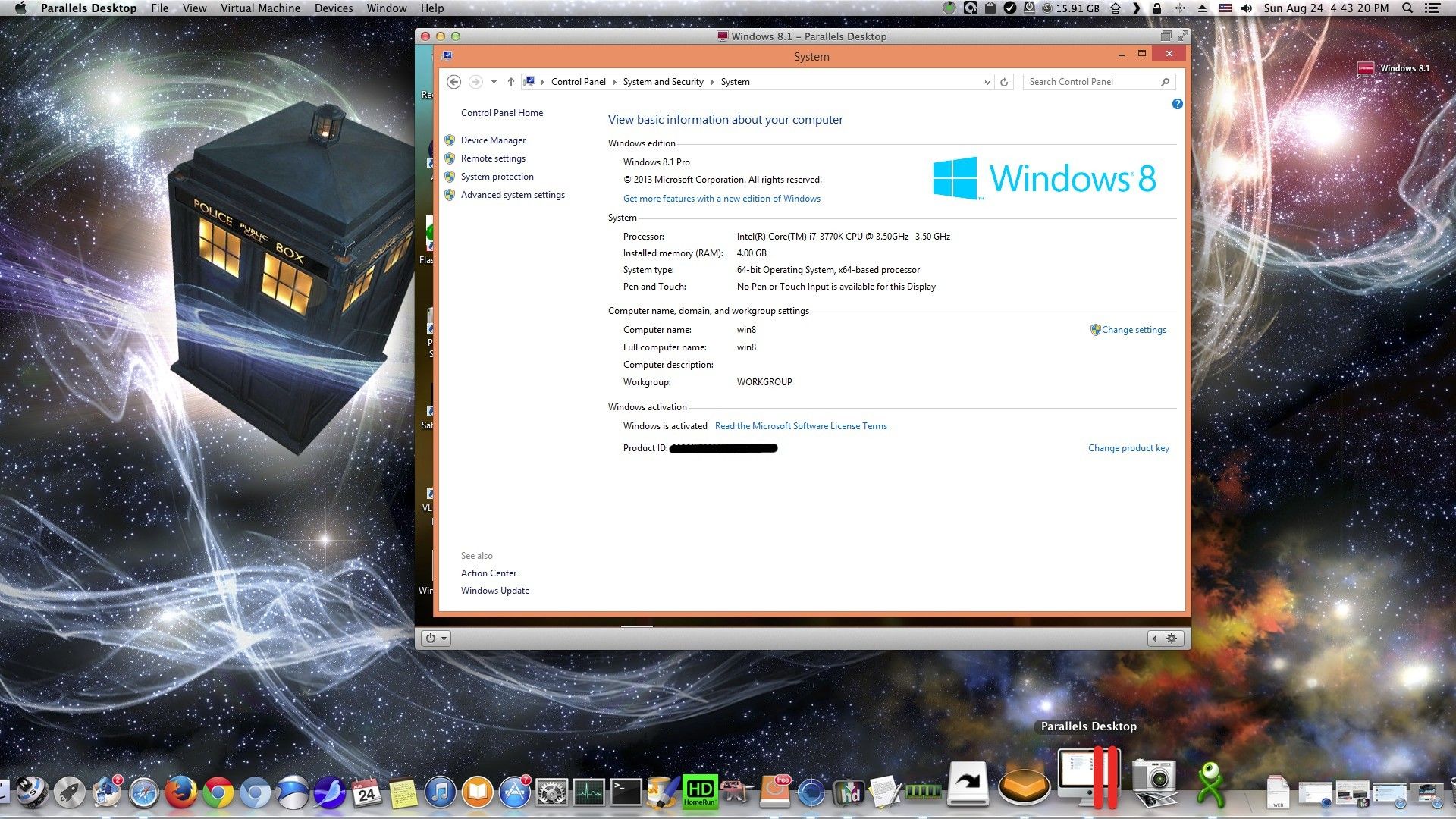

It appears that you have to program it with a windows computer and that the computer has to have a serial port.

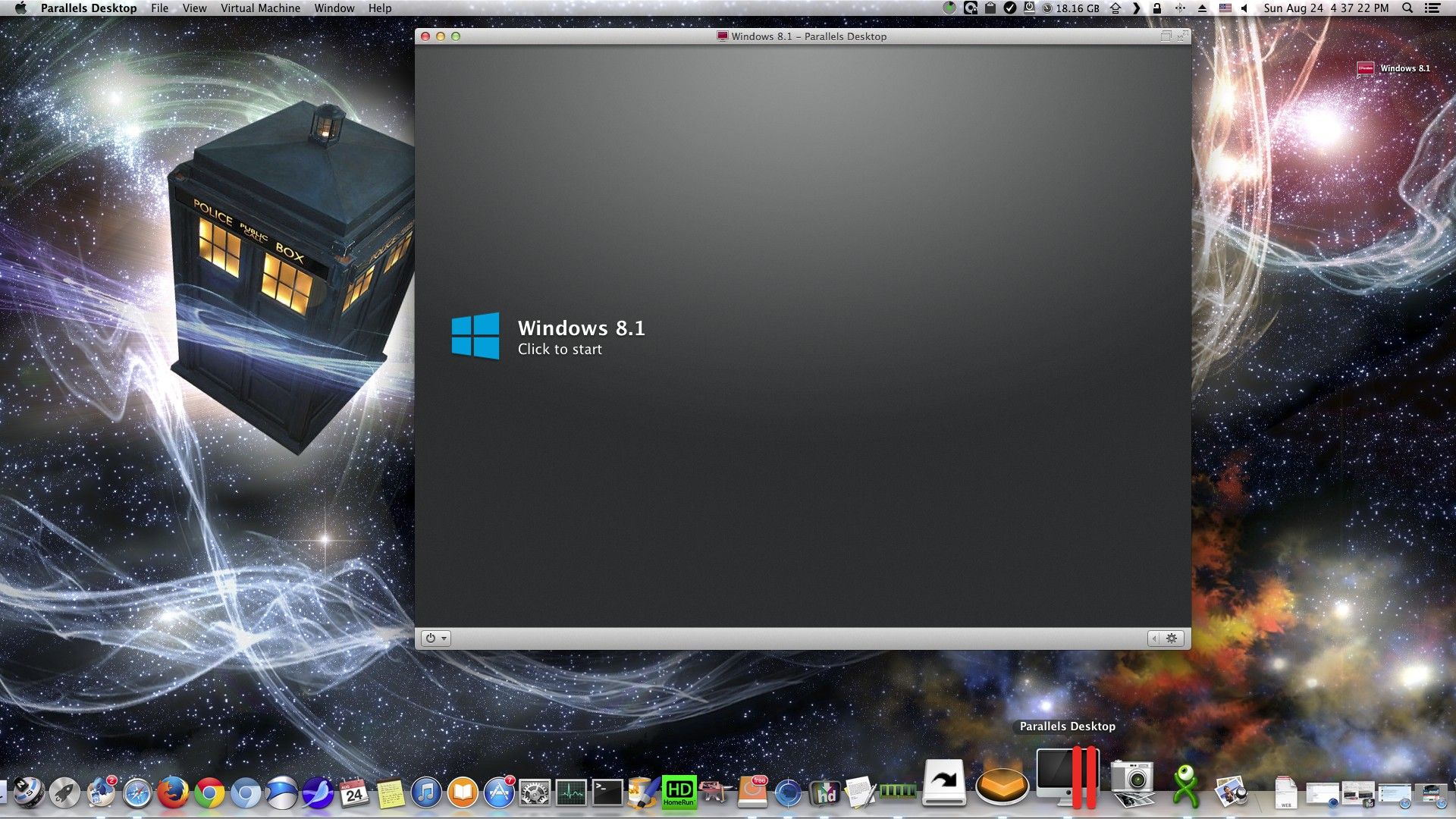

I have Windows 8 running in Parallels on my Mac. I installed the apps for my AI Turbo S2 meter and it worked fine, I was able to download an update and everything.
But it uses the USB port. My Mac, does not have a serial port at all. It simple doesn't exist.
How would I be able to program an ASC1 considering my setup, Windows 8 on a Mac with no serial port?

I wonder if you ran the loader in Compatibility mode under win8 if that would work?

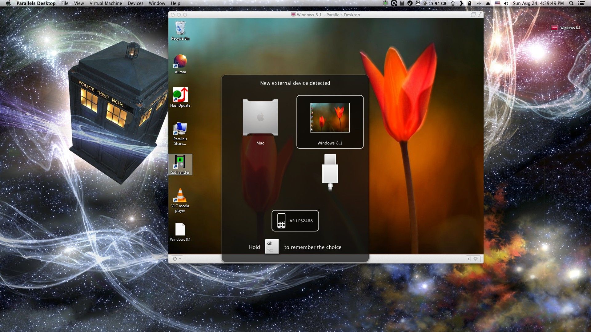

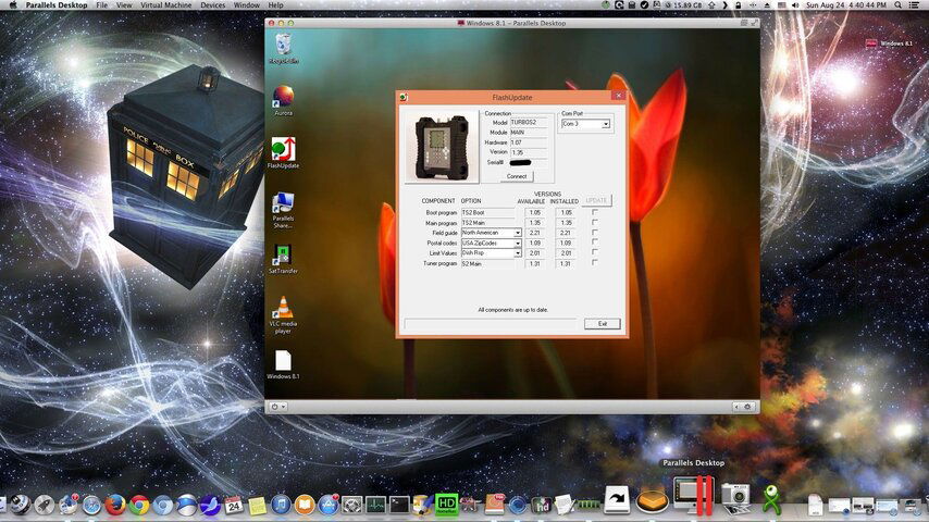

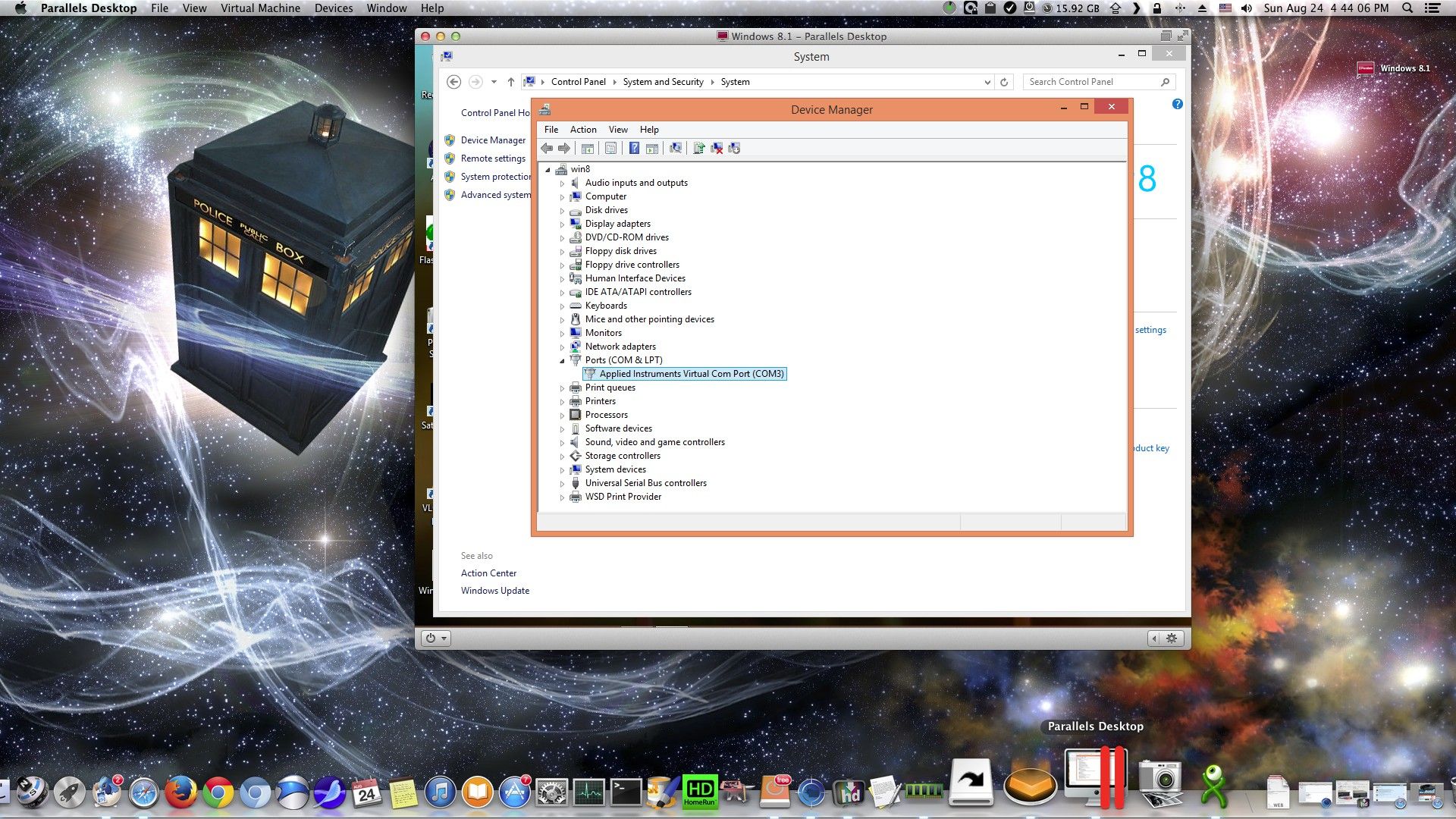

I had to install a driver which is supplied by AI that assigns "com3" to a USB port. Or something like that. Not sure how it actually works but that's what you have to do, on ~any~ windows PC.
Anyway, after MUCH grief trying to figure out how to force windows to allow the non microsoft approved app to install itself I got it working perfectly.

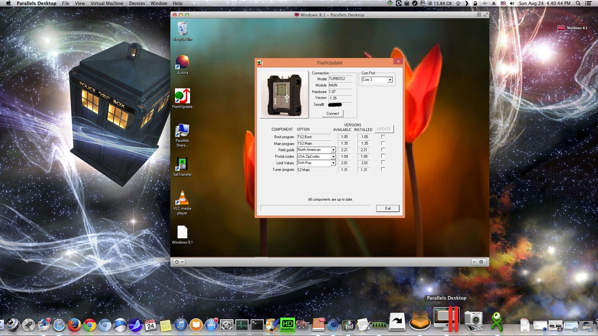

It sees my meter when I plug it in, asks me what I want to do with it (I set it to always connect via windows). It will download stuff from the meter and does updates.
AI offered an update last week which I did on my Mac and it worked perfectly.
