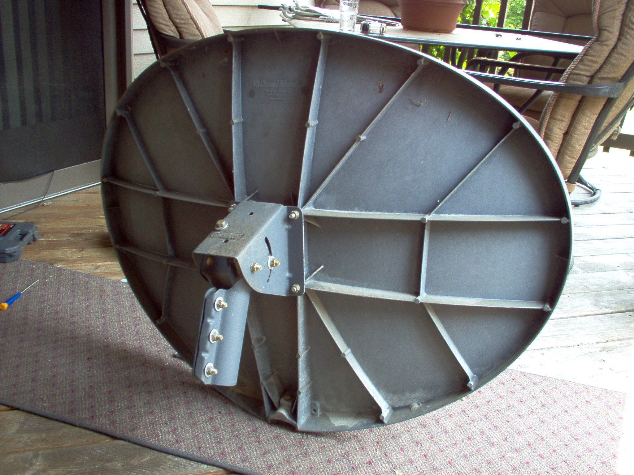

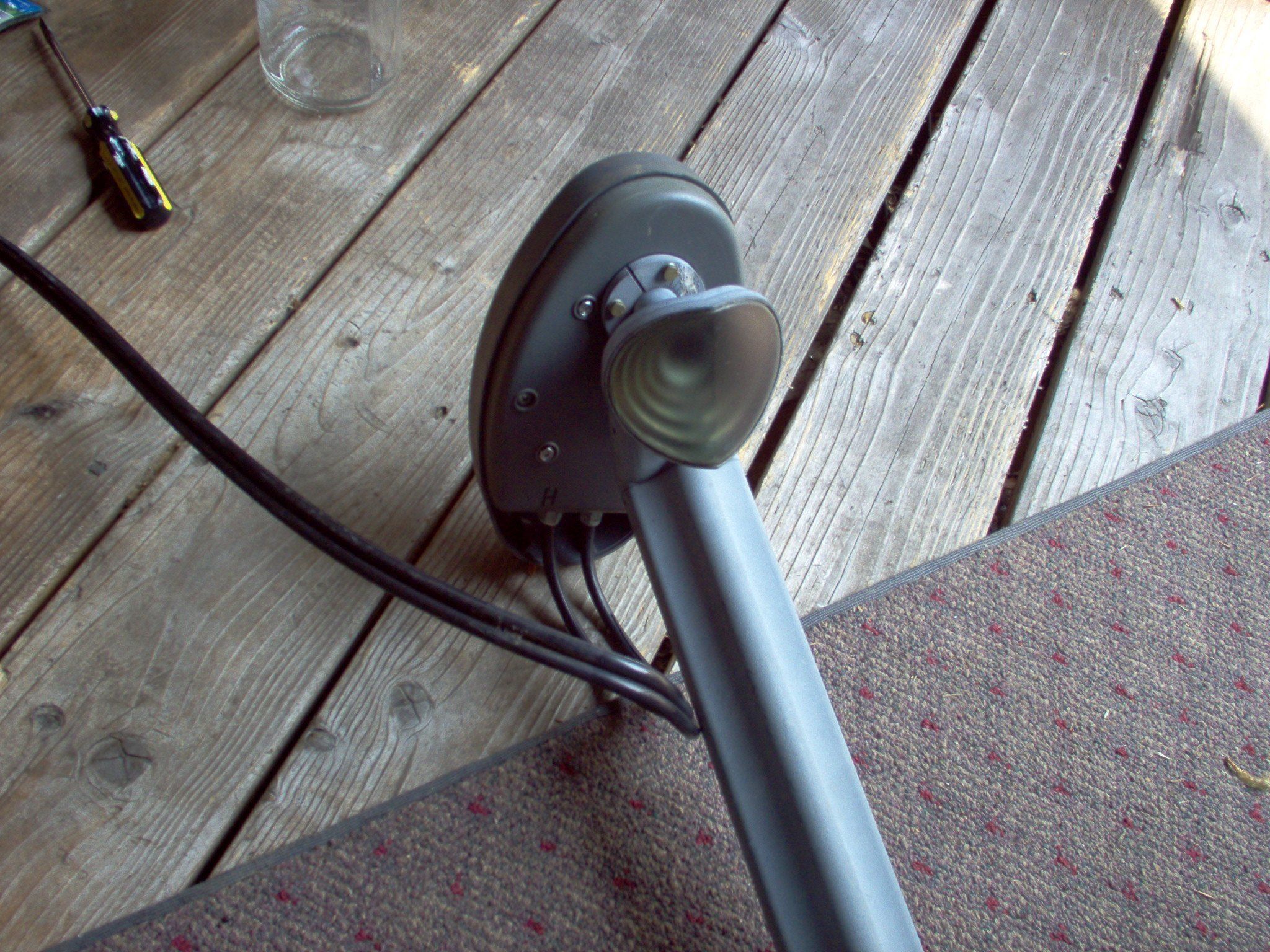

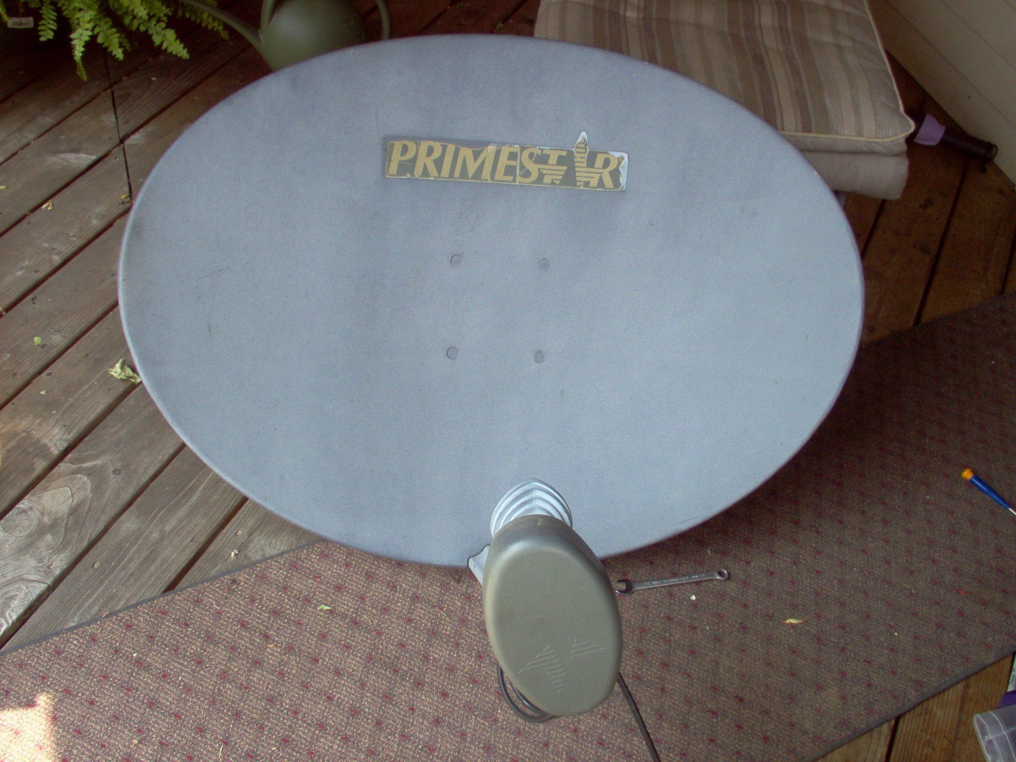

Seek and you will find your dish!. Well, i finally picked up my first Primestar (Free Of Charge) from a client of mine who was very happy to see it go away.
Im very thankful for the wealth of information you guys have posted on this gem.
I'm gonna try to do a "retrofit" to a smaller pipe since the original looks like it's 2 or 3 inches. Maybe a motor in the future?? I'm kind of confused about setting the skew for this but it should be easy.
Anyways, I'm posting some pics for the group to see. Looks like a 40x30:D

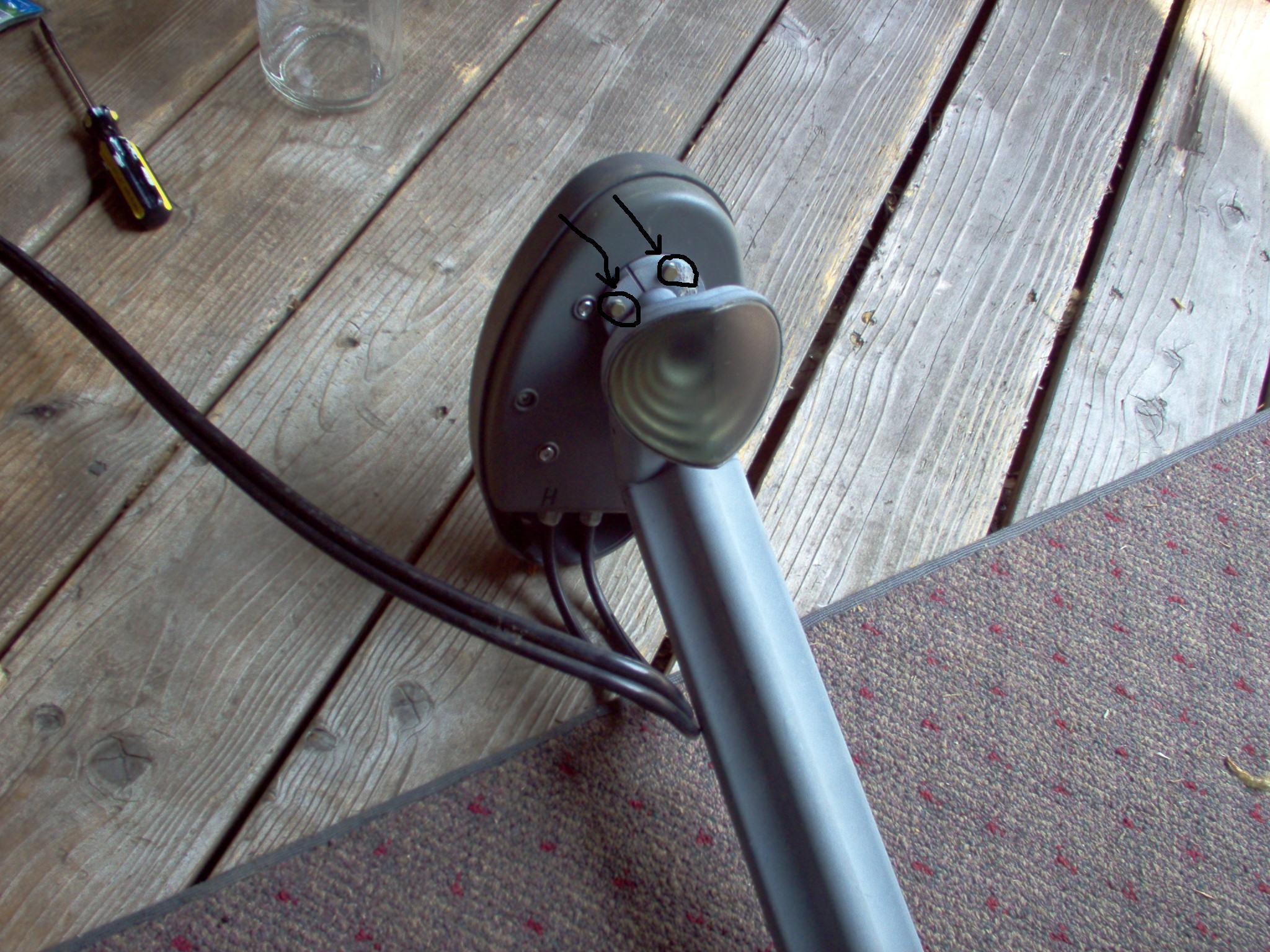

The skew is set on the LNB. There are 4 screws behind the eye...loosen those and then you can skew. The eye doesn't move, just the LNB part behind it :)
I circled them on your picture :)

Thanks Ice, Now I know what those are for. I thought the eye was supposed to move. Just have to find the right wrench for it. I don't think a nut driver could fit in there.
I'd like to rotate one of these 90 degrees to where the wide dimension was up and down and see if it made reception better where satellites are more closely spaced.
Harold
Those little bolts take a 7mm wrench.
I got mine at Lowes for 3 or 4 dollars. I like it because it is thin, fits perfectly, and you don't run the risk of over tightening that you have with a bigger wrench.
Fred
Having the narrow part of the dish oriented horizontally will result in less rejection (or more interference) from an adjacent satellite.
Harold
Sharpee that dish works great with a motor, and the best part is its free. When I first got mine I had it aimed at g10 lots of good stuff on there, just find the satellite first then adjust the skew, a small turn of the LNB does a lot.
Thanks Guys for the info on the skew adjust. Turns out I do have a 7mm wrench that I got at a local flee market. On the back of the dish there is no 84E only a pat number and a mold number. Must be an earlier model. I did however use the ol' tape measure and it is in fact 40x30. Currently I'm in the process of building a rooftop mount for it with some spare parts n stuff I have laying around. Wish I could put it in the garden but my wife doesn't think so! She spends much time diong a great job in the garden with lots of neat looking plants. But I think a Primestar dish next to the purple Iris would look beautiful!
