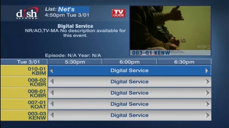

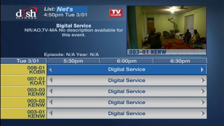

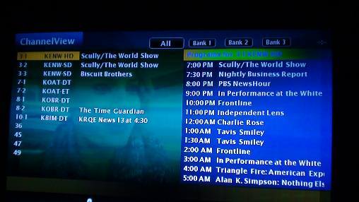

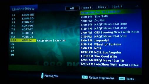

Tweaked my antenna (getting ready for LIN ;)) Dish screen shots vs Mitsubishi OTA (new tv)
